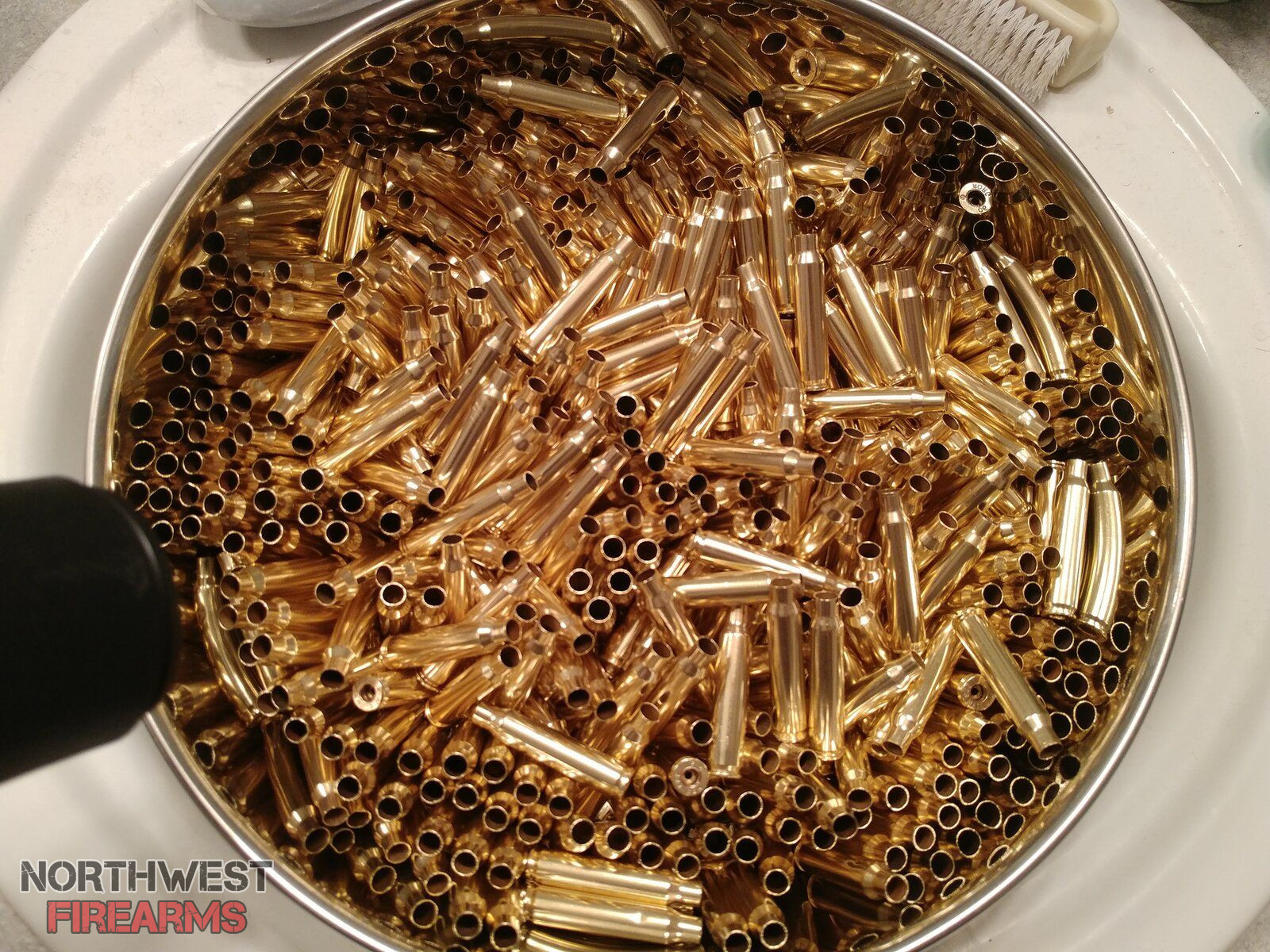

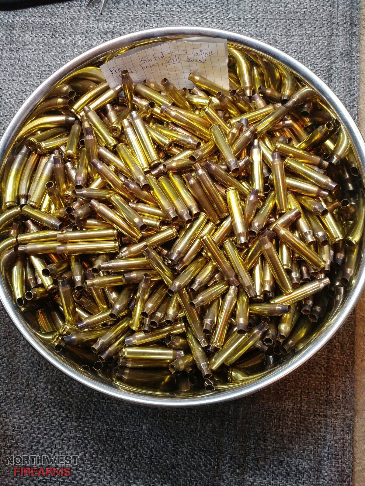

I went by what Erik Cortana demonstrates in his video. I turn the lights out when im working so i can see the flame better and basically just hit it long enough till the flame JUST starts to turn color and then its done. Some times JUST the case mouth turns orange just for a split second, but when finished they dont look any more discolored than factory annealed brass. Some you can hardly tell where annealed at all.
Before and after pics.
Thanks though fir the concern.
Id rather have them under cooked than over cooked!

Are you annealing with one of those fancy machines? Or just spinning them I a flame with the drill and reading color? Probably the latter seeing as you turn the light low to get a good read in the color of the heated brass.
I'm not at the annealing point yet. I've already witnessed first hand with hand gun cases the slight difference in feel between different head stamps.
You are correct. Good old (ye old) "yellowsmithing" with the lights out you can also see the metal color better. But the flame changes color before the metal does. Im cheap (and currently pretty broke) i annealed around 4k cases and it cost me like $6 in propane. I bought the nice remote torch brand new for $30 and could clamp the head in a vice nice and securely. So i don't have to worry about bumping the torch head. Took about 8-10 hours though at about 3.5 seconds each.
I ONLY annealed these because most of them are new to me basically range brass and theres some good stuff in there like black hills match brass and others. And with the future looking sorts unstable i want to treat these like gold. And make them last as long as possible. (I have for more brass than i need though.)
If it shoots under .25" i might have to make it a habit though. ;)
