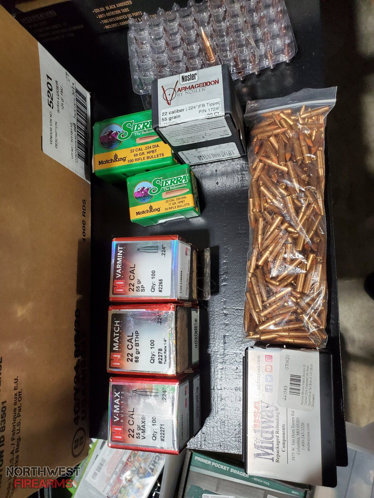

Haha, I'm sitting on about that many myself. Doing it in stages helps, I have about 2k deprimer 2k resized, and a few more primed or loaded.
Here's a sample of bullets I've tested (some just for fun if you recognize the paint lol)
The most consistent in my 16" CHF FN barreled AR is the basic:
Hornady .224 / 22 55 gr Full Metal Jacket-Boat Tail Bullets With Cannelure
I haven't built ladders to try my new 10.5" CHF FN barreled pistol, but I sighted her in on Tuesday with factory 55gr and was getting 1" groups at 50Y, without using my full rifle rest...
I read a ton of what was supposed to be best on a 16" with my twist rate, and maybe if I was shooting out to 300Y I could see a difference, but for 50-200, she luckily throws the 55gr Hornady the best
