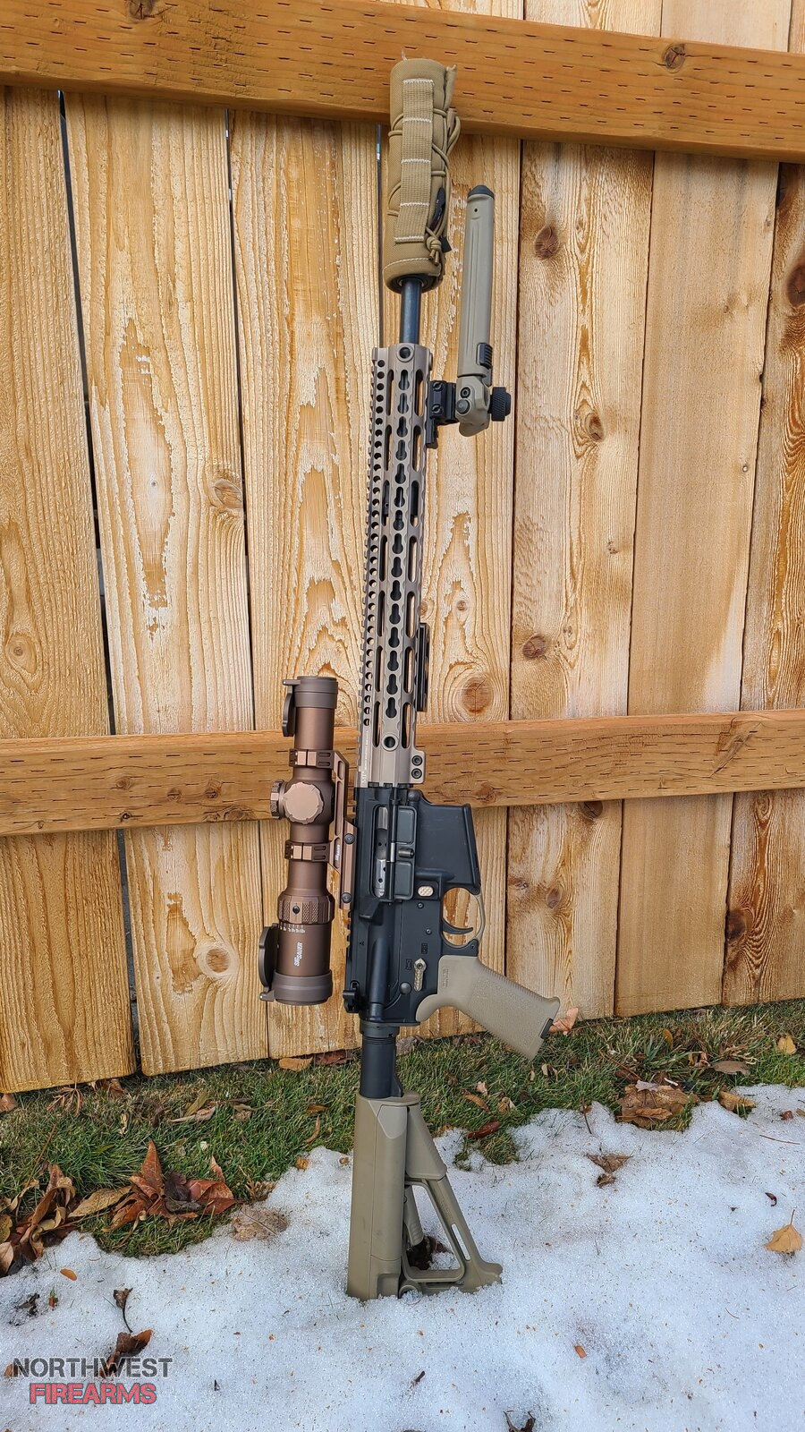

I ended up with and Odin Works 16.1" barrel, https://www.primaryarms.com/odin-wo...ength-barrel-with-adjustable-gas-block-16-1in with a Deadair Xeno brake.
I was debating between the PA 1-10 LPVO and the SwampFox. I ended up going with SF and it arrived today.
You can see how I mounted the bipod stud here, https://www.northwestfirearms.com/threads/drill-and-tap-rail-section.434693
I will get it bore sighted today and hopefully in the next day or two get a few rounds though it to adjust the gas block. Hopefully the week of Christmas I will have time to get it reasonably sighted in. We are expecting highs in the 20° this week, bbrrrr. I will be running the same 55gr Nosler ballistic tips that I run in my 24" Bushmaster Varminter.

Well I am no longer seeking since I finished the build about a month ago, post #27.
Also that is not what I seek as it does not fit anything I listed in my first post.
