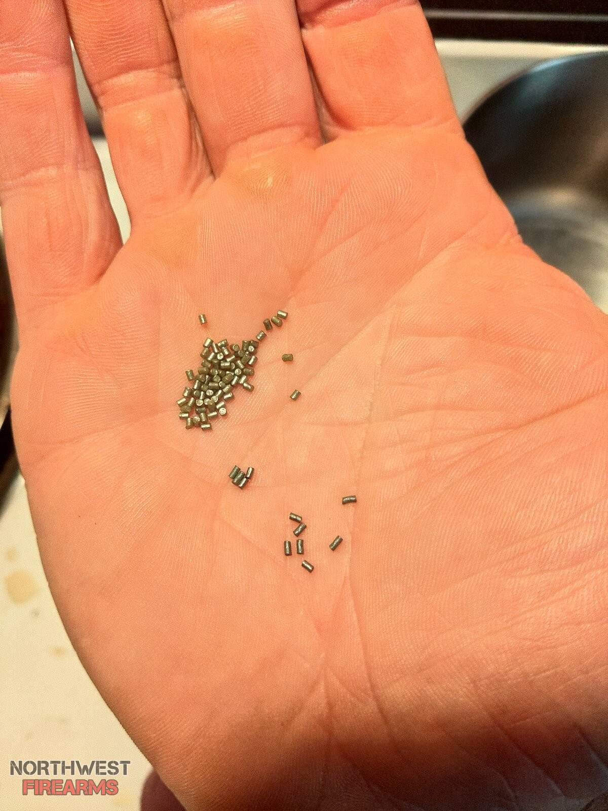

In the picture, the larger pile closer to my fingers is H4831sc and the smaller pile closer to my wrist is IMR4831
don't know if you can make out a color difference on my picture but it's there. Hope this helps

Thank you for showing that. After posting this I went out and took another look for H-4831 and I found this old jug. I do see the color difference, it is readily apparent in person.

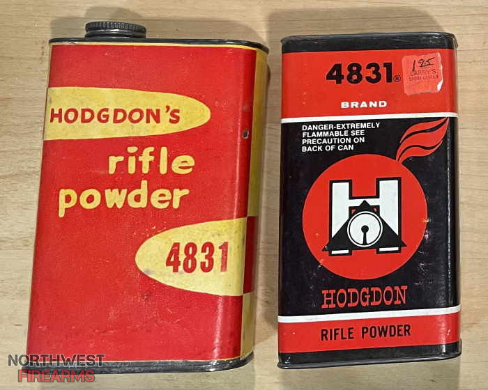

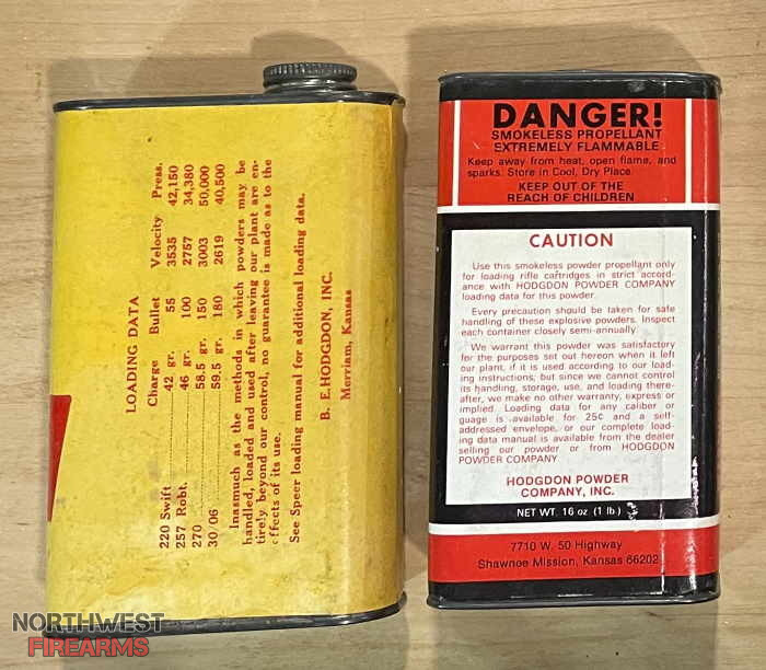

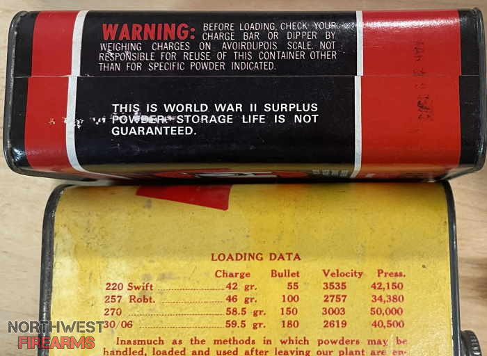

This was how Hodgdon got his start in the gunpowder business, buying rail cars full of WWII cannon powder and repackaging it for reloaders.
View attachment 1900421 View attachment 1900422 View attachment 1900423
I have heard those stories and this powder may well be some of that very old stuff. I will give each container a good inspection. This is suppose to be IMR4831 which would be different than the 20mm powder, I think.
