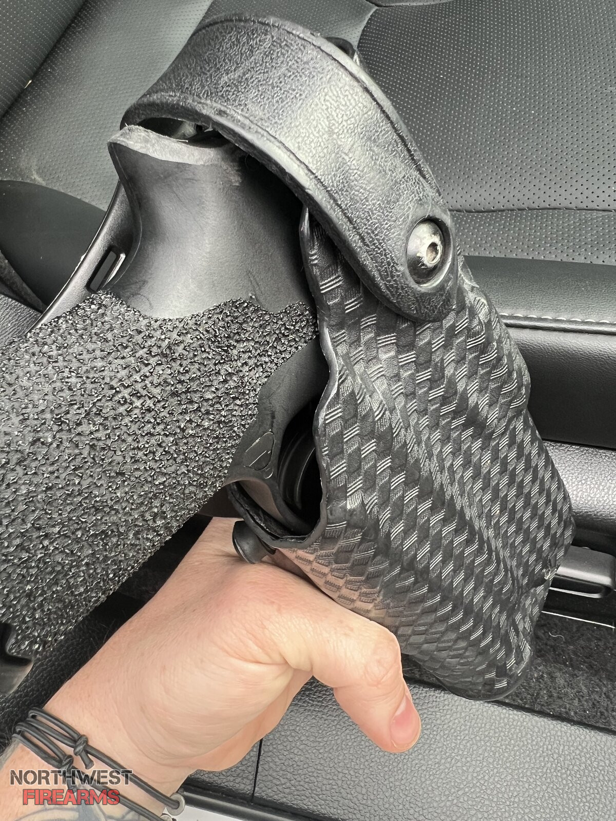

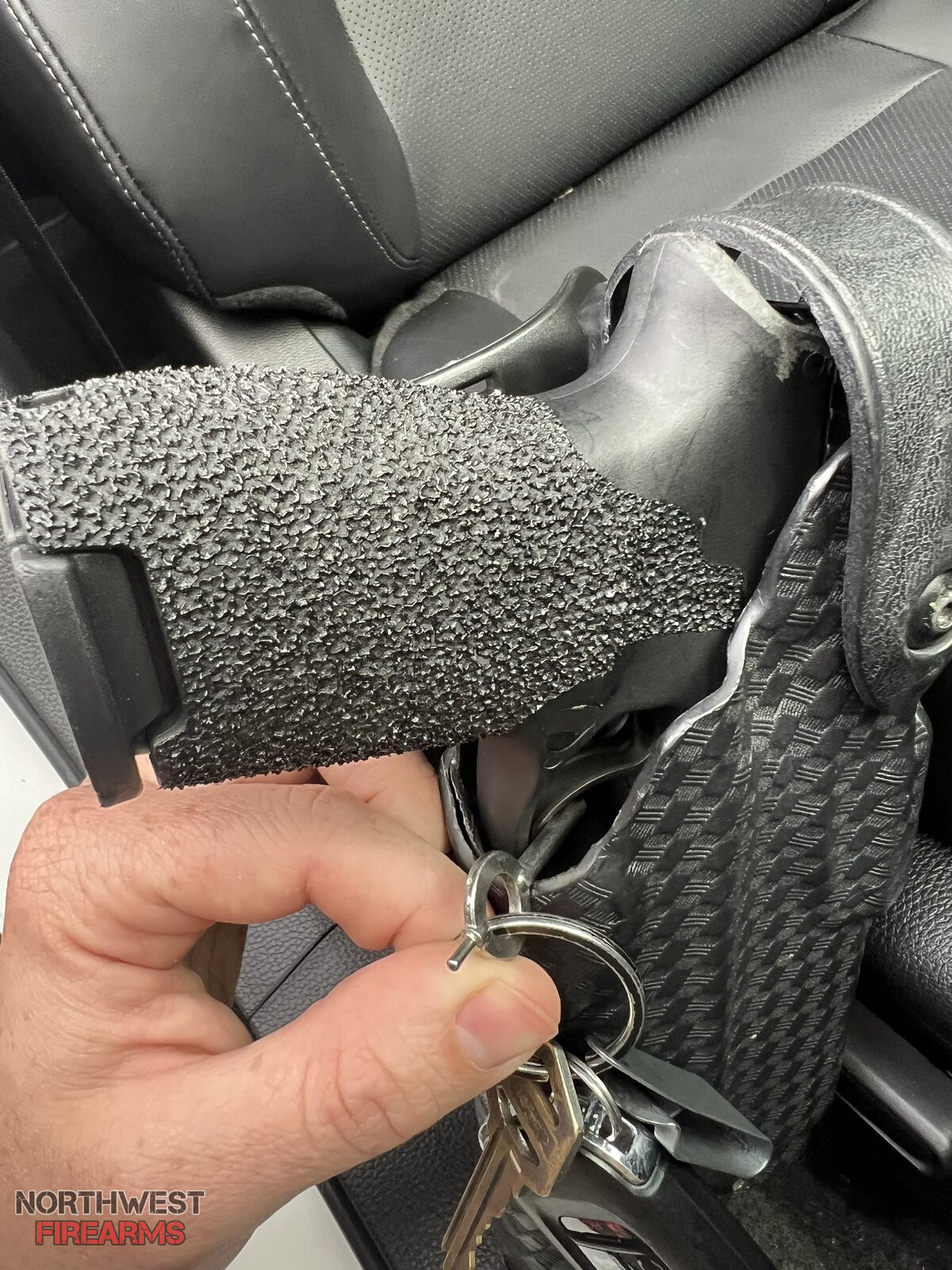

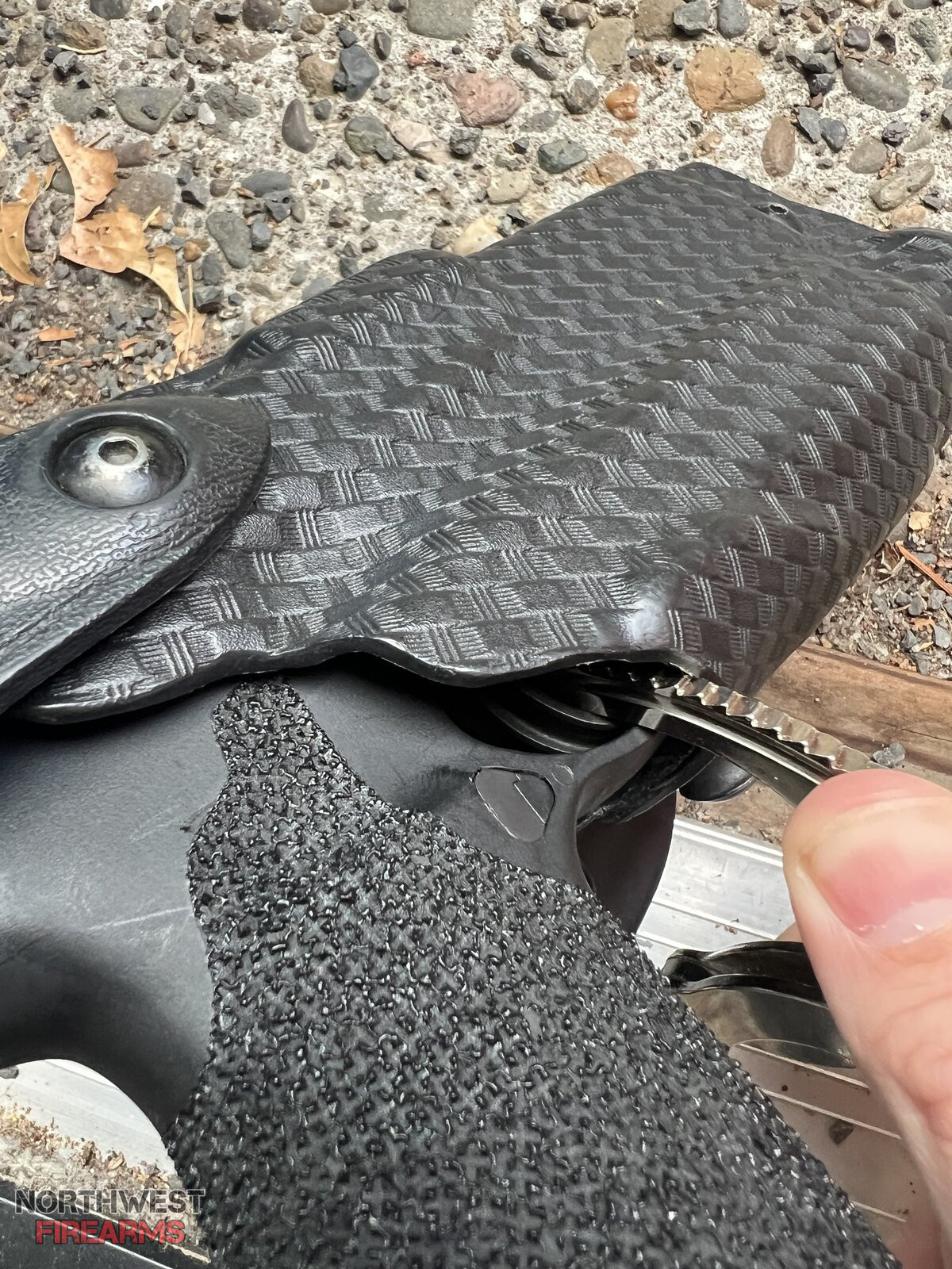

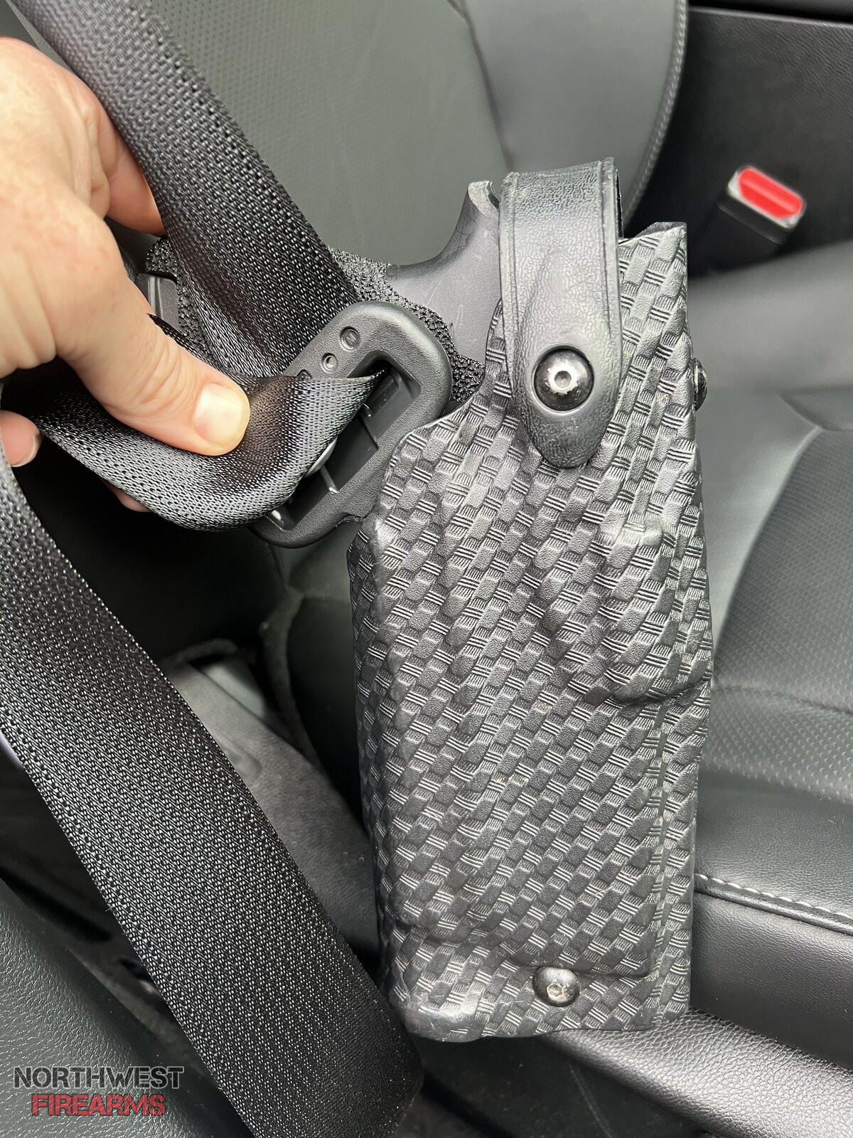

Just making a thread to say I was wrong. I didn't think what SIG was claiming was possible. So after having a P320 given to me for free I acquired a Streamlight TLR-1 and a 6000 series duty holster made by Safariland (the same one in the Montville Police video). Well with everything put together I can easily recreate every scenario caught on body cam. Whether it be a handcuff key, a seatbelt latch or the ratcheting portion of the handcuffs.
I now believe that the P320 isn't just going off in the holster. The trigger is being pressed by something. With that said I still stand by my opinion that the way the platform is set up I don't think it should be carried in a duty role, nor do I think it's a safe duty gun. Especially in a light bearing holster. The trigger is way too easy to access and manipulate. The travel is too short and the pull is too light.
For competitive shooting or a flat range I think it's fine. Where elements are completely controlled. I'd even say that it would be safe to EDC (WITHOUT a light) in a quality holster. But in a role where it will be going in and out of the holster and outside elements can easily make their way into the holster due to the demands of the job I think it's unsafe. I may change my mind if it had a manual safety or a tabbed trigger. I actually have a tabbed trigger on the way so I can do the same tests and see the difference. Because without the tabbed trigger or manual safety it is extremely easy to manipulate the trigger. In fact it's kind of alarming. I definitely wouldn't want that kind of access going hands on with people as a LEO.
This isn't a post about SIG as a company or how they've conducted themselves. I still have strong opinions on that. But I do want to clean the slate and say from what I can tell I am wrong about the P320 as a mechanical device. I don't think it's the right tool for the job but the gun itself is safe in my opinion.
I've been a troll with this entire situation. And I was wrong. @sobo @DirectDrive @Old Dog @WillametteWill this is me eating my words. Ya'll were right.

wow, the gap in the light bearing holster is huge. Appreciate the photos showing various obstructions that can get in there, that really puts the topic in perspective.

Well the wiggle test is nothing. Cause the trigger has to be pressed past the wall to get the striker to drop. This idea (that I believed) that the gun was going off without a trigger pull is false from what I have seen. I don't deal in absolutes so I'm not going to say it can never happen. But I don't think it's happening in these cases. Like I said above I think the gun in its mechanical form is safe and operates as intended. But I don't think it's the right tool for the job in regards to LE in its current set up.

If the safety is engaged the trigger manipulation would be mute from what I can tell. Because the manual safety would keep the trigger from being pressed. If the manual safety was not engaged the platform will have the same results as a standard P320.
