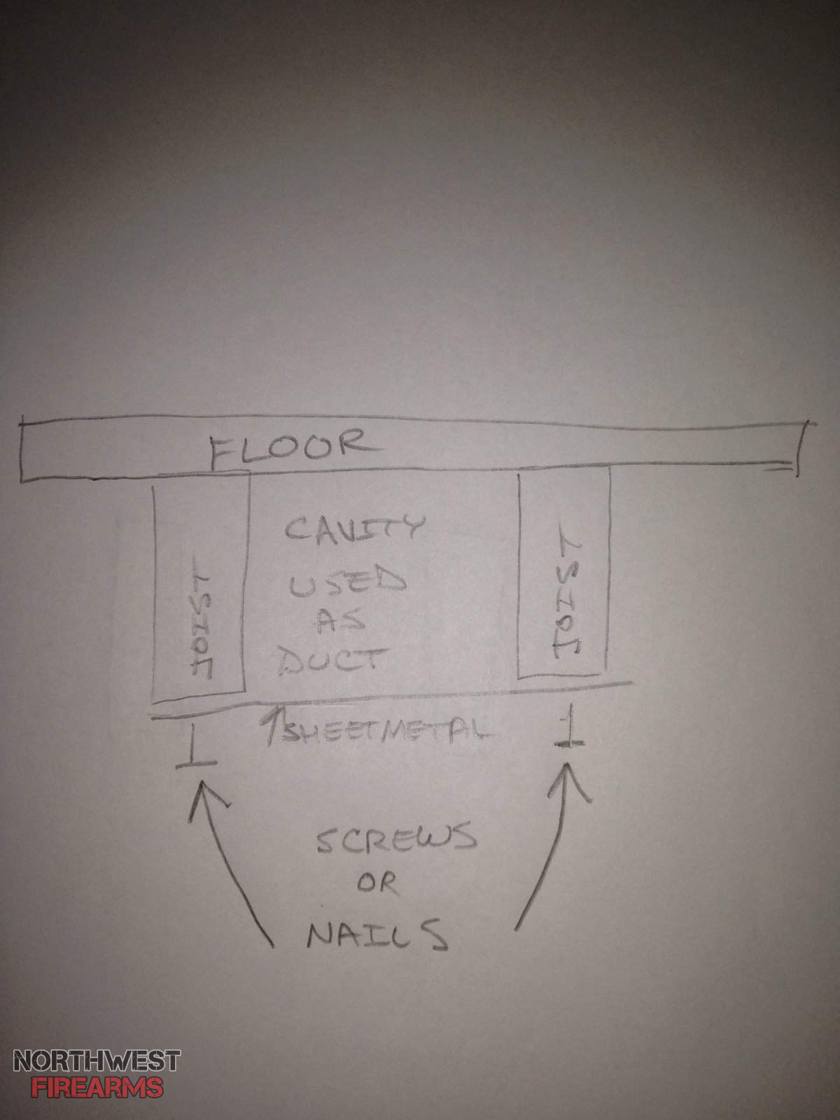

By "panning" are you referring to a plenum?
Panning is basically taking flat sheetmetal and affixing it to the bottom of joists across the open bottom of the spaces between joists forming a duct comprised of three sides being the building structure and one side the sheetmetal (aka panning) forming a cavity that can be used as a duct.
Here's a quick scribble of an end-view of what I'm talking about.
