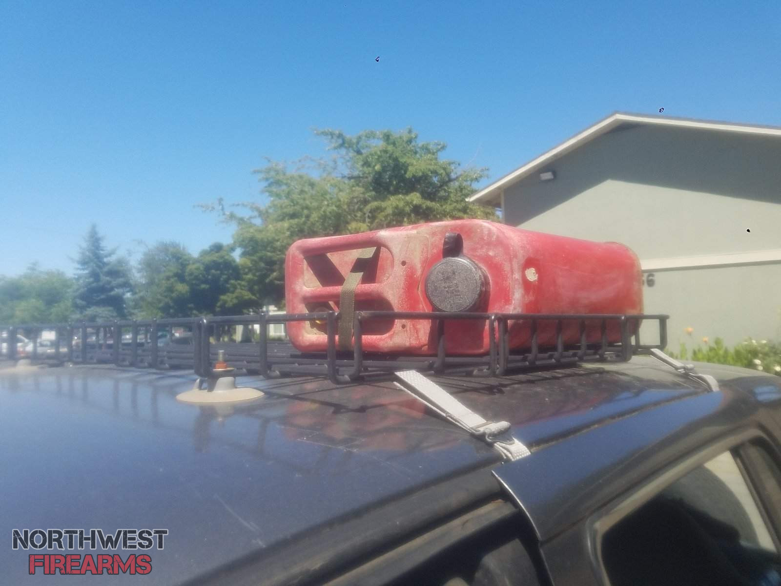

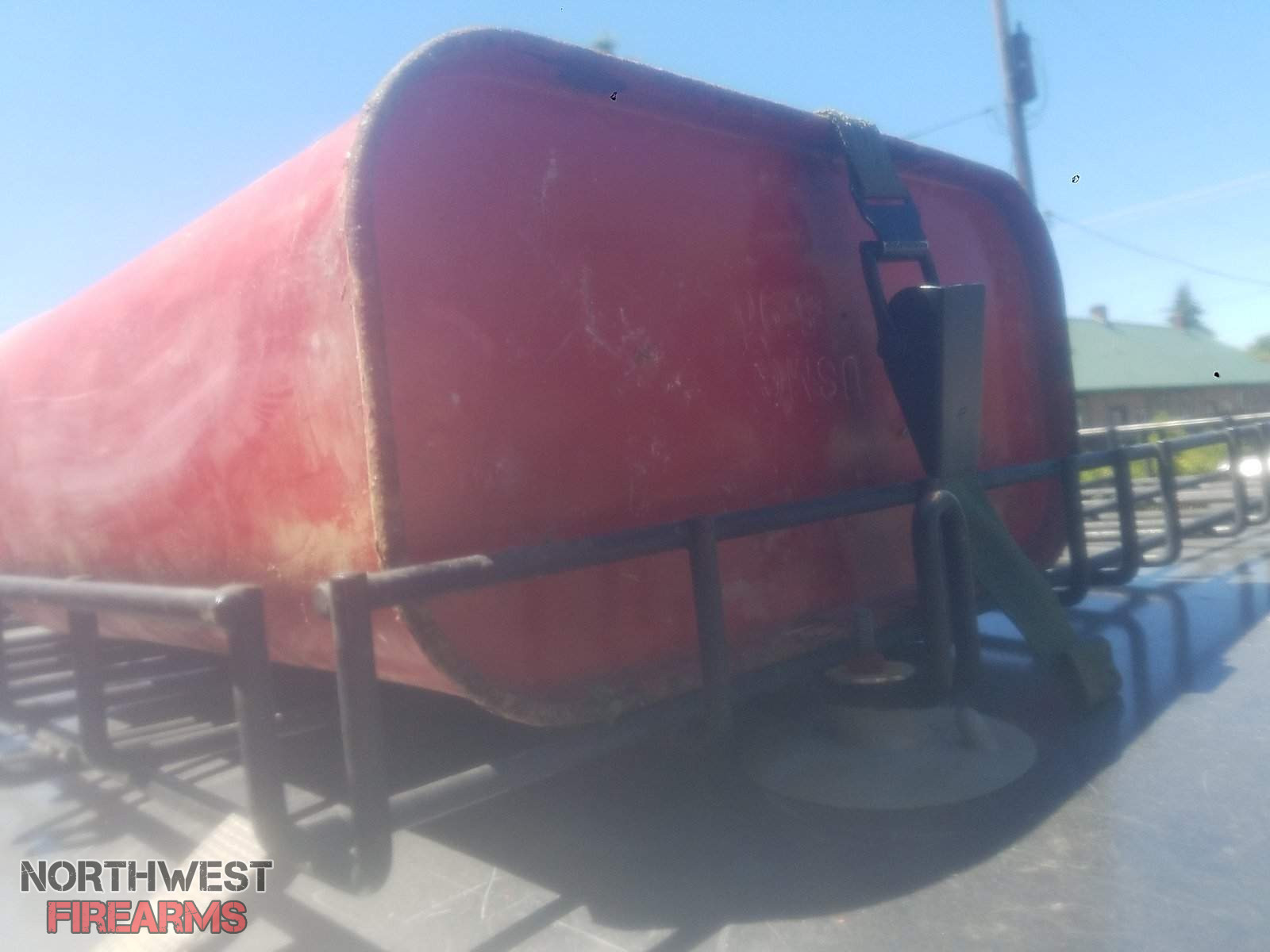

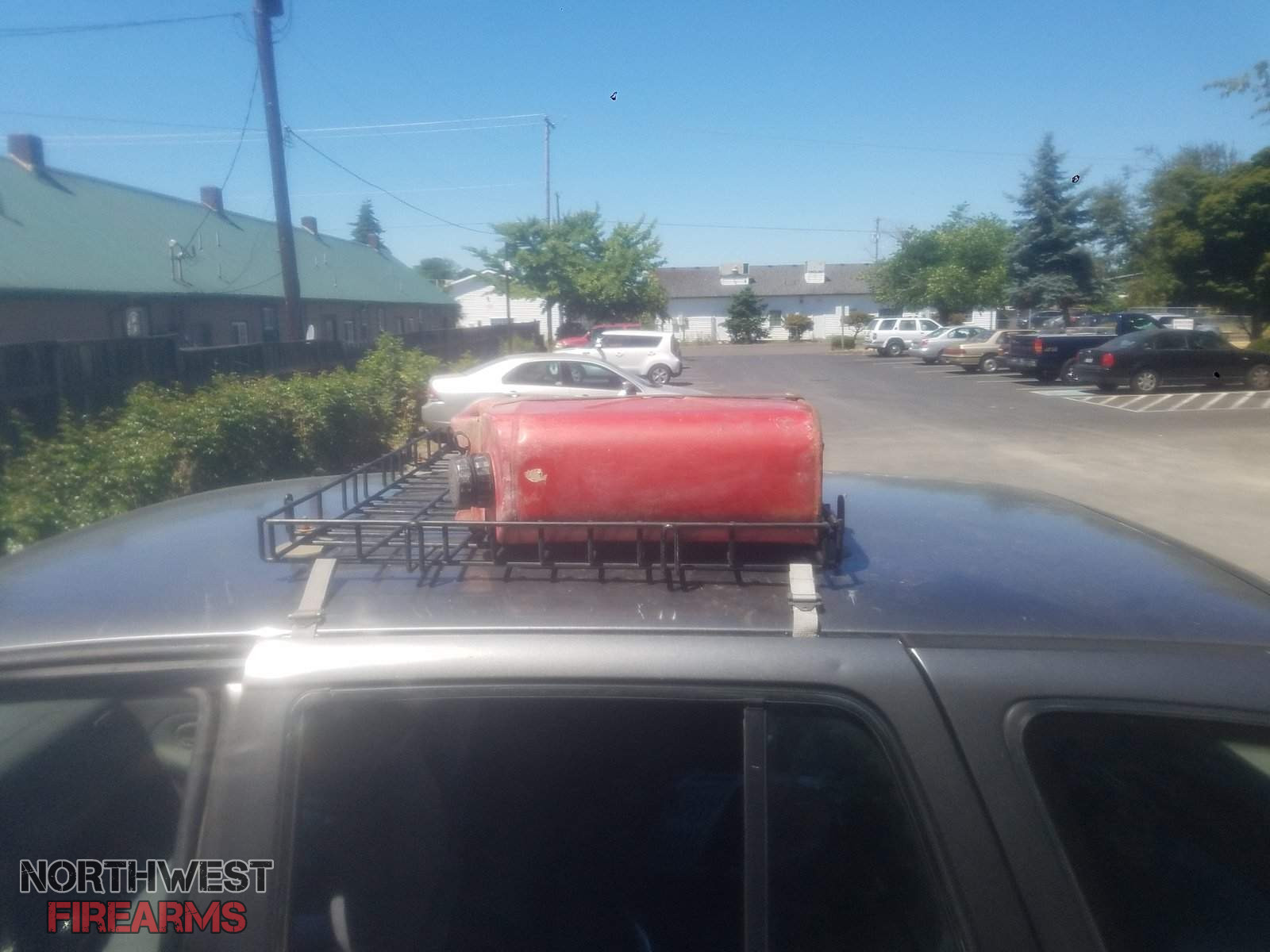

Blitz 5 gallon jerry can, may be dated 5-90 (1990), may be military(USMC) marked. Paid $5 for the can :D Mounted to kia's roof rack with USGI cargo strap 20180711_120357.jpg 20180711_120427.jpg 20180711_120452.jpg
Make sure the inner tube rubber does not react with the gas over time. Dissolves. Rubber particles might end up inside your fuel filters Gasoline is difficult to contain. It has a bad habit of expanding and contracting with wide temperature swings. The fumes under certain exact conditions can be very dangerous. BOOM!

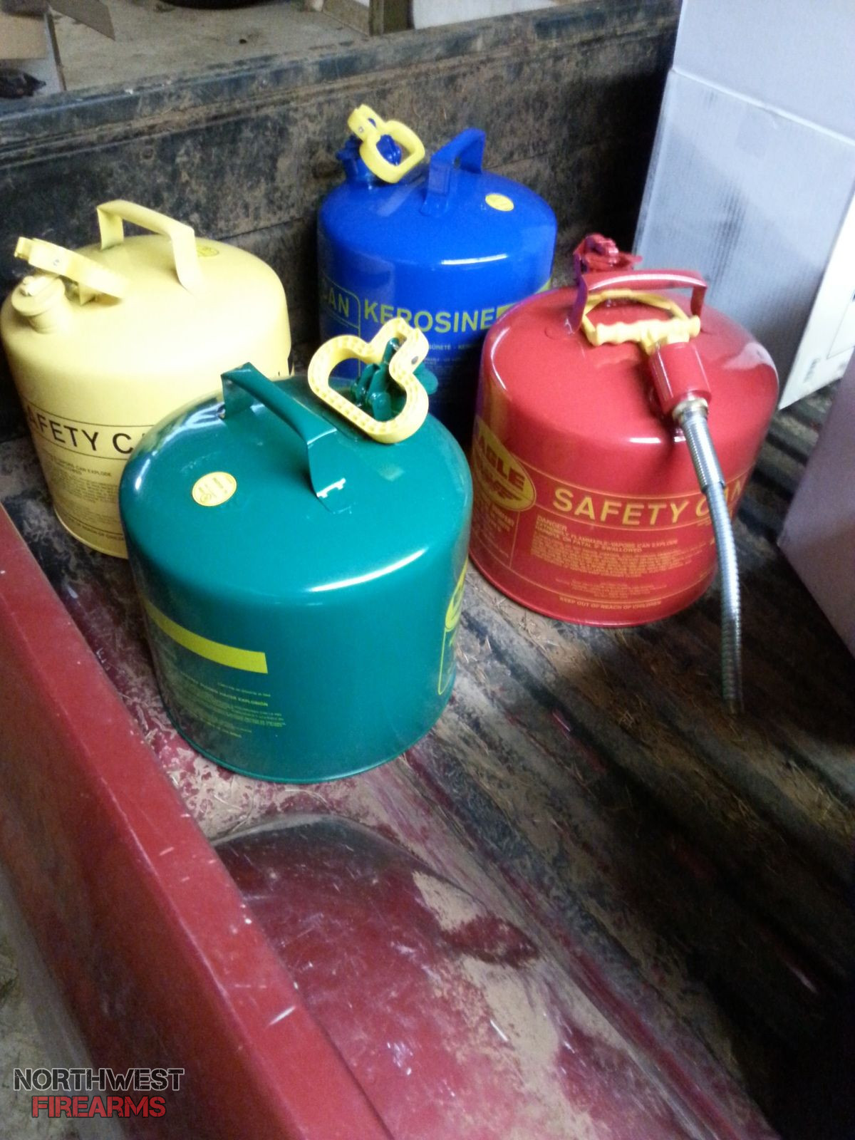

I recently replaced my old plastic cans with 3 Justrite safety cans made in the USA and couldn't be happier. It cost me about $160, but since I have nowhere but my garage to store them the quality safety cans are worth the peace of mind
Gasoline is one of the most volatile and dangerous things around the home. Carrying gasoline cans horizontally on a Suburu roof-rack, well, I guess you do what you have to do.
Those cans were never intended to be stored or transported on their sides, only upright. Gasoline has a way of finding the very smallest breach and will get out. Oh, and common rubber like from an inner tube will deteriorate over time. Typically it will swell and lose the seal. Don't ask how I know about it; McGyver didn't think of this one.

Please for the love of all things beautiful, ban those new safety cans. I have a couple modified units for mowers and chainsaws, but I purchased a new "hold the spring loaded valve down while you pour" cans and ended up with petrol up to my elbow. Effing STUPID regs!!
