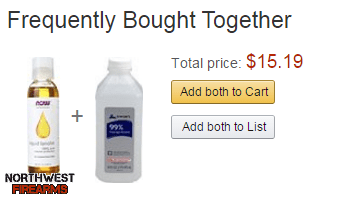

Pure Lanolin from Amazon.com: ($6.99 each when I ordered two bottles with free prime shipping)
http://www.amazon.com/Now-Foods-Liq...e=UTF8&qid=1451764727&sr=8-4&keywords=lanolin

I then purchased 92% alcohol from BiMart and a 16oz spray bottle from there as well.
The way I figure, I have 16oz of lube that has cost me $4-ish vs $10 for 5oz of OneShot.

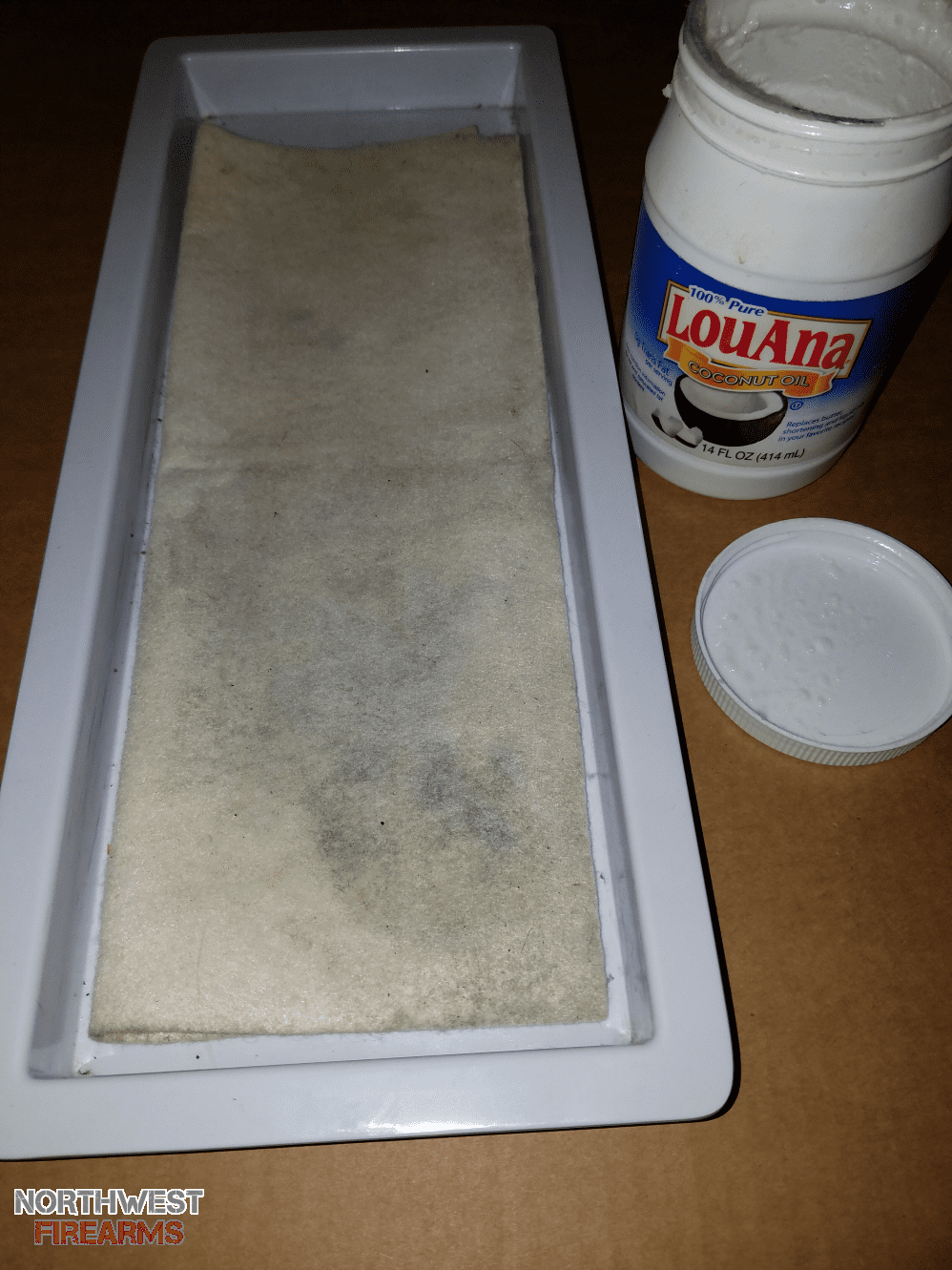

When I first responded to this, I used my lanolin mix. This spring/summer (2017), on a lark, I started using coconut oil and alcohol.
99% isopropyl alcohol from Freds, LouAna Coconut oil from Winco. Total cost, ~$7.
I thought I was using the organic stuff, so to be "hip" with antifa. Guess not.
With what you see in the picture, I've done ~1K 223, 500 6.8 SPC, 300 7mm LRM, 200 338 Edge, & 200 7mm-08.
To make:
IF it's solid, warm a jar of coconut oil (~90°F), mix 3:1, coconut oil to alcohol. Too much alcohol is no prob, it just evaporates on hot days.
Over time, it separates out. I just stir it a little before every use. Stays a liquid down into the 50's, a paste below that. I haven't had it go solid on me yet.
When I take time to use it, I take +/- 1 teaspoon full, spread it on the craft felt shown in the picture, then rub it in.
Lay a dozen or two case on the felt, roll one revolution, then load. Don't add any more until I feel cases start to bind in the press. I've never "saturated" the felt.
Applies a very thin coating, doesn't gum up or stink like the lanolin, nor discolors the brass.
Wipes off very easily.
