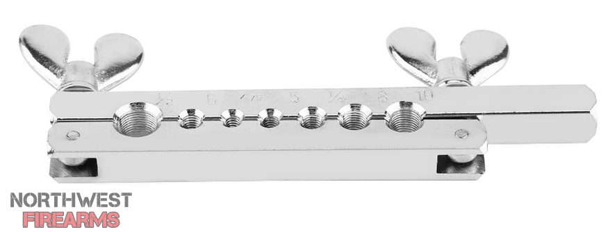

Fine 'knurling' in the openings of the 'Grip-N-Pull' device would eliminate the slipping bullet problems.

I modified some old pliers with a end mill bit.

I have these, and to be honest, they're difficult to work with. They require a tremendous amount of grip strength to hold onto the bullet, and there's no way to use both hands to grip with because your free hand needs to lower the ram. I regret buying them.
That design seems to be based on a flaring clamp, but with a hinge. Which is what I use, but without the hinge. A little less convenient having to twist the wingnuts, but this is such a rare event that doesn't much matter. Besides, the flaring clamp was only something like $5 to $7 bucks or so at the auto store and actually works quite well without much if any surface scratching of the bullet.
