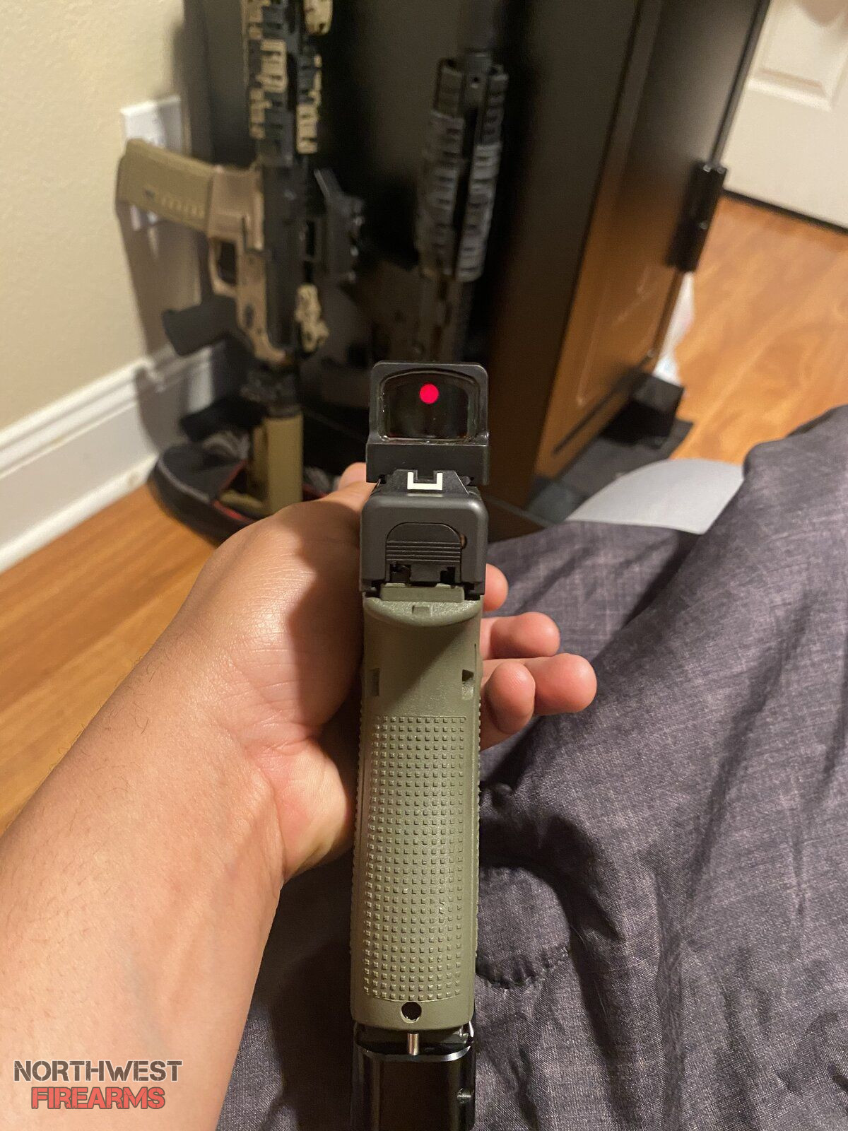

Kinda just wanted to show off my child lol.
Parts I have on her as of now:
Silencer co Threaded barrel
Glock brand extended slide release
Terran tactical plus 4
Holosun 509t
Thinking about putting a after market trigger but since she's a duty gun idk if that's such a good idea.
C424366C-935B-46CA-BE42-788C5643CB16.jpeg AED40C8C-5BD2-4BDC-9A88-A68AC602BFDE.jpeg 916CA59A-B374-4DBC-9046-E6C66A20ED1B.jpeg

My homebody Brendan did it for me for $100 and yes he did refinish! Wait period was a day because he lives down the road and the shop is like 15 away

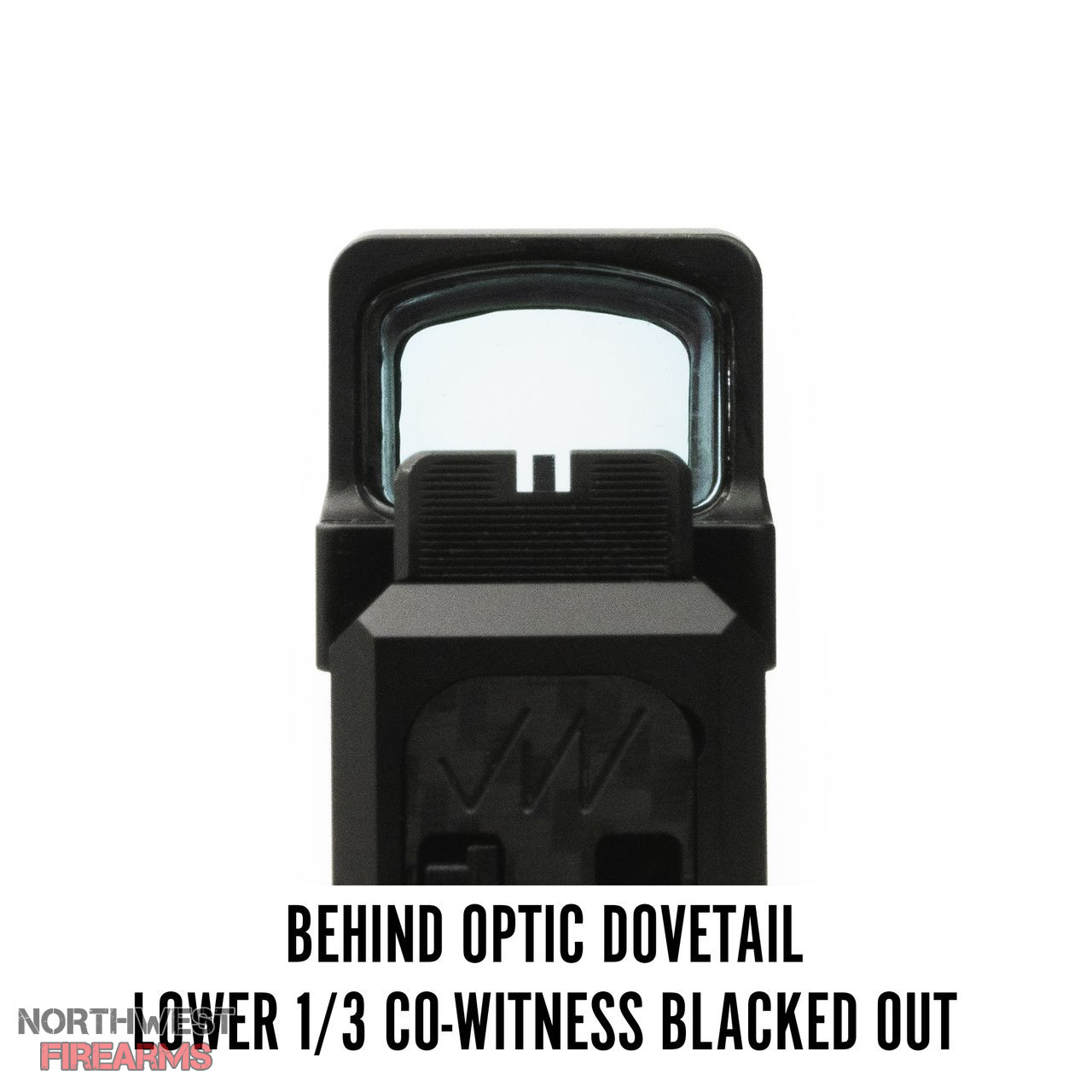

That cut seems shallow to me, I'd want the red dot lower and the sights taller.
Like this...
This ^^^
It looks like he just barely milled a flat on the slide.
Not the standard depth.
Maybe he's not comfortable cutting deeper and rightfully so.
You need to know where to stop so you don't cut too deep and hit some internals.
The "regulars" (Jagerwerks, ATEi, Maple Leaf, Primary Machine) have this mapped out.
Most want the optic sitting lower coupled with "suppressor height" sights to give you a 1/3 co-witness.
It looks like right now you are riding solely on your optic.
If it goes down on a duty gun.....not good.

Yeah we just designed the cad and our first run we destroyed the slide. Replacing a Gen 4 21 slide is like finding a leprechaun so much so we had to buy a whole G21 just for the slide 😂. Just bought another slide to cut a tad deeper
If you have the smaller slides perfect, I would assume the large frames would be able to be cut at least as deeply.
Different widths and thicknesses brother and it's crucial when your measurements are in thousandths the code is being cracked don't worry 😂. Just got the shop done too so this Glock slide milling has been a side project
Yeah...... They are different. You're right. Good luck cracking the code. It's doable with calipers and a scratch pad

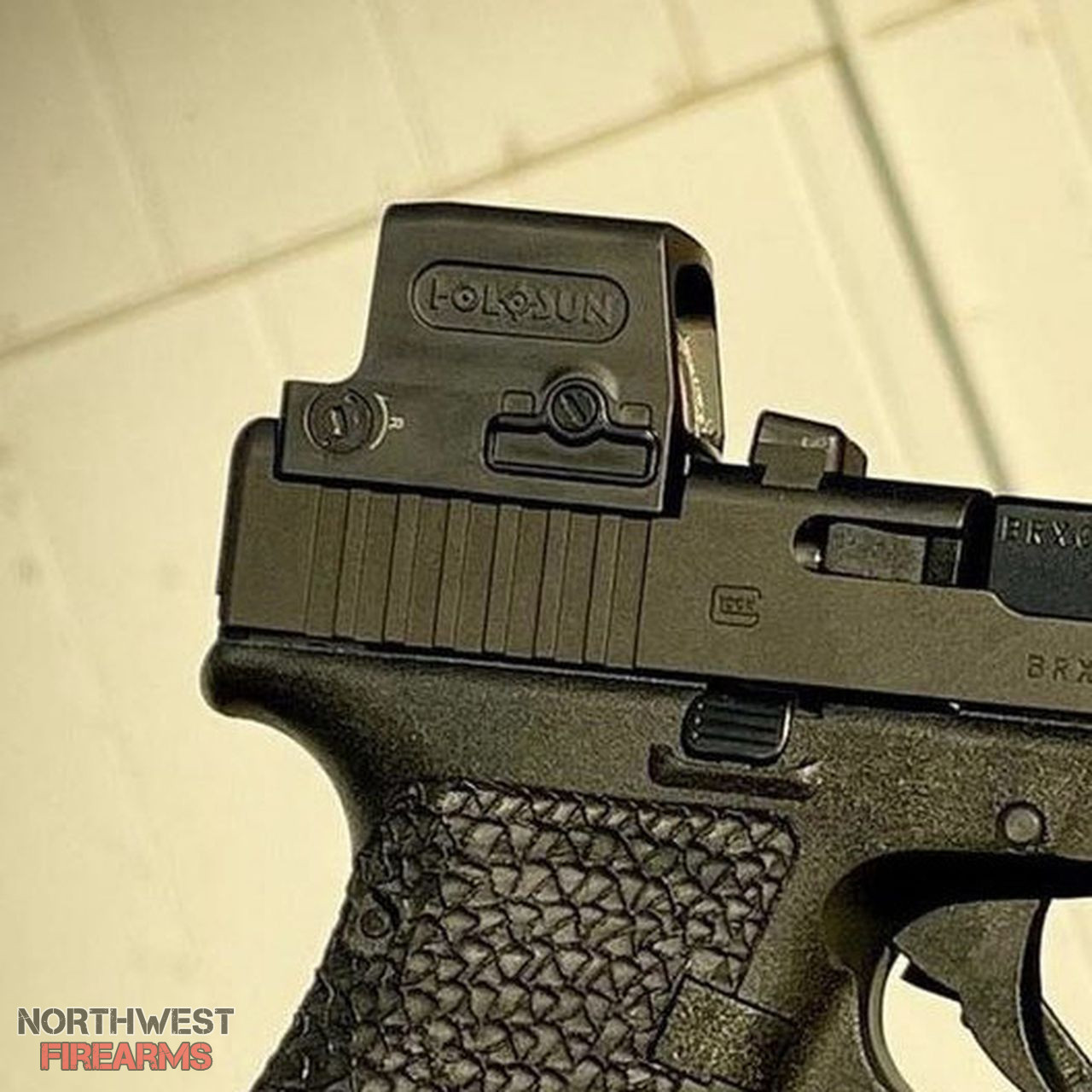

I believe it's the vertical safety plunger bore and the horizontal spring loaded bearing bore (for extractor) that you have to watch out for when milling for optics.
The two "danger zones" can be seen here...
We got the 17 and 19 slide science down to aT but not much out there for the large frame offerings so we had to create the math
