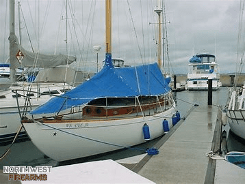

I've had several boats over the years, most kept full-time in the water in San Diego . Sail covers, biminis and full deck/cabin covers. All lasted for many years without leaks or rips. The fabric out lasted the stitching, so I had them re-sewn every 3 years. The sun and salt can be really hard on things in southern marine environment and Sunbrella fabrics really hold-up well.... not saying it's cheap....just good. Stitch with cotton wound polyester thread to maintain water-tight seams, wash often and spray with a week bleach solution to prevent mildew. For longevity use medium to light colors (avoid dark colors and reds if you can). I would think for covering stuff that can chafe, padding with an old canvas tarp would go along way to prevent pre-mature wear (as would keeping the cover tight at all times).
View attachment 992972View attachment 992973
Sunbrella ?
