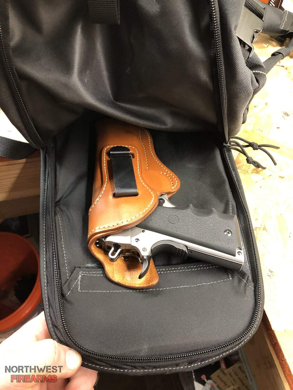

The hydration pouch in the back is damn near ideal to have a pistol mounted inside of it. I always have my bag with me when I'm at work or at school and I'm considering having some sort of attachment point to secure either a Kydex holster or some sort of webbing to slip an IWB holster into.
The hydration pouch unzips easily and the shoulder straps fold forward to make entry into that pouch, well, easy.
I'm not too concerned with 'off body' in these two situations because the bag is literally at my side during all events throughout the day.
There is enough room inside of the 24 pack that I can store a Ruger Charger with brace, suppressor on end of barrel and a 110 round GSG drum in it with plenty of room to spare.
Any suggestions on places local that can handle such a task?
The issue here is the body side of the hydration pouch has a hard plastic liner that keeps the bag in its shape, so anyone modifying this would have to have a good strong needle in their machine... or ya best do leather.

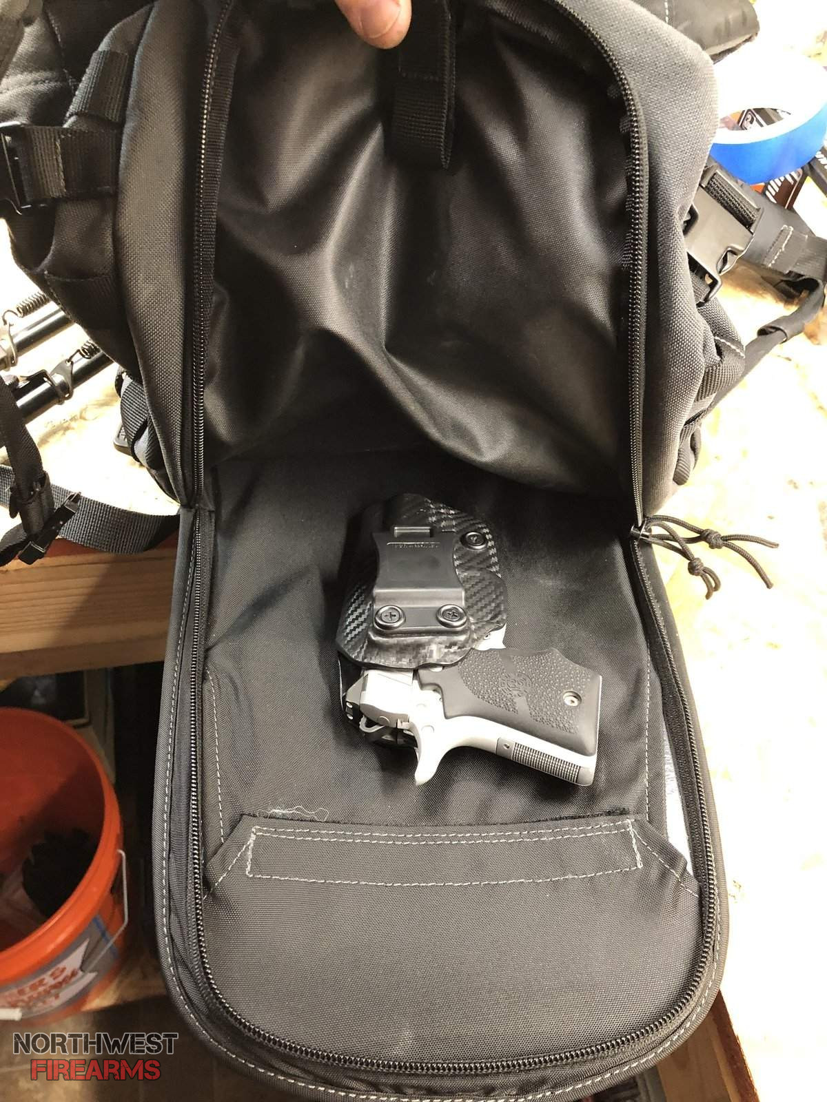

Chicago Screws. Get yourself a kydex holster (or three) that you are never going to attach to a belt, then some of these Chicago Screws, melt the fabric, drill 4 holes that can line up with existing holes on the holster, then use Chicago Screws to bolt the two together. My machine wouldn't be able to sew through pack frame sheets, so Chicago Screws probably your best option.

What I did with my EDC backpack was get large sheet of thick kydex, cut it so that it would fit in the main pocket of my pack like an insert, then drilled holes in it and mounted a home-brew kydex holster, two mag pouches, and a few little misc pouches onto it. I secured the panel to the inner "face" of the pack by poking some holes through the backpack, drilling some mounting holes on the kydex panel and then zip-tied them together.
From what I've seen online they've started making Molle backpack panels now, which would probably be a little less ghetto, but functionally the same.

There one “is” but the way it is made and Velcro over the top etc, I wouldn’t trust myself to remove it and get it back in there without damage.
Stitching to the fabric its self wouldn’t be durable enough for my liking. So, your genius has given me the real viable solution.
Kydex. Flat back (close to as possible). Chicago screws through the eyelets on the side of holster.
Easy to change out different holsters with preset hole dimensions. Ability to raise or lower holster a little for weight distribution.

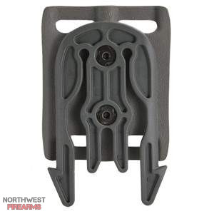

Did they not line that pouch with soft loop? Because you can't be the first person who has wanted to do this.
But take a look at something in the G Code RTI family. Something like this might work...
RTI Vehicle Mounting System
That piece can either be mounted to a sticky velcro backer or it could be sewn directly onto the available fabric. It probably wouldn't need to be sewn through the plastic backer but it could or it could certainly be reinforced with the Chicago screws or some type of rivet.
This would allow you to use any of the G Code RTI compatible holsters or Safariland holsters as they are all compatible with G Code if you buy the right adapter. There may be some other holster makers too...like TRex Arms is compatible with both Safariland and GCode.
