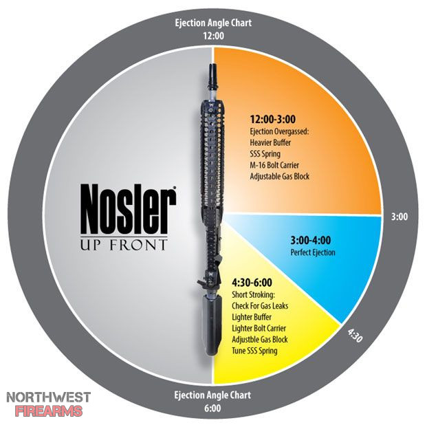

It does lock back and ejects a good distance.
Then it shouldn't be a gas issue.
My money is on the BCG and/or that buffer assembly or worse case out of spec chamber. I, too, would recommend sticking standard buffer system. Everything should be able to run an H buffer with half way decent ammo. I also would recommend using quailty factory ammo, no reloads, for doing diagnostics.
This helped me fix mine.
