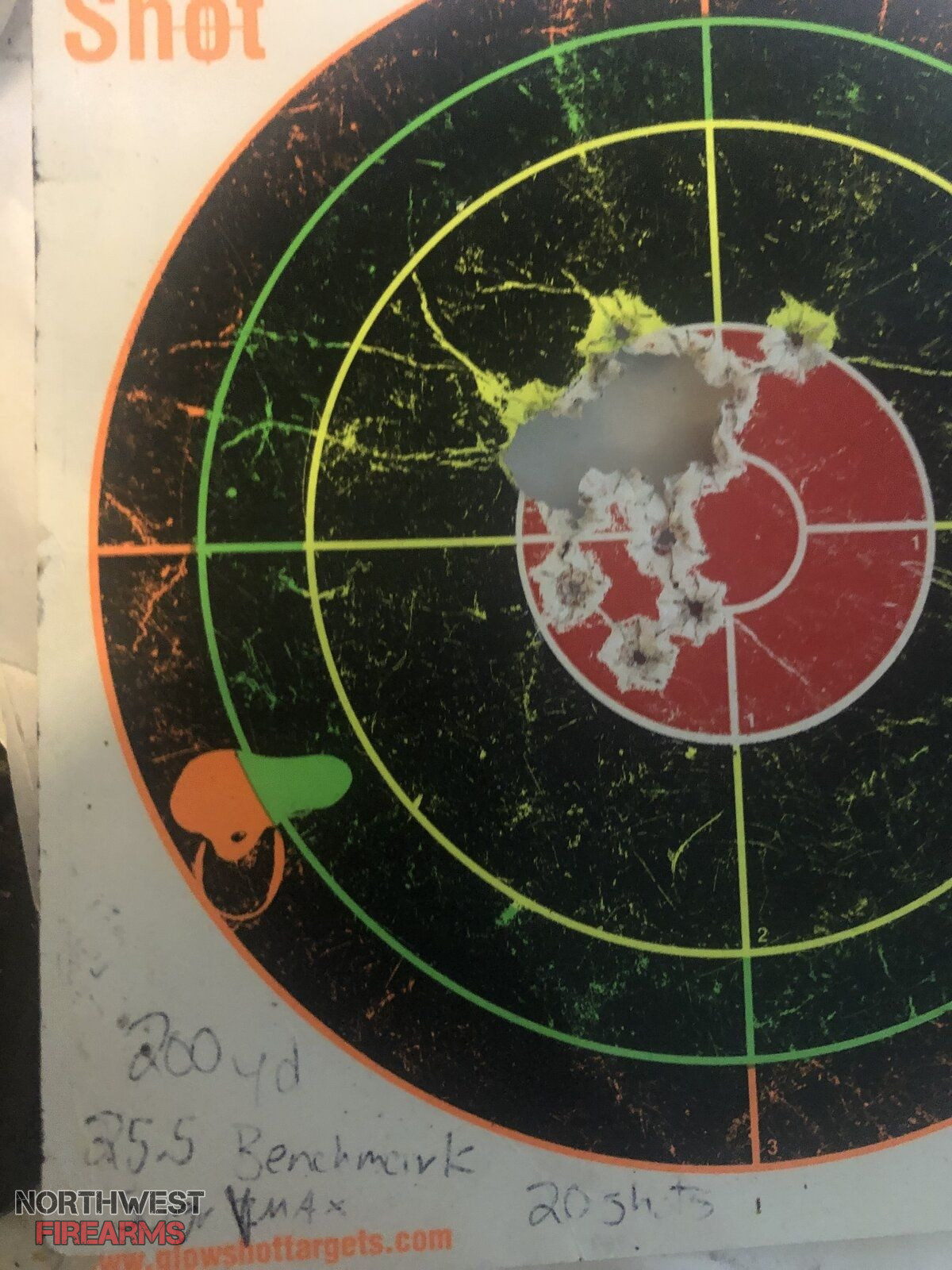

I don't know the answer, but I discovered that the flat based 50 gr VMAX and Varmageddon shoot lights out in .223/5.56 out to 300 yards, compared to any boat tail I've tried yet. 60 gr VMAX is almost as good for me.
Yep, I discovered it…and then later read that was a known thing.
Here's one I kept for awhile, 20 shots at 200 yds, 50 gr VMAX thru an 18" AR.
