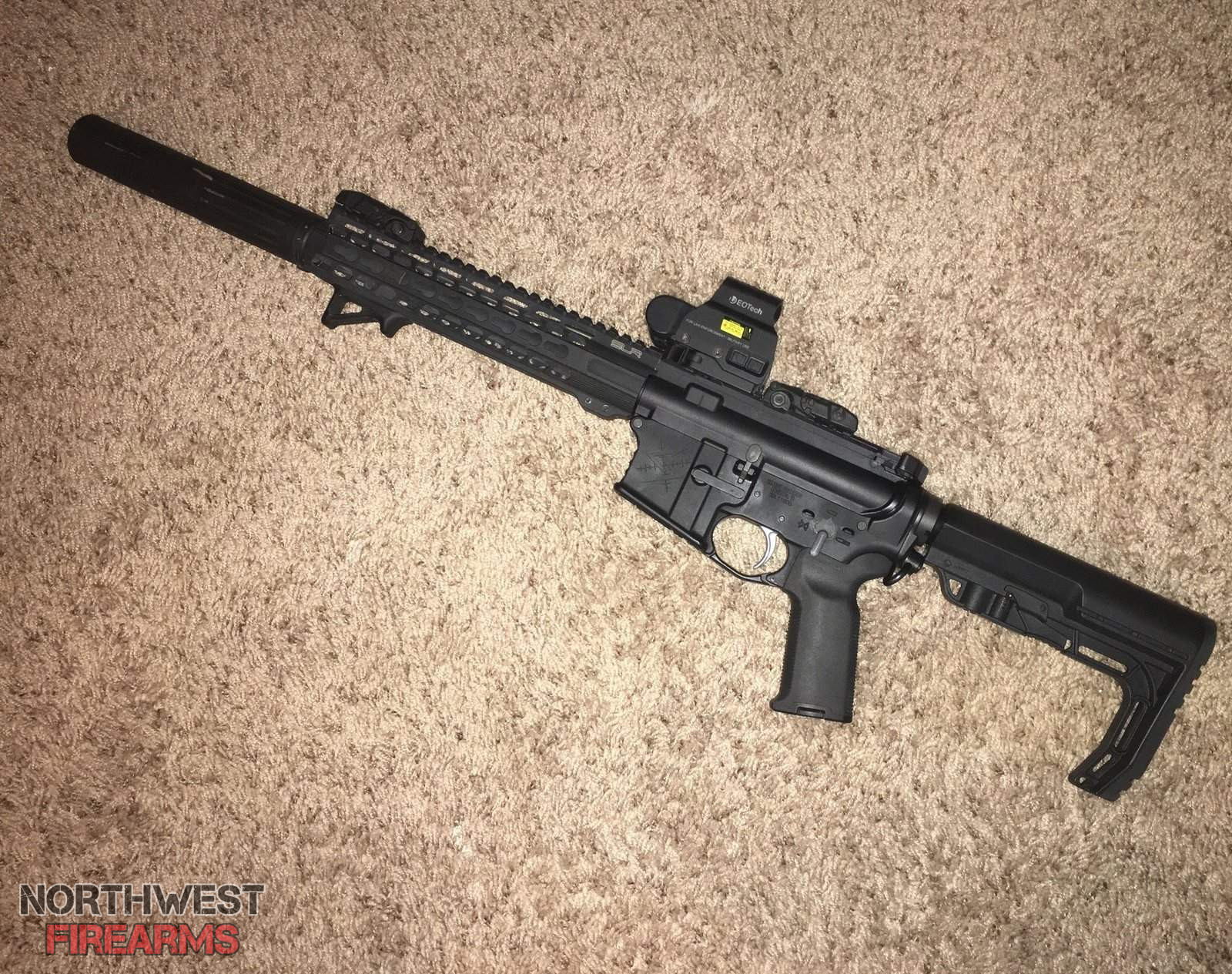

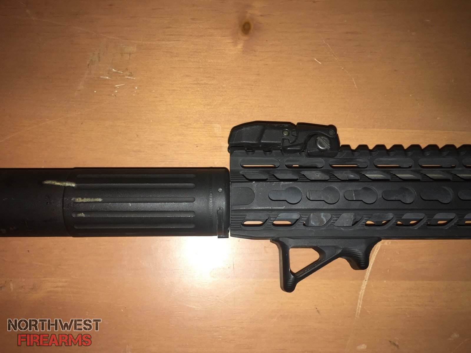

Here my 10.5" SBR with an SLR rail and SDN6. There's maybe 1/32nd between the rail and can. Even then if I'm doing a lot of shooting or taking a high round count class, the rail warms up quite a bit. 2F2B29E3-0807-4CCD-9D86-0505A24DFB06.jpeg D9ACF6B8-ABB0-4C4D-8215-00F8E0227306.jpeg

Here my 10.5" SBR with an SLR rail and SDN6. There's maybe 1/32nd between the rail and can. Even then if I'm doing a lot of shooting or taking a high round count class, the rail warms up quite a bit. View attachment 407441 View attachment 407440
That's EXACTLY the fit I'm going for. How long is the rail? I'm actually thinking of keeping my 9"rail and ordering a 10.5" barrel. I can pick up a ballistic advantage barrel for under $130 right now on black Friday special. I like the idea of having 9" of rail anyways whereas 7" seems a little short for grabbing.
