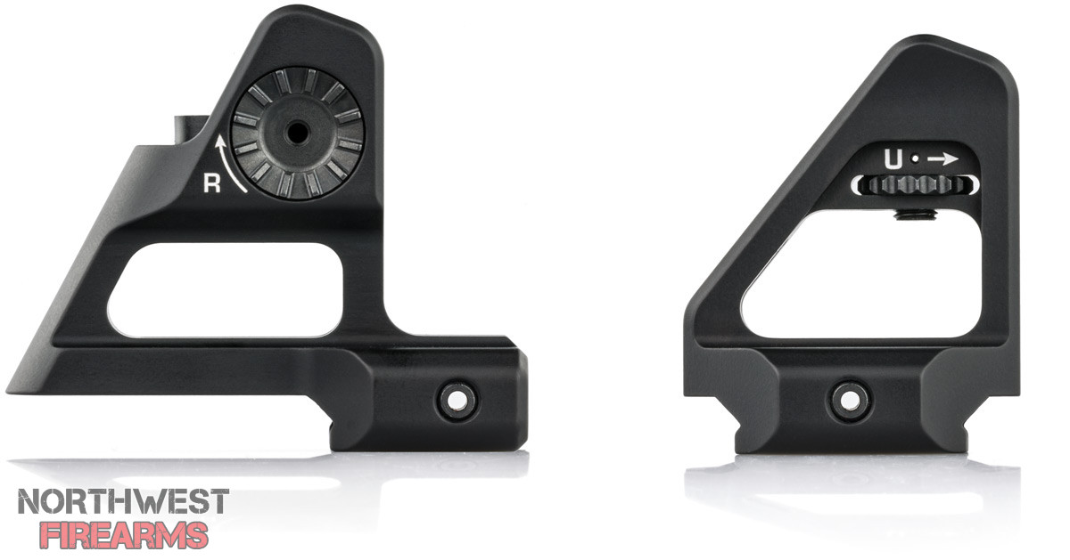

Love their stuff, installed on a AR-10 with ACOG, perfect co-witness, and rock solid adjustments that track exactly with the optic, making return to zero a snap! Now, they need to do a low pro version for shotguns and other rifle types, even bolt actions would really rock with these!
Best irons on the market.

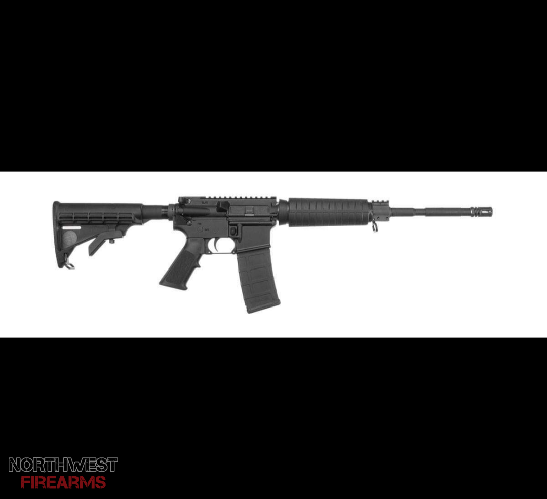

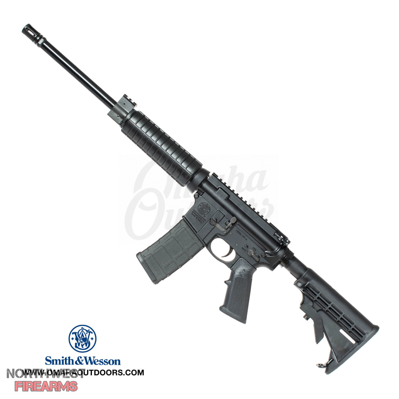

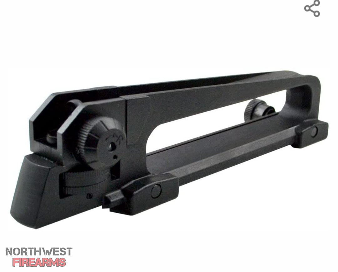

This gun , this rear carry handle, and front sit will be rail mounted. So high or low? I'm assuming low profile? Gun not here it's still in i1639 jail, , 8 more days 🙄
Without you stating the make/model of the rifle, I can only go by the picture you posted. It appears to be a "low" railed gas block, meaning the front sight would have to be a "high". Some sights previously mentioned would not work. Here is a picture of a rifle with a "high", or receiver height, railed gas block:

Normal AR sights are 1.42" +/- to the center of the rear aperture, with the front sight matching that. Exceptions include front sights specific for some railed gas blocks. Some HK's and Sigs will usually have lower ones. Which rifle do you have?

OK I can see these and looks to me like that is a low rail, in which case you would need a sight of this height...
https://www.midwestindustriesinc.com/Flip-Up-Front-Sight-Gas-Block-Mount-Model-p/mctar-ffg-blk.htm
rather than one of this height...
https://www.midwestindustriesinc.com/Flip-Up-Front-Sight-Handguard-Rail-Model-p/mctar-ffr-blk.htm
