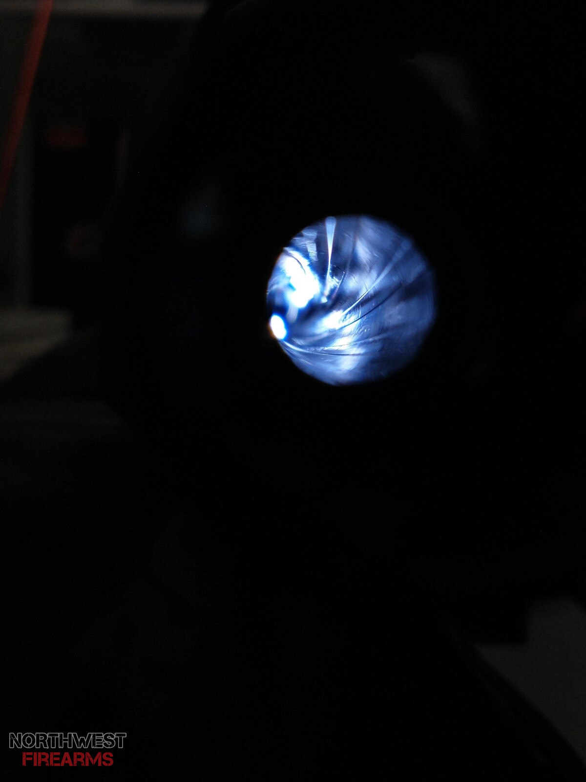

The picture above is about 3" from the muzzle of my 450 BM barrel which is on the complete upper that I bought from BCA in February. From the first swipe with a patch when cleaning the new barrel I noticed a roughness near the end of the barrel and just thought is was something that would shoot out eventually. Last week I decided that I was going to take a look and this is what I saw. It is hard to tell from the photo, but it is copper and just in that spot in the barrel. Per BCA instruction I went to work with five different cleaners, a bronze brush chucked in a drill and countless number of patches with just OK results. Here is where I have left it:
So now I am wondering why just this one spot? Could it have been cutter chatter? Or maybe the problem is further up stream and that is the spot in the barrel where the temperature is low enough for the copper to start to build?
Bullet has only been Hornady FTX both factory and reloaded. Also, I do clean all my guns after shooting but do not remove all the copper on purpose.

The "why" is one of those questions that might never get answered. could be the tooling was fine, but something changed in the G-code programming which caused the tool to speed up, or if hammer forged, a defect in the mandrel.
IMO, it's a case of YGWYPF. I'd opt for a replacement.
Question - was it accurate, and as the buildup has increased, has the accuracy been affected? Are you seeing increases in pressure? While waiting on the replacement, you could lap the current barrel and see what it does.
First picture looks more like carbon build up over copper. Was the patches coming out black or blue?

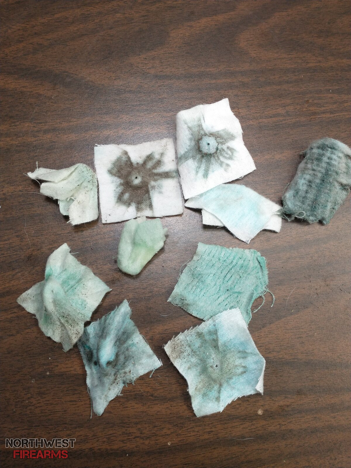

I does look like carbon, but here are a few patches I dug out of the garbage. There was a whole lot of coppers flecks coming out.

That's a lot of blue.

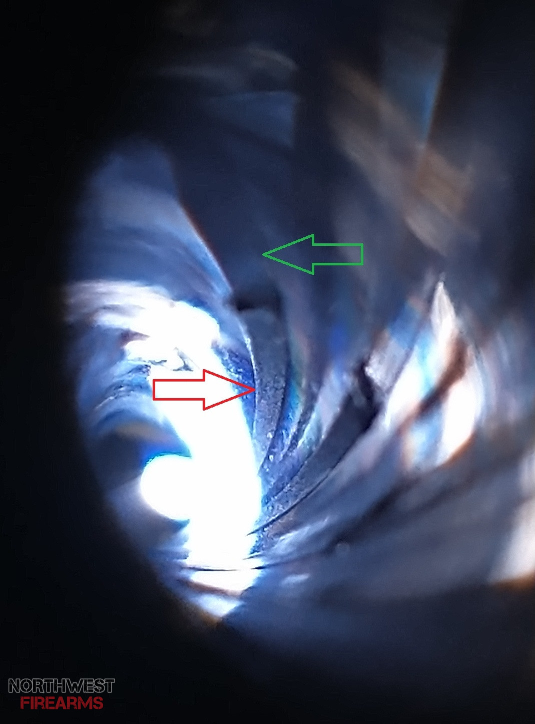

So I went out and shot 60 rounds through this thing and came back to this. Note the red and green arrows pointing out before and after "the spot", and you can see the abundance of copper/carbon being left and the copper runs all the way through the flash hider. I am sending it back for replacement now, but what on earth am I looking at? I have never seen this before.
That's a conundrum!
Are they covering the return and such?
