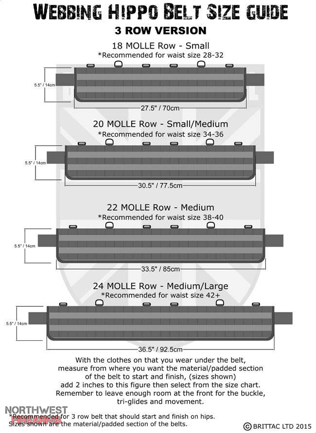

Is there a market for bigger MOLLE belts, with 3 rows of webbing (around 6 inches tall), and sized for real big dudes? Attached is the size chart from British Tactical, of their Hippo Belt models... I do not see one larger than the bottom, and as a fellow big dude, I am planning either a fixed length, or a 3 piece padded MOLLE/ALICE belt using the FLC/SPEAR belt harness style in OD, and 6 inches tall.. the idea is basically a low cummerbund type, similar to British PLCE webbing, or ALICE, but not worn like a Battle Belt (lower, sometimes on trouser pants).

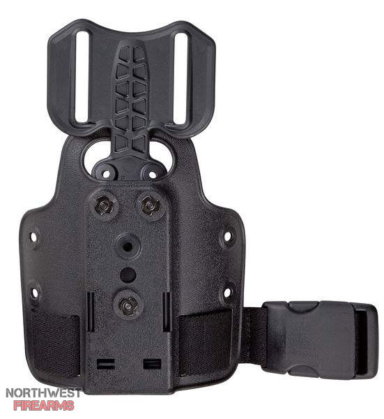

Looks like it would ride kind of high. Id count on using a thigh rig for the holster. Otherwise, you'll be kinda chicken winged trying to draw.
Or have the holster more horizontal than vertical..maybe diagonal, around 45 degrees to 60 degrees, depending on where it lines up.. the holster I have is an old Bianchi UM84 type, but I could simply mount to trouser belt and leave a flat gap on the cummerbund to allow draw. I hate thigh rigs by the way. Too dang bouncy even if securely strapped down. I have a relatively short torso to my arm length, but long torso relative to leg length... a bit like a gorilla :rolleyes:
Here is what I use. Its pretty rigid. Safariland 6004.

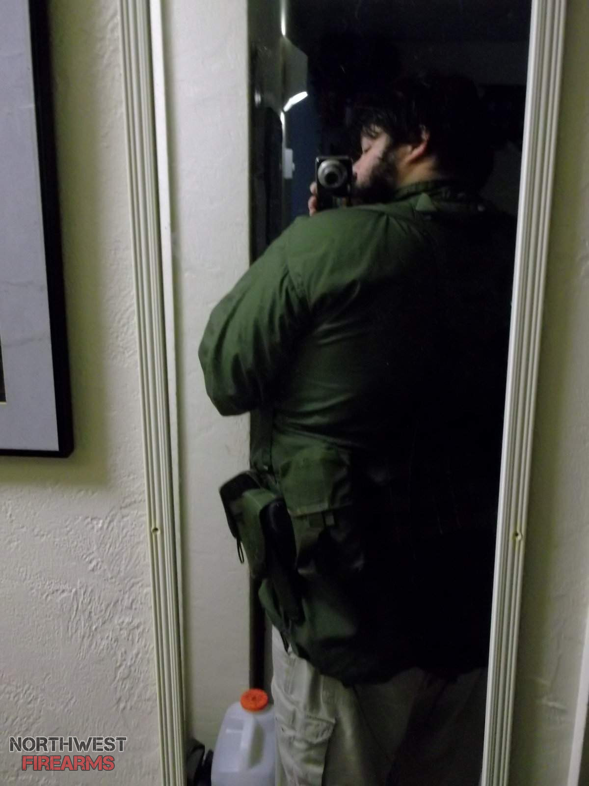

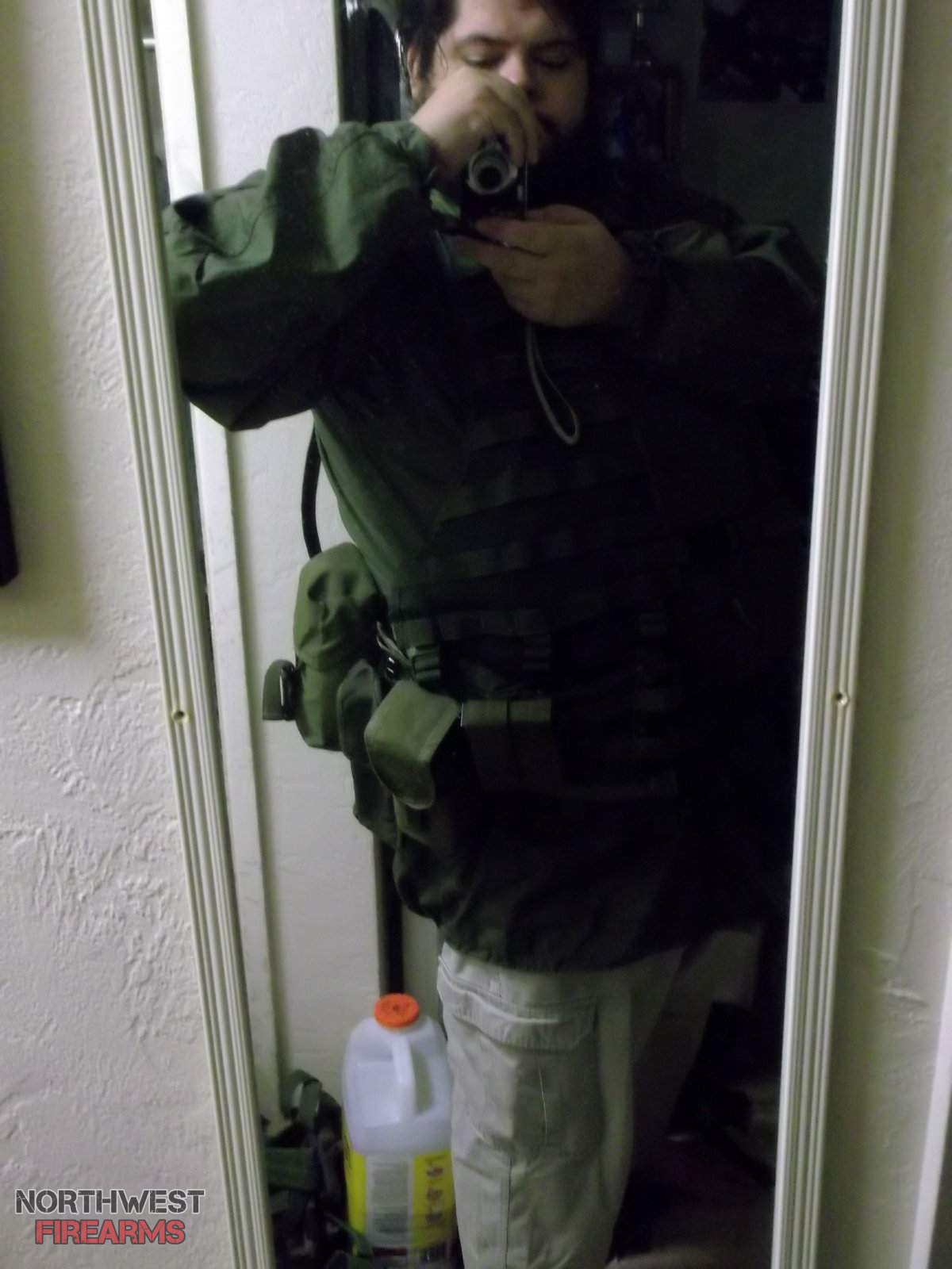

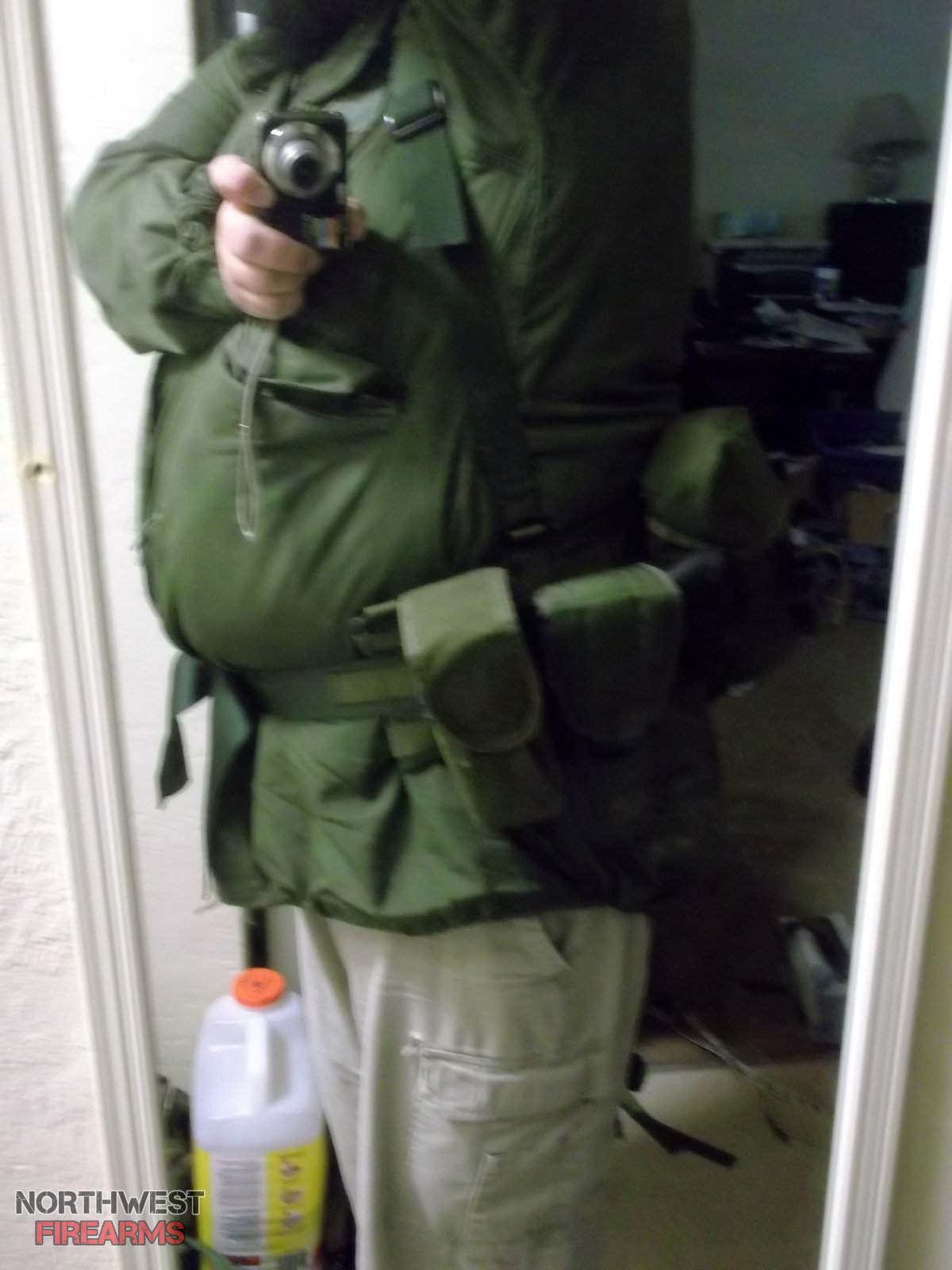

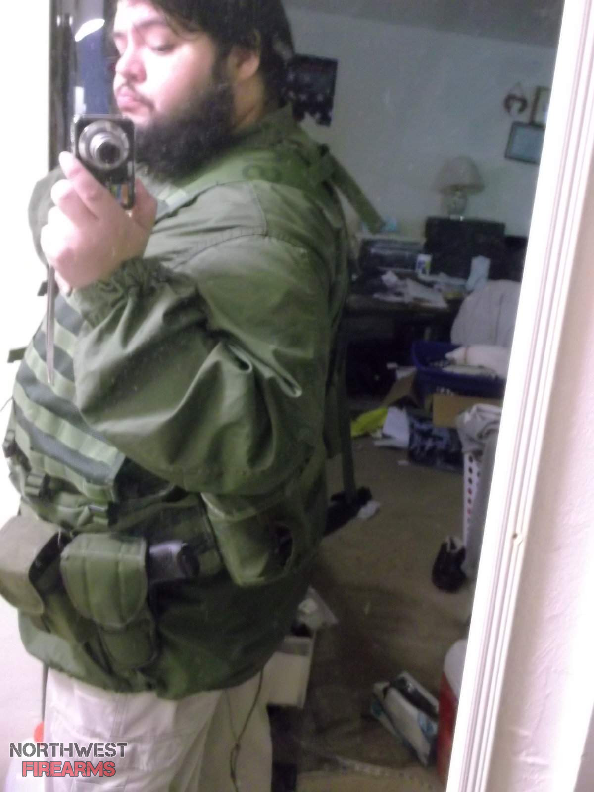

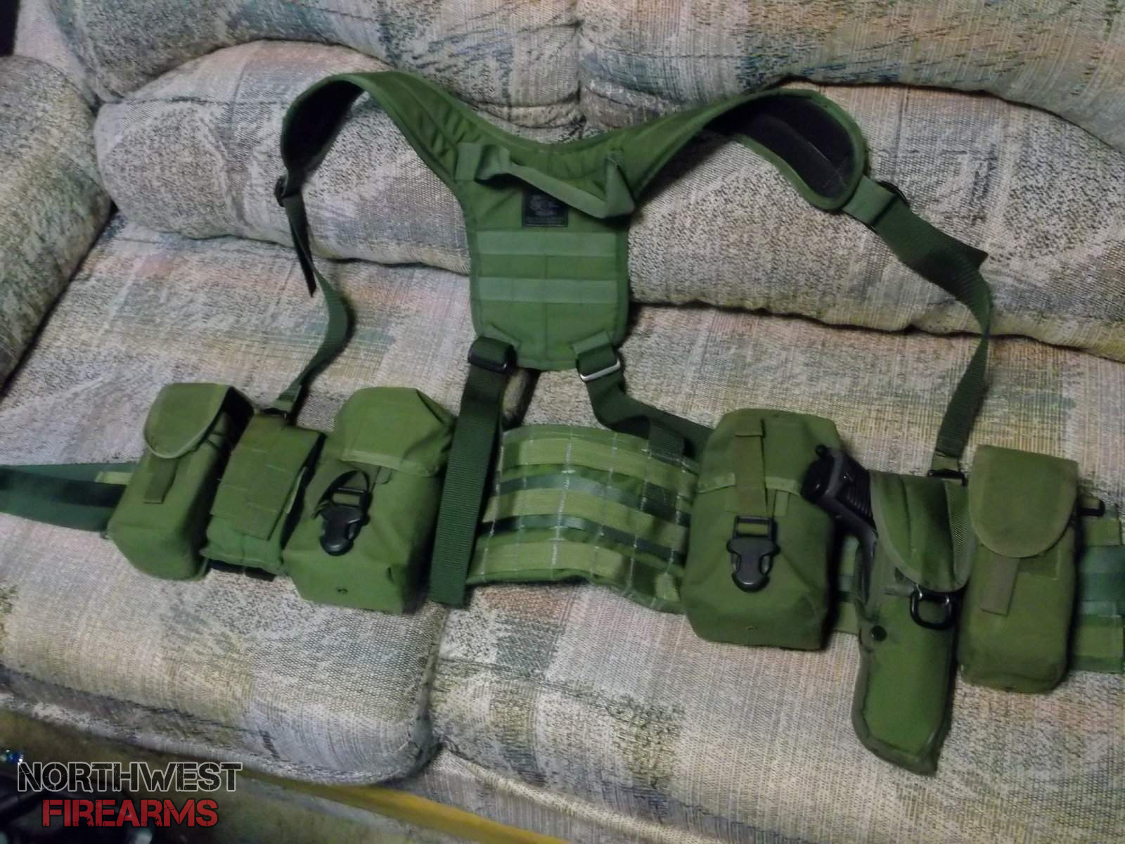

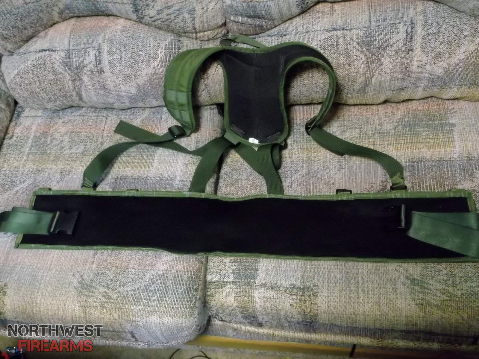

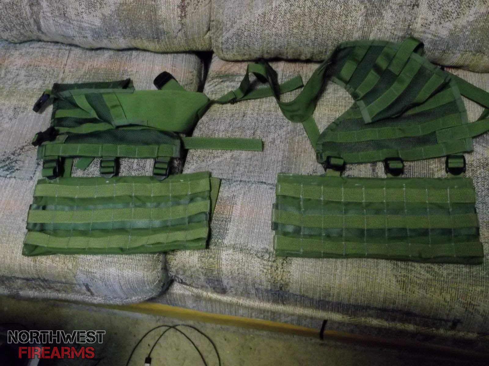

So I went and made the belt. First attempt involved making 2 sleeves that interfaces with the MOLLE 1st gen vest panels; works OK, but not as good as MOLLE II/2nd gen vest panels which did away with the 3-buckles per panel.... the sleeves want to rotate/sag with the weight of the 6 AR mags and 2 pistol mags and pistol.. but going to a LBE setup with a TT padded harness; it works better without the sleeves :rolleyes:
Specs
1000D Cordura
Mil Spec 1" and 2" webbing
Country Brook 1.5" nylon webbing
40"x6" MOLLE/ALICE padded section; with ridiculous amount of 2" webbing for fat bellies:rolleyes:

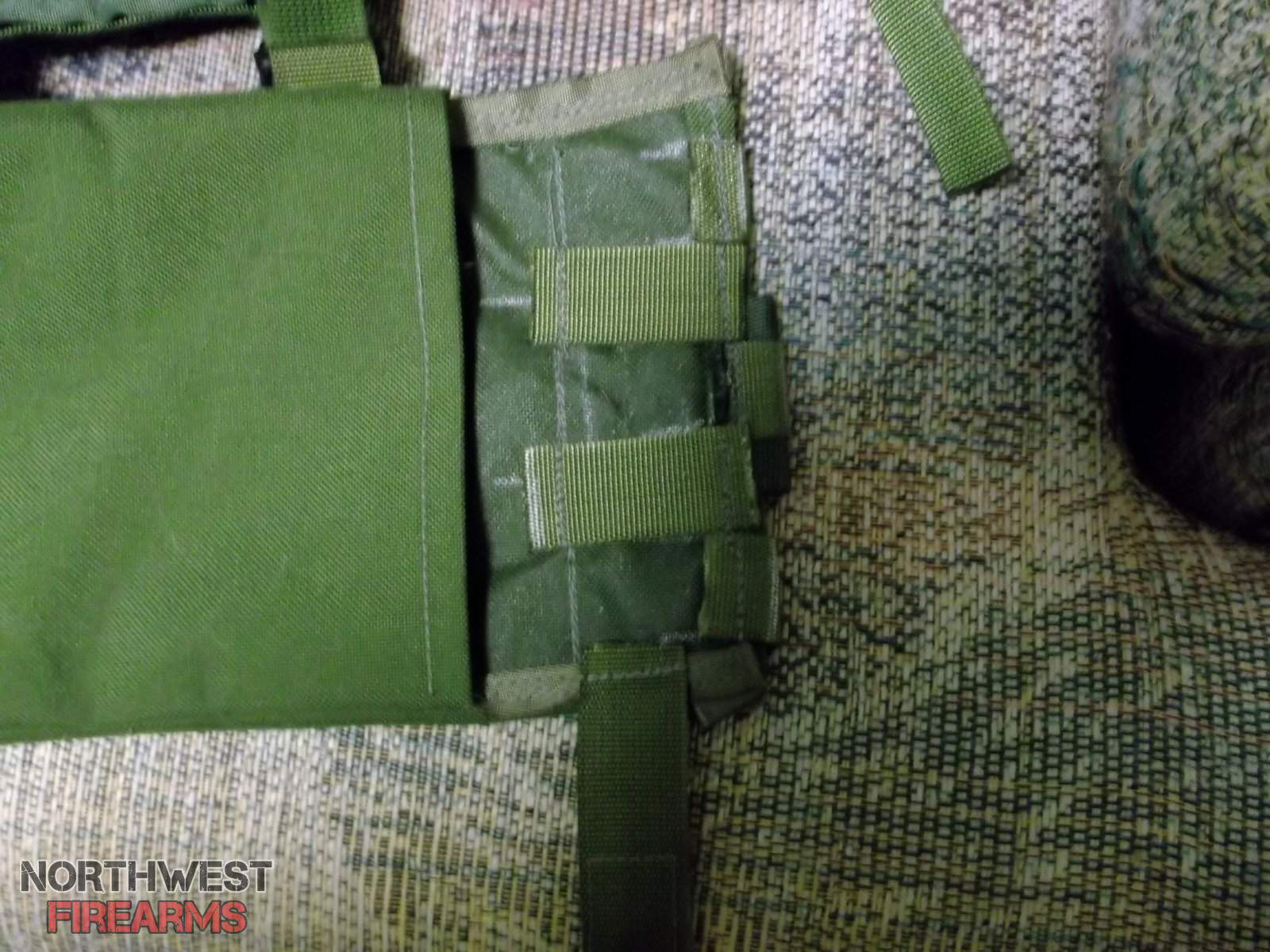

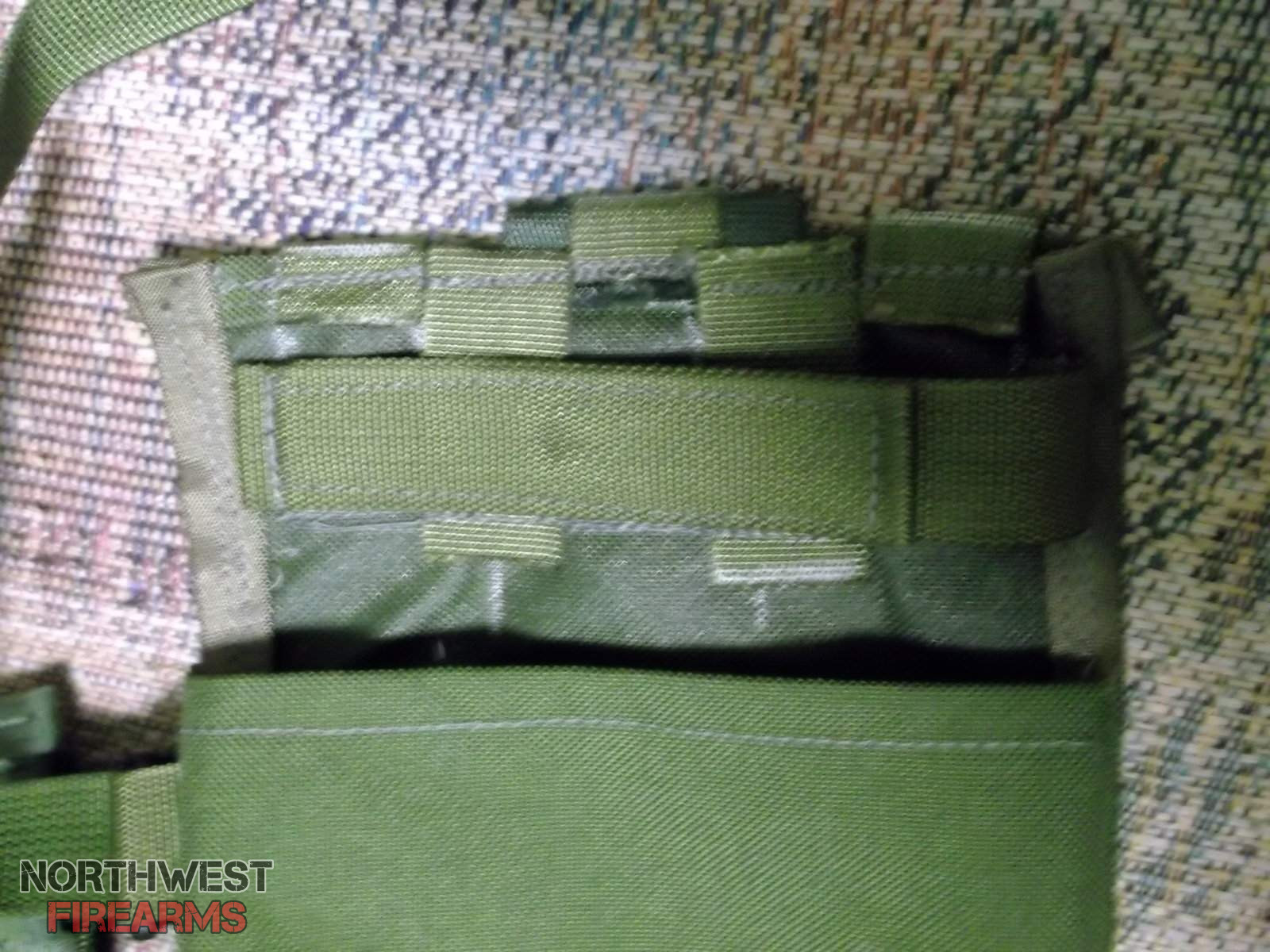

14x6.5" unpadded MOLLE/ALICE sleeves for MOLLE 1 vest panels; MOLLE strap stays and 2" webbing loop to stabilize belt locations

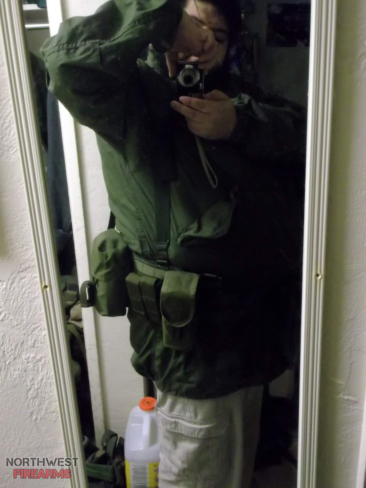

Pics of yours truly wearing ECW 1980s parka shell without liner; pouches are Tactical Tailor and USGI Bianchi Holster. Please excuse the slightly unorganied and messy studio apt DSCF2317.JPG DSCF2318.JPG DSCF2319.JPG DSCF2320.JPG DSCF2321.JPG DSCF2323.JPG DSCF2324.JPG DSCF2325.JPG

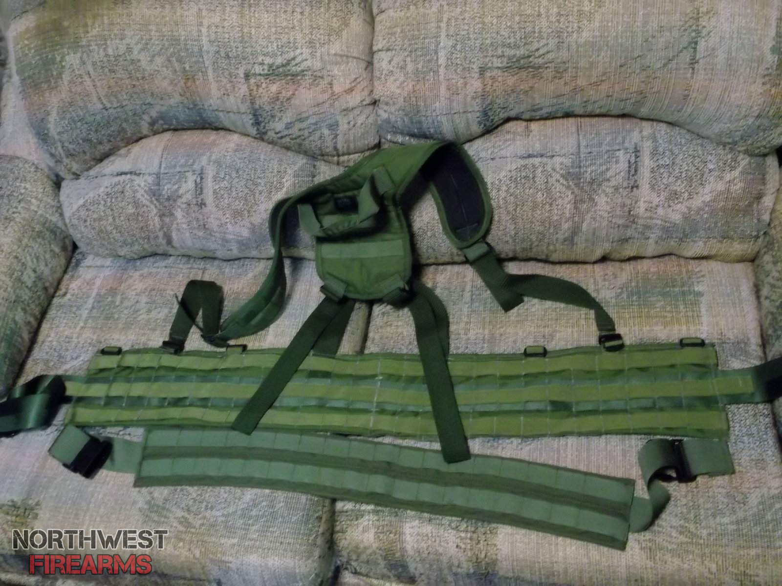

Pics of LBE system with and without pouches, detail of MOLLE vest panels with sleeves, and comparison to Tactical Tailor Size Medium Modular War Belt (28" MOLLE section, 12" webbing lengths each end). By the way, the MOLLE section is the exact same size as what is found on MOLLE II FLCs, just no friction buckles for the FLC vest webbing
DSCF2326.JPG DSCF2327.JPG DSCF2328.JPG DSCF2329.JPG DSCF2330.JPG DSCF2330.JPG DSCF2331.JPG
I like it. Been putting together my harness and battle belt using the old GI cartridge belts and Molle pouches; haven't made the leap to Molle style belts yet.
GI cartridge belt.... ALICE? I find I hated the ALICE clips if there were no good belt pads, thats why I went to the MOLLE style belts... last one I had; not enough MOLLE real estate to put my ammo where I wanted them to be.... modified FLC belts worked decently, but I wanted something not woodland :rolleyes: USMC FLC vest way too short on the torso for my size :confused: wears more like a chest rig, if I'm gonna have gear up high, might as well go plate carrier/vest/ chest rig instead of the FLC.
