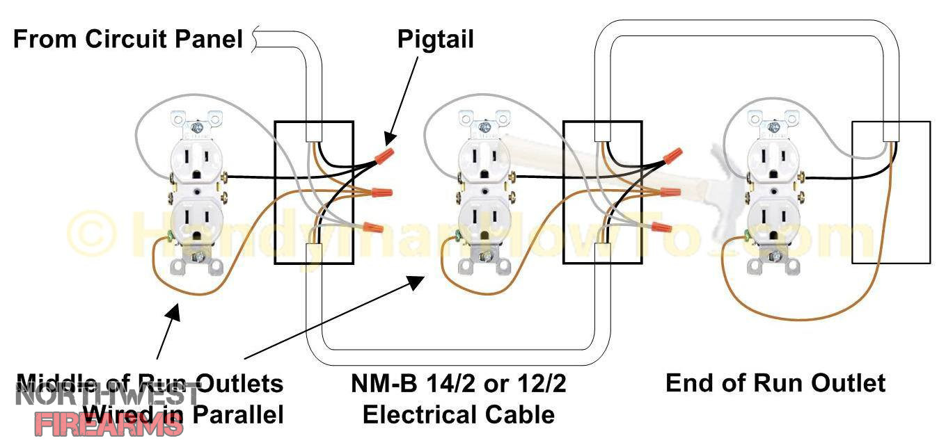

Your description is vague. What makes you think you have shorts? Are your breakers tripping? or do you have lights that don't work? outlets not working? are the breakers GFI breakers, if you have outlets not working are they GFI outlets if non GFI outlets are not working is there a chance they have GFI outlets up stream from them? You mention a bathroom remodel, when was it done? have the affected circuits worked at any time since the remodel?

are an issue at the receptacles. Residential work common to use the stab in "rapid wire" terminals on the back of the receptacle. These connections go bad and kills the circuit downstream. Replace and 'Pigtail'
the receptacles as they do in commercial and industrial work.
