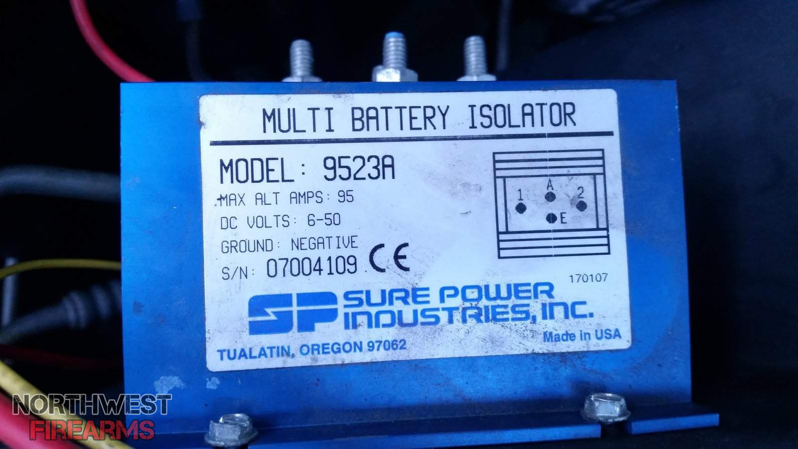

OK here is a photo of the isolator, and the extra battery bay.
There is a looks like number #6 gauge wire going across the radiator and connects to a fuse block terminal.
There are two large +battery cables coming off the main battery, one looks like the starter cable and the other goes to that block,
the wire off the Alternator appears to go to the idolator where what looks like #8 wires going to the AuX-battery
and ones goes to the main battery.
So it doesn't appear the aux works as a crank battery because the wires are not near heavy enough.

SO, these G.M. Trucks came factory set up for dual batteries because of the Diesel engine option, but unless it's a diesel truck, the second battery isn't used. As far as I know, G.M never installed an isolater, so what you have is an aftermarket unit! Normally your batteries need to match to crank a diesel, but in this case, you can use two different batteries as long as they can both crank the engine on their own! Find a local truck shop and get a couple of deep cycle cranking batteries, but DO NOT go over 900 CCA, those batteries are made for standby like on lift gates or reefer units, and will not last more then 2 years as a main battery! Deka and Interstate are the best brands and you can get them replaced any where in the states!
BiMart is also a great place to get batteries, but you wanna call ahead as not all stores carry the same stock!
I would also convert to top post batteries and get away from those Chit G.M. side posts and convert your cables while your in there! Use the heaviest cables you can find, usually 0/4 gau is what gets used in these applications!

the only 2 battery set up ive seen in that vintage of GM truck has been on a diesel. id be happy to post up a diesel wiring diagram to show you how the 2 batteries are hooked up in series
The only part that has me kinda stumped is the battery wire going to the fuseblock terminal from the battery, it looks original, and there is post extension on the battery to allow two cables. Of course that could be added, but why the two + hook up to what looks original has me puzzled. I know wiring pretty well, but as mentioned never had any experience in dual batteries. Even when I drove trucks I never dealt with them, that was the shops responsibility. Yes if anyone has any diagrams that would be great. I may write the isolator manufacture and see what they have on this part too.
