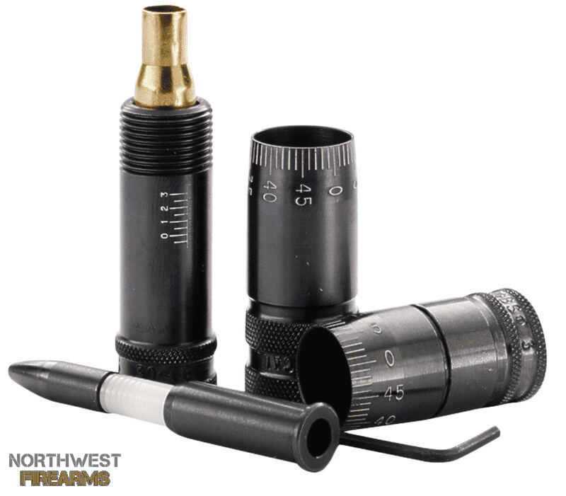

Adjustment of the sizing die to bring down the case shoulder to spec. You can use a RCBS precision Mic or
the Hornady Lock-N-Load Headspace Comparator to measure your sized brass.
