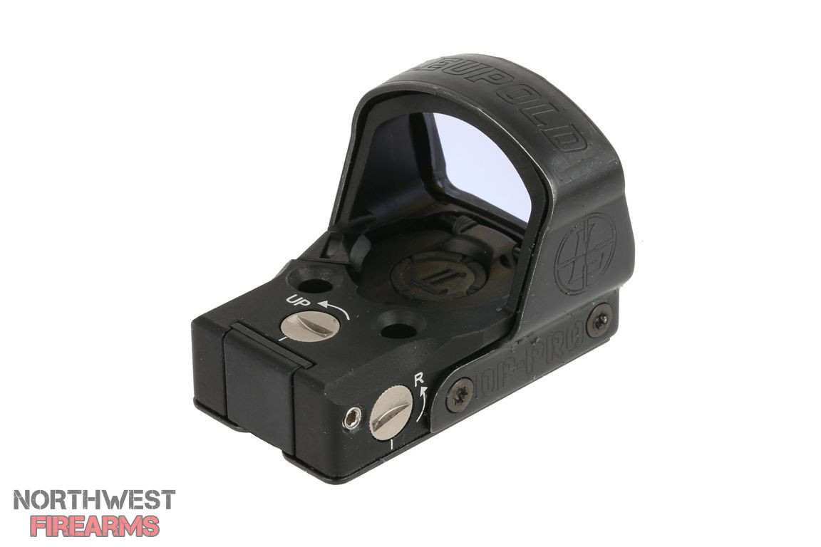

Yeah that's not a DPP. Sorry friend hate to be the bearer of bad news.
I'm not 100% sure. I see two kinds of genuine Leupold DPPs, one with the serif "DP-PRO" font utilizing hex screws on the lens shield, and one with block "DP-PRO" text utilizing torx screws on the lens shield. These are both are real:
But what's got me wondering is the texture. I can't seem to find a Leupold DPP that has that rough texture...
But what's really throwing me off is that even the Chinese knockoffs don't have that bumpy texture... Here's a $70 Chinese copy straight off alibaba with smooth texture and a clean QR code:
So I dunno.
Edited too: Sorry for bombing your thread PistolHoarder. What a rotten thing to wake up to. :(
But at least now we know why the holes were undersized, ouch.
I'm gonna do that tomorrow. What's to stop them from using a real serial number? Would Leupold know if there were 500 units with the same serial number?
See my edit. Unfortunately, the serial number matches the counterfeit in your last photo.
It's definitely a fake. :(
