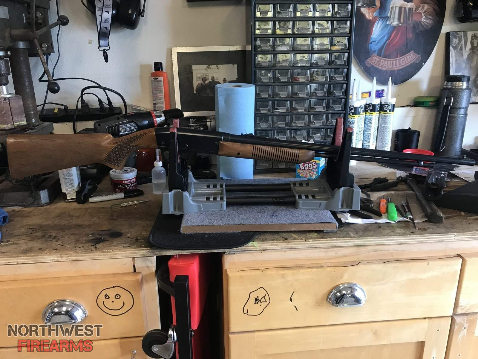

i recently picked up a mint condition daisy 572 at an estate sale and when i first fired it the bb's would literally go a foot out of the barrel and drop i dropped some oil in the oil hole hole and it improved a little now i get 20' with enough power to go thru a paper grocery bag but not enough to go thru a can. Anybody know how to wake these old guns up?
