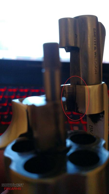

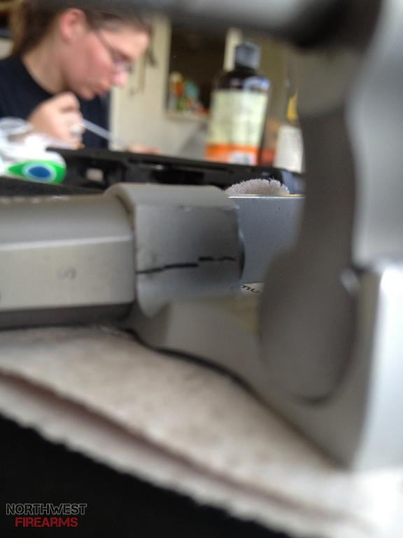

Is that normal? If so, clown on and I'm a silly goofball. If not, is this common?
Is it "normal"? No. Is it a problem? No.
How long is that vertical "crack" you are worried about, 1 millimeter? Less than 2 mm? Would you even see it - the vertical "crack", not the horizontal seam - without extreme close-up photography or magnification? If you hadn't noticed the normal seam at that location and had your attention drawn to it, would you have even noticed that minuscule "crack"? I would consider to be more of a blemish or scratch than a crack. If you went over all of your guns with a fine-tooth comb like that who knows what you would find.
I took a quick look at my Model 60 last night when I saw your thread. There is an actual arched gap on mine. Your seam is tighter than mine at that point. I'm really not worried about it. As the threads I linked to showed, it is a common mistake for people to think the seam between the side plate and the frame is a crack. It isn't and it isn't something to worry about.
Now, if you want to worry about some real cracks, there have been reports of lightweight J-frames cracking under the point where the barrel screws in. That's where you should be keeping an eye on things.
Are you seriously recommending to someone that they should ignorantly ignore something they don't full understand because you say so? I hope this gun is brought to attention of the PROFESSIONALS who engineered the firearm for inspection. If it gets a clean bill of health what is lost? If it comes apart in his hands what could be loss?

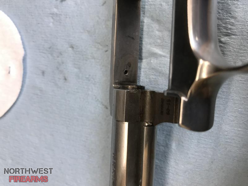

Those gnarly splits were the type of thing I saw when I googled "J-frame cracked" or something like that.
That type of damage would certainly have me VERY worried, and without a shadow of a doubt would have me render the piece inoperable for my, or anyone else's use.
Back on the 637 in question:

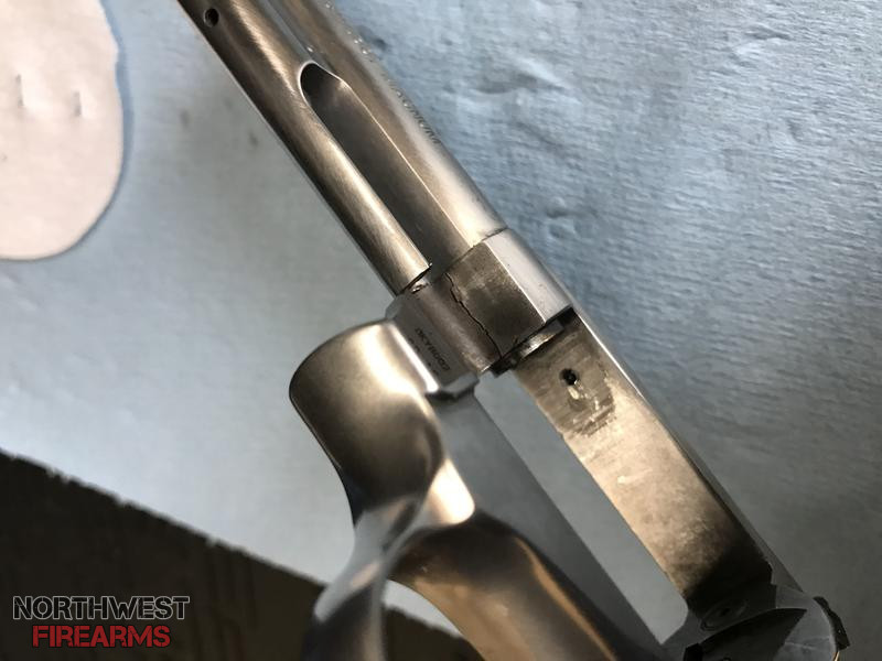

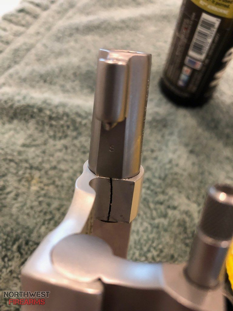

This little crack is probably 1/4" long right now? It is easily visible with the revolver in hand. I bet it would get larger if I kept shooting with it.
This crack/damage actually did prompt me to really closely inspect my other revolvers and auto-loading pistols and I couldn't find anything alarming in any of the other ones. Sure, typical wear marks that you'd expect from a holster/carry piece, and also from using them, but nothing like what I see on my 637.
Maybe I am just more picky/neurotic than some but that crack on the 637's frame has me concerned. I just don't want to find myself interrupting an enjoyable afternoon at the range with a trip to the ER picking pieces of metal out of my shooting hand.
As I initially mentioned, the 637 was purchased as a range trainer, not a carry gun, but I sure don't want to ruin a day at the range by neglecting to contact S&W for the all clear or "that's fine and nothing to worry about." :D
Due to the holiday, I have not been able to correspond with either S&W or a local gunsmith who would know much more than me, so all I've got to go on is my experience with machines, and my experience says: "that ain't good and don't look right." :/
If I saw something like that on my CNC mill, I would shut the machine down, lock out power, pull the operator and be on the horn with the manufacturer to acquire replacement parts. That's just me. I don't want my guys getting hurt.

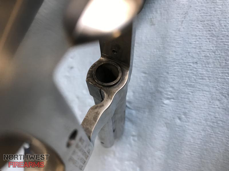

Custiosity got the better of me and I removed the side plate to see what that area looked like inside.
The "crack" I was concerned with was visible inside as well, but I found that area broke off with VERY light pressure from a toothpick. What I gathered was that that material should have been machined away (explaining the missing part on the new revolvers) but was not fully removed on my 637.
The photo below hopefully displays what I mean (compare with original photos where I initially expressed concern). The photo was taken after reassembly and removal of the "crack" area.
In short: I was worried over nothing but did not have the experience to determine if it was normal or cause for alarm.
I can admit when I am wrong, and I was wrong on this one.
Needless to say: revolver did not go back to S&W (I'm not gonna waste their time) and runs great. :)
