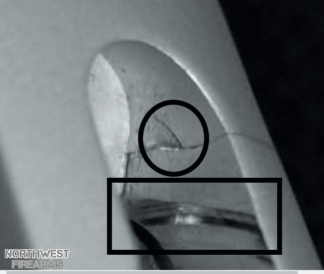

Well, I am proudly showing off my new revolver to a friend last night and he noticed what looked to be a crack in the frame?
Skeptical, I replied "no way. I haven't even run two full boxes though this little cutie. Show me what you are talking about."
So he does, and to my shock and awe, I can see what looks to be a pretty serious crack in the frame of the revolver!
I will contact Smith and Wesson and follow the process needed for repair/replacement (I cannot see how this could be repaired without replacing the frame), but my question to those reading this thread is: has anyone else seen a newer Airweight break like this? With under 100 rounds through it?:(

The photo below highlights the area of concern. There is what looks to be a crack running upwards from the point of the toothpick, as well as what doesn't look or feel like intentional machining, running closer to the area where the hammer stops.
When running a toothpick across the seams of the sideplate/frame junctions it feels smooth, the points of concern feel "crunchy" or rough, which is what makes me believe the frame is cracked.
Maybe I've cracked? Regardless, I hope this photo helps illustrate the area of concern (to me).

I've attached a few pictures to highlight and hopefully illustrate what I am concerned about. Maybe it's nothing and I'm crazy.
One photo is my 686+, the other photo is my 637. Hopefully my photography skills can display what I am concerned about. (I'm working with a "smart phone" and admittedly not a professional photographer. :p )
686+ where side plate meets frame (side plate and frame contact points are pretty visible and clear with nothing weird and nice smooth lines from machining):
637 where side plate meets frame.
My concern is that little crack creeping up about halfway along that seam):
While it's a little hard to see in these photos, maybe zooming in might help or make it easier to see, the area of concern is VERY easy to see in real life. One of the things that really jumps out to me is that on the 686, the side plate is clearly machined and mates up smoothly and with what looks like an intentional radius to its profile, while the 637s same area isn't rounded/smooth/intentional looking. I.e. it looks like it is cracked?
I will try to figure out a way to edit/highlight these photos to emphasize my area of concern, but maybe I'm off base and this is normal or nothing to worry about?
There isn't a known concern with these revolvers is there? Anyone seen anything like this before?
Here are a few close up/zoom shots of the area of my concern. Forgive the crummy photos. I'm working with a smart phone, not a nice DSLR with macro lens.
I only have my 686+ to compare with side by side, and while they are different models/designs, there are certainly some similarities in their design construction.
Either way, I hope these photos help to highlight what I am wondering about.
The poorly drawn yellow/orange arrow is pointing at main "crack" I'm concerned with, if that's what it is. It can be felt easily when drawing a toothpick over it.
This little area (highlighted below with a crude little arrow) doesn't look like it was machined with an intentional radius either. And maybe that's normal, but it looks more like a crack than it does machining to my untrained eyes. Similarly, it feels different and "rough" when feeling with a toothpick and comparing to the outside edge of the side plate (where side plate meets frame).
Hopefully these photos aide anyone who may have some insight into this.

OK, I think I see what you're seeing now (inside the circle) and without being able to examine it I'll concede that you may not be crazy.:D Contact Smith and let them determine what they can find. The fact that you are the second owner should not matter and likely will not come up unless you mention it. I've had good experiences with their warentie department. I'm also bothered by the rubline I have put the rectangular box around, looks like the hammer is rubbing harder than I am accustomed to. It would be interesting to examin it with the side plate removed.
That's EXACTLY it!
You are clearly way better than me with the photo stuff, but yes. That area circled is what I am concerned about. So maybe I'm not crazy? Is that abnormal? Is it a known thing with the Airweights?
And I agree. It does look like the hammer is/has been rubbing against the frame a little as shown by the wear/smooth line carved by it.

I get it, and to a certain degree, agree. But is that "crack" headed upward normal? I added some zoomed in photos above to highlight the area of concern. Here is one of them highlight the area of concern (the orange/yellow arrow points to the upward heading "crack"):
I know some of the seams are the side plate meeting the frame, the one that has me worried is the one that heads upwards.
Is that normal? If so, clown on and I'm a silly goofball. If not, is this common?
