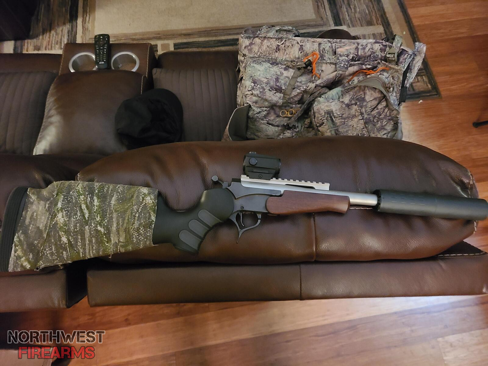

This project (shown above) started with a 10" 30 Herrett barrel, threaded and pinned a 7" vented 'fake can' and carved the custom furniture to fit the profile from spalted sycamore and burly maple.
The performance of the loads intended for it's use was to utilize heavy for caliber bullets at low velocity (around 1550 fps) much like a 300BLK. Subsonic was not an option as Thompson Center assigned a 1:14" twist to the barrel. Shoots great! Fast & handy!

remember ... just one more barrel. 30 Herrett this may look 'tactical' but it ain't. It's a 7" vented extension threaded and pinned to a 10" barrel
with custom furniture of my own design and a low power fast target acquisition Weaver scope
