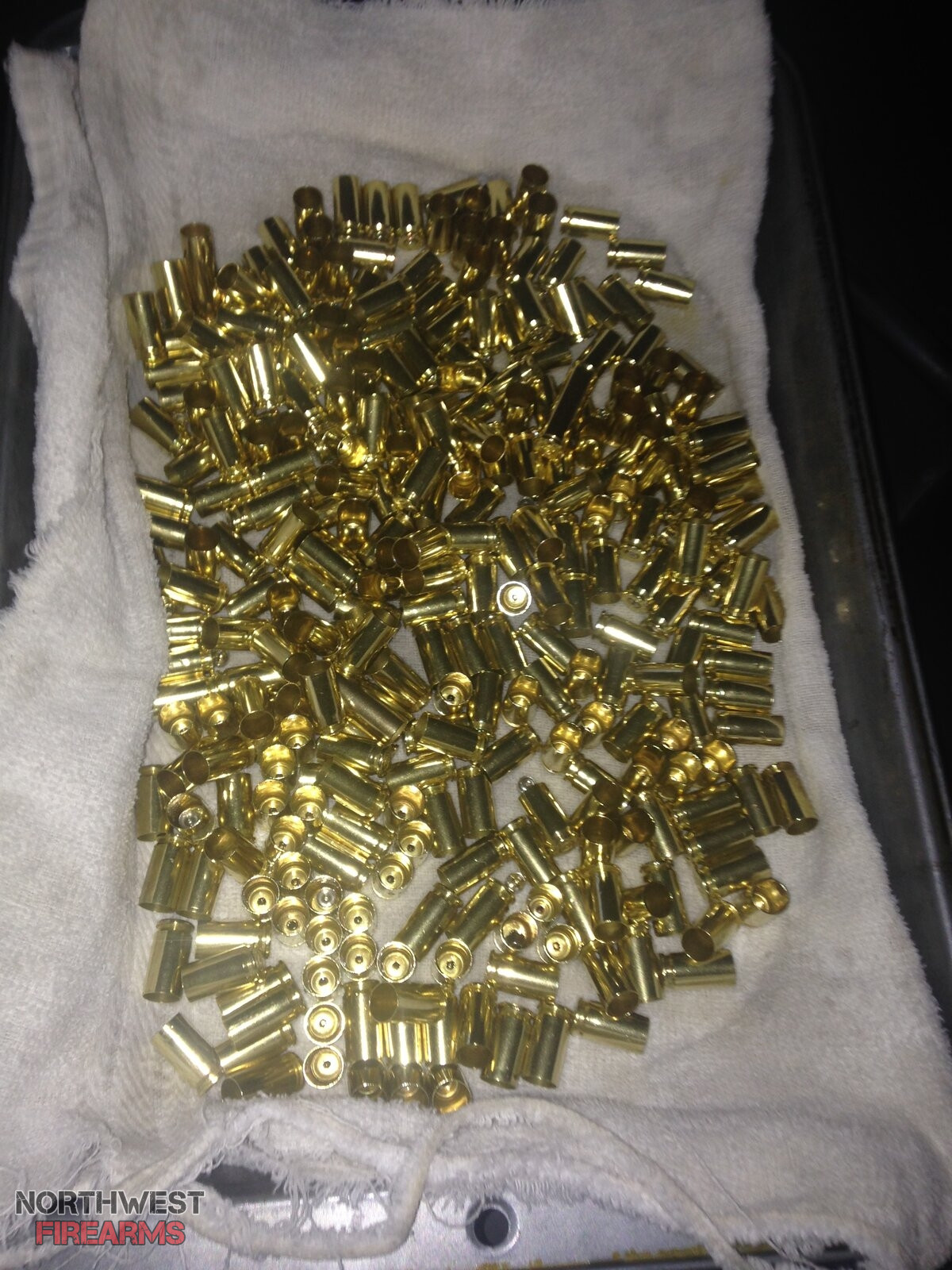

Kind depends on how MUCH you will tumble at one time. Some use those rotating separator devices but I don't tumble that much at one time so I use a plastic colander (with 1/4# openings) in a plastic bed pan.
I dump the cases out of the tumbler cylinder into the colander, shake and rinse them in the sink while running water over them. All the pins drop into the bed pan. Then I rinse out the dirty water, and pour the water & pins into a fine screen sifter, drain, and the cases go in a towel lined SS pan and both get set on handrail outside on my deck to dry, or on a trivet on my wood stove in the winter.
The cases go in a towel lined SS pan to dry.
Again this works OK for small amounts.
