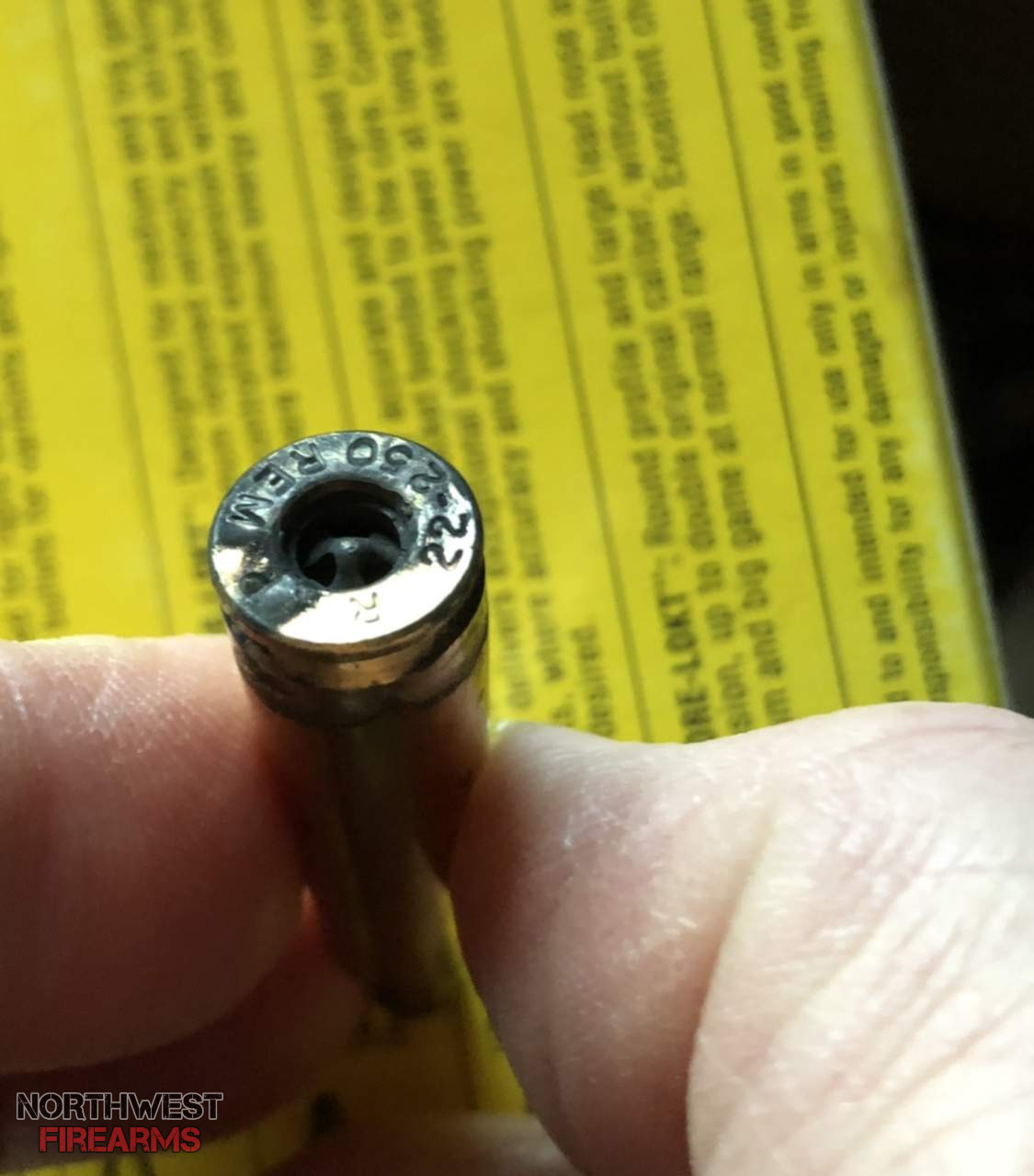

Sorry. This is a model 700 sendero in 22-250. Upon firing the rifle im getting blowback and (wish I could post a photo) the primer discinagrated.
Smoke came back into mag well.
I don't recall where I got the ammo but suspect it came with a rifle purchase some time back

Yours being factory ammo, thats a tough one. Any other ammo you've tried in that rifle?
If the ammo "may" have come with the rifle how certain are you that these are factory loads? Many people use factory boxes to store their reloads in.
It could be someone's reloads but I usually try to avoid those. It looks like factory but not new factory.
So it sounds like caused could be overloaded rounds or bad primer or bad firing pin.

Yes, overpressure rounds can do significant damage and could ruin your barrel and bolt. Dump the powder out of one and weigh it. Then check against a reloading manual for type of powder - ball, extruded, flake etc. Also, the primers may be magnum, which would add to the overpressure. The bullets may be over crimped too.
Pierced primers can etch your bolt face, assuming it's just soft primers or a damaged firing pin. A gross overload is another matter.
I would look closely at the firing pin for any sign of damage, and if there is none, get some fresh ammo and see how it does.

Stop using that ammo. It's either loaded too hot, too sharp of a firing pin, or too much clearance between the firing pin and firing pin channel.
I would either throw all of them away or pull the bullets and start with YOUR powder and loads. my suggestion as that caliber of brass is not usually plentiful
Wow, ouch. I was expecting leaking or pierced primer. That one is blown out! Definitely a good call to stop using that ammo. I would pull it down for components.

Yup, examine the bolt face and nearby parts carefully. I had a used Weatherby 300 that I bought that had a cratered bolt face I hadn't seen and did just what your pic showed. I demanded my money back!!!
I'm curious if you should check your headspace. That's where you could have an issue.
It would be nice to measure the fired brass' headspace from the datum line and compare to SAMMI specs.
