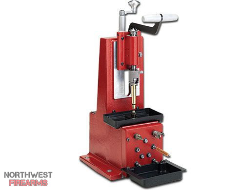

Frankford Arsenal has a case prep center. It uses a collet to hold the case (user adjusts tension) while trimming which is the most torque on your hands portion.
I cannot grip much for extended periods of time so at $150 it was money well spent.
I use the Lee case trimmer chucked up in a cordless drill that sits solidly on the workbench. It takes probably around 5 seconds to lock a case in, trim and chamfer inside and out.
I do quite a few different bottleneck cases with of course 5.56 being the most.. probably only trim about 1000 of those a year.
works good for me
I have used the Lee trimmers for many thousands of rounds. Worn
out several. The problem with the Lee is trim length is not
adjustable. I have used the Lyman trimmer also. It is adjustable
to trim length. I set it up to adapt a cordless drill. I like the
Lyman quick release shell holder. The Lyman cutter leaves
a lot more to debur and chamfer. Still my favorite is the
WFT. It trims off the case shoulder like the exspensive
Giraud and Gracey. I know many fellow shooters use
the Gracey or Giraud. But $400 for one caliber???:eek::eek:
GIRAUD POWER CASE TRIMMER
GRACEY POWER CASE TRIMMER
WORLD'S FINEST TRIMMER

Agreed. $400 for just a trimmer for each caliber is way too much for this hobbyists budget as a new reloader. I'm not going to be cranking out 5 to 10k rounds a year, I just want to build some accurate Freedom munitions (quality over quantity).
Yea, I keep my bottleneck rounds segregated by headstamp and number of times fired so the trimmed deviation is plenty good enough for me.
