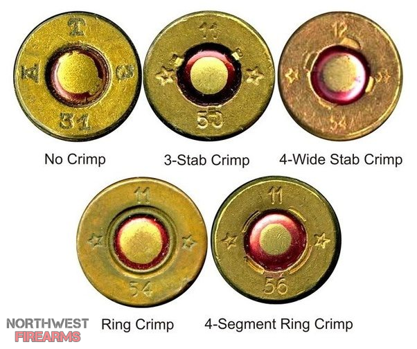

Bottom right, thanks @bionic knees !!! @CKStephens, headstamps may differ but crimping style only has so many types.
Heavier brass/slightly less case capacity?2017 Lake City 5.56 NATO with approved crimp (4). Adjust powder charge accordingly if you use them.

yep, primer crimp...I'm speaking of the four impressions around the primer.
I started using the Frankfort Arsenal hand depriming tool. That thing is a beast, removes crimped primers with ease.The only crimped primers I have seen were ring crimps, and I found them too much of a PITA to deal with... tired of breaking decap pins.
That thing is awesome, I use it to deprime almost all my brass and just powers through anything.I started using the Frankfort Arsenal hand depriming tool. That thing is a beast, removes crimped primers with ease.
Thx for the info... unfortunately for me, bad arthur would keep me from using that... i hand prime, but doing so doesn't require much effort.I started using the Frankfort Arsenal hand depriming tool. That thing is a beast, removes crimped primers with ease.
