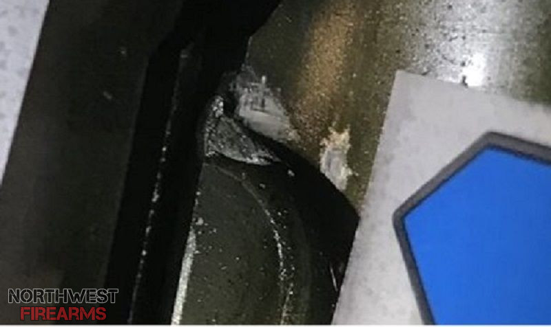

Thanks for thinking of this problem. I am learning what I don't know. Here's some pics. The colored arrows are points getting hit by the BCG the Yellow is where I'm thinking of milling off a bit. Here's why. I took the barrel off and I put a shell with primer only in battery by locking it into the bolt. The bolt went into the barrel and camed over. When I tapped the FP the primer fired? It seems if I mill the yellow and blue I wouldn't hurt anything. The yellow would take a shim and the blue? It just doesn't seem like it would matter if it were enlarged a bit?

Cam wear on the receiver is common. It shouldn't be seen as out of spec.

Reno is 100% correct. Maybe I am seeing this completely wrong, but in your photo you can see that the cam pin has taken out a chunk to make room for itself. When the cam pin fits in it's new slot, it will fire.
Your green arrow looks like its from your brass ejection, normal.
I am going to echo "get it to a smith". Don't start milling and shimming before a real pro looks at it. You can even contact the manufacturer of your parts and explain whats going on.
Thanks for your time and thoughts. The blue marks are coming from another bolt BCG and not the bolt. The ones that don't fit hit this area. So I was wondering if this should be enlarged? I would love to chat with the manufacture except they went out of business about 10 years ago. DPMS knock offs. This issue may be part of why their no arround?
