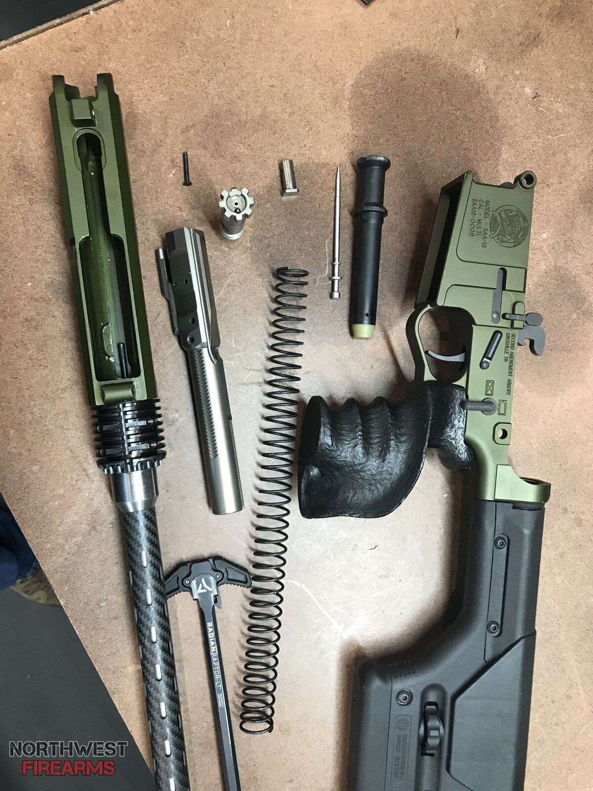

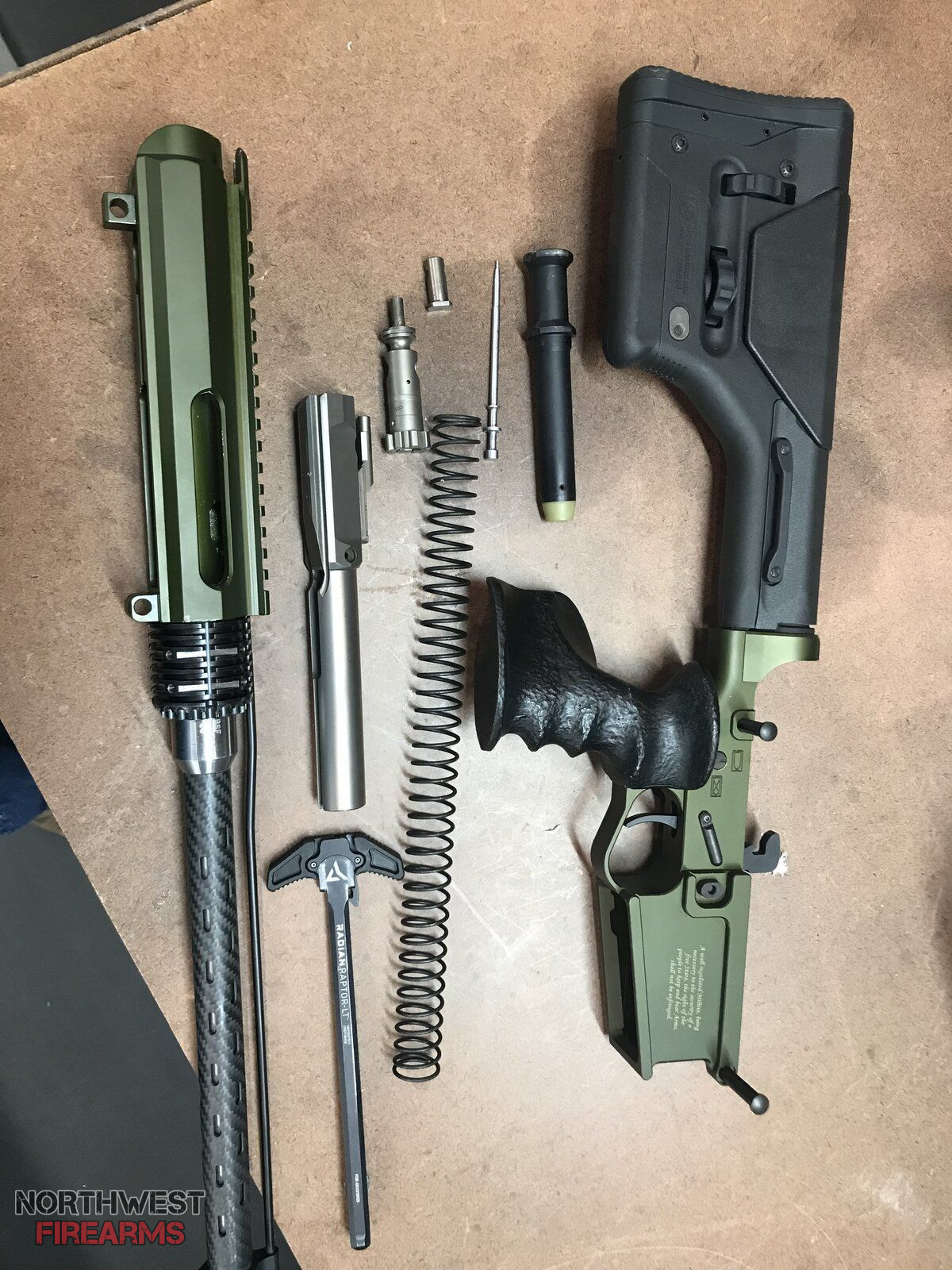

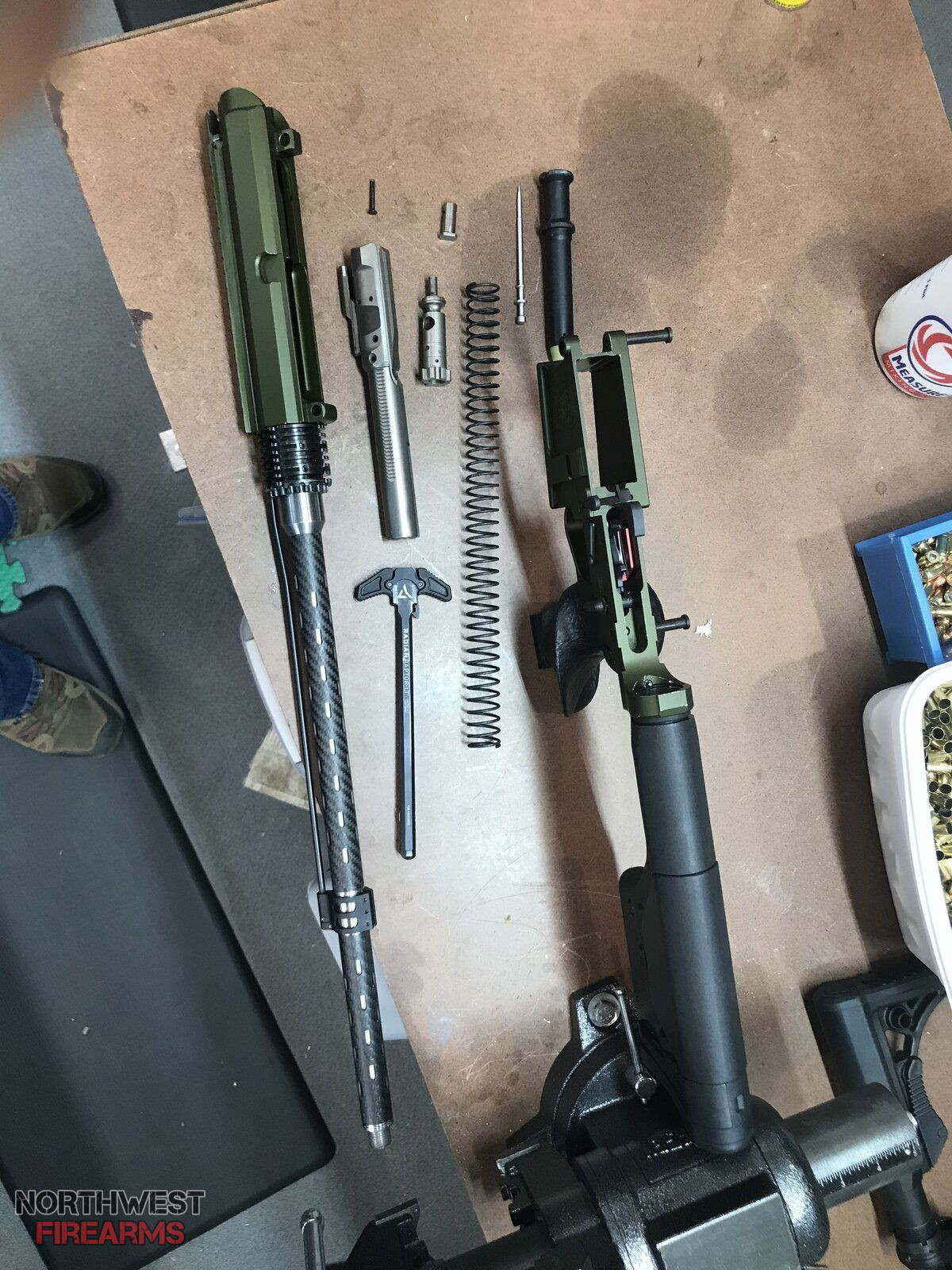

Did you ever post pictures as requested in another one of your threads? i.e. hammer/spring, the light primer strike, ect.
Crap, I took them. Lets see if I can do this. Thanks for the reminder.
That last pic has a rod with a black ring that I was using to compare it to another working build. See that nick to the upper end of where the cam lands? Then just at the bottom right you can see where it's also getting nicked. I tried to tap the BCG after releasing it from a locked mag position. It fired. That's why I thought bolt bounce. Now it wont do that. I'm ordering the go - nogo gauges and a re-loaders sizing block to check ammo. Any idea until they arrive would be most welcomed! Thanks guys!
Nice build. It does look like your hammer spring is in correctly, so that's out. The marring from the cam pin should tell you something is out of spec, or incompatible causing the issue you are experiencing. Getting the head space gauges is good idea, but won't do you and good until you figure out why the receiver is getting chewed up. Need to consider the BCG, receiver and barrel extension.
Did you flip the receiver over and run the BCG in and out by hand so that you can feel and see what the bolt is doing?
One picture has a drop in trigger, one doesn't. Are these pictures current? Swap triggers lately?
