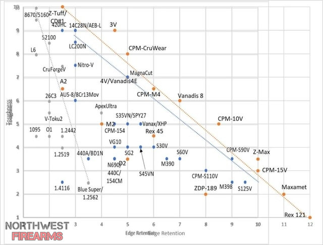

Knife nerds is by far the best source. To make it easier here is a chart where the person combined several knife nerd charts. Just look up the various knife steels.
As you probably already know, geometry, heat treat etc can have a huge impact. I have a hollow ground D2 Civivi blade that is darn near impossible to dull. A have different brand knife also d2 and it's completely different in edge retention.

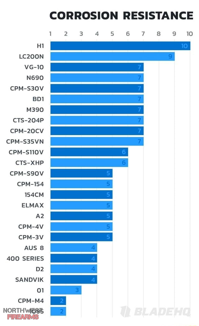

For a source on knife materials I would browse the knife nerds website. For generalized and not as accurate source, bladehq has some general charts and descriptions that are still helpful.

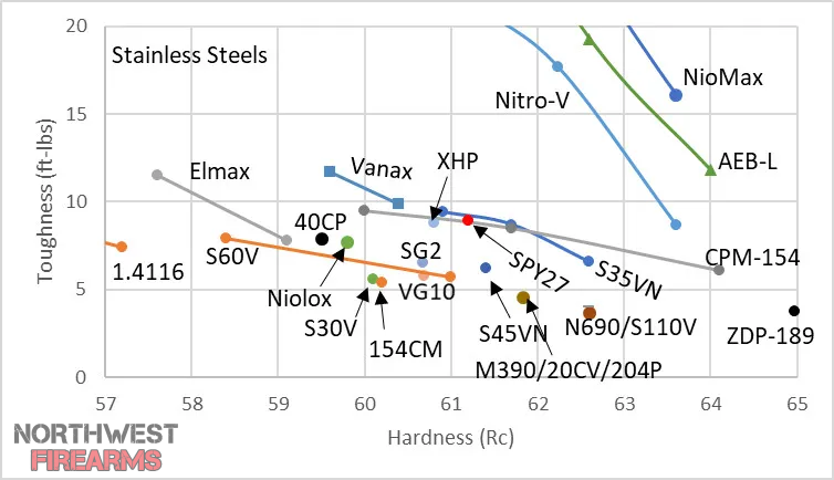

Yep, Larrin over at knife steel nerds is the sort of the bible when it comes to blade steel properties. Just know that blade steel is only one (rather minor) variable in a blade's performance. Heat treatment, and blade geometry are going to be significantly larger factors in the way a knife cuts, holds an edge, and sharpens.

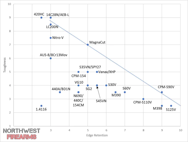

it looks like both my knifes are comparable and in the middle of the toughness/retention spectrum, with my S30V blade having better edge retention.

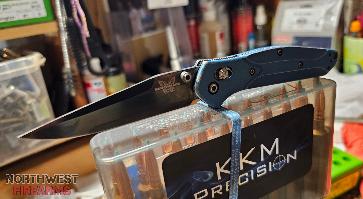

The Benchmade Osborn pictured is about 30yrs old and a limited edition polished blued steel, I have never seen that drop point on an Osborn since.
I tend to favor the Osborn over the much newer Benchmade Grizzly Creek S30V knife... so I was just curious if one was significantly "better"... yes I know thats subjective and based on use and how its sharpened. I can get either one razor sharp, the S30V takes longer to sharpen so I was correct it was a slightly tougher steel.

154cm is the tougher steel. S30v will be more difficult to sharpen, and should hold an edge longer given all other things equal. Toughness in steel is generally the opposite of hardness. The vanadium carbides in S30v can make it harder to sharpen to a fine edge.
