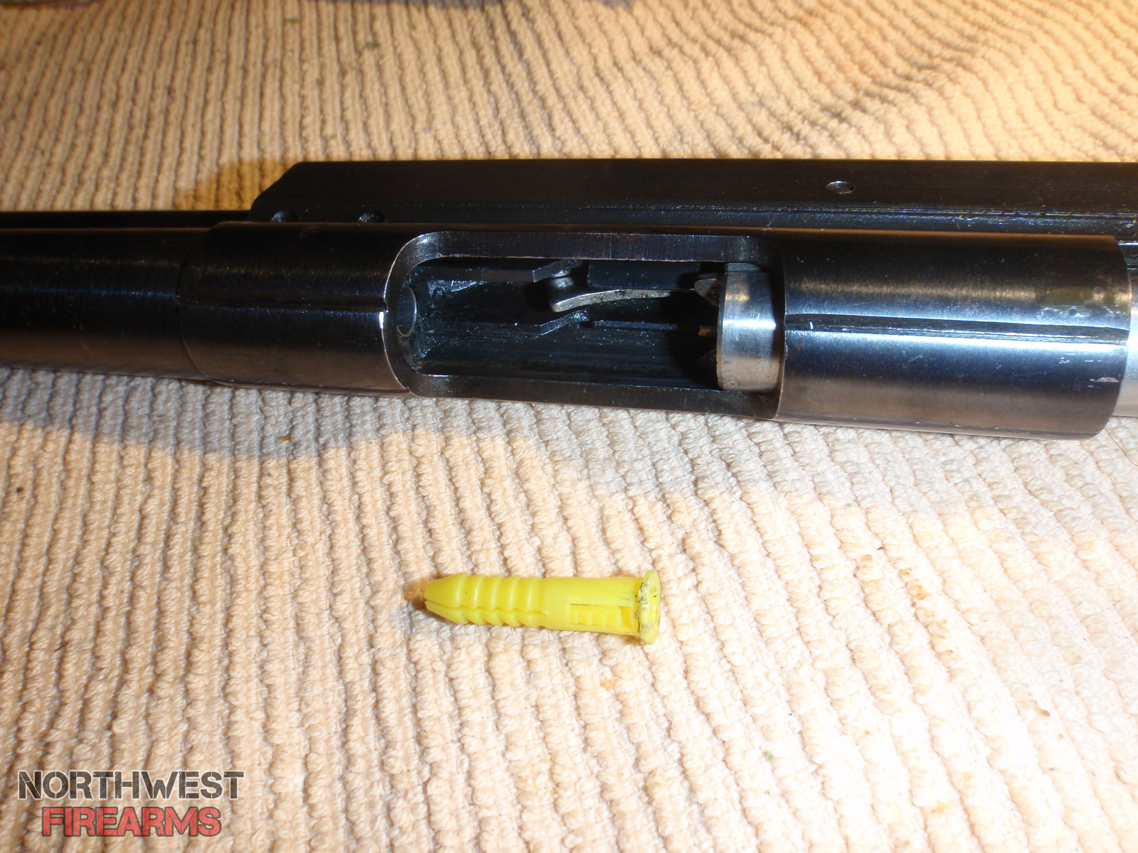

I get NO credit for this. It came out of a recent gun magazine (and if I could remember which one, I'd say so.) Such a great Idea, I felt compelled to pass it along.
Need a snap cap for your .22 without buying a "real" one? (For testing function, trigger adjustment, etc.)
Drywall Anchors! (I think the article specified a "Number Four", but the first one I found in my household hardware "junk drawer" was perfect.)
Chambers, feeds and ejects just like live ammo ( I did NOT attempt to run it through the tubular magazine of the Remington 512 I'm working on, since that portion of function needed no testing.)
Maybe this idea has been around forever, but I was unaware, and tired of feeding fired brass into the chamber (a pain in the butt) to test trigger pull and function. Cushy vinyl to treat a rimfire firing pin gently, and zero cost.

Been doing this for awhile. They still get beat up but it takes quite a bit longer than the hard plastic snap caps - which deform and start having feed issues because of those deformities rather quick.

Been using the yellow #4 drywall anchors for several years in my rimfires. It is a good tip.
You can test ejection, keep from deforming the metal on your chamber opening from a firing pin strike and basically use them as a safety snap cap.
They will deform after repeated use and I have once or twice torn the circular edge of the opening offthe anchor leaving the sleeve on the chamber as an obstruction but this is the rare exception with normal usage.
I always keep several in my range bag, gun bag and gun tool box.

So had I until now. Some chambers (as the 512) are more difficult to reach with adult fingers, and the line-up must be near perfect without a bullet as a guide to start into the chamber.
Being honest, I typically use a punch or some such to line things up as I agree about the fingers issue. Fortunately for me, my S&W model 41 allows me to take the whole barrel off for clean access. Pretty handy.
I have some rimfire chambers that I have to line up the firing pin strike on the brass with the notch at the top of the chamber otherwise they do not easily insert all the way. If I push them in all the way, then I am assured of needing a knife blade to remove them.
I do not have this problem with the yellow #4 drywall anchors. They slip in and come out easily without other complications.

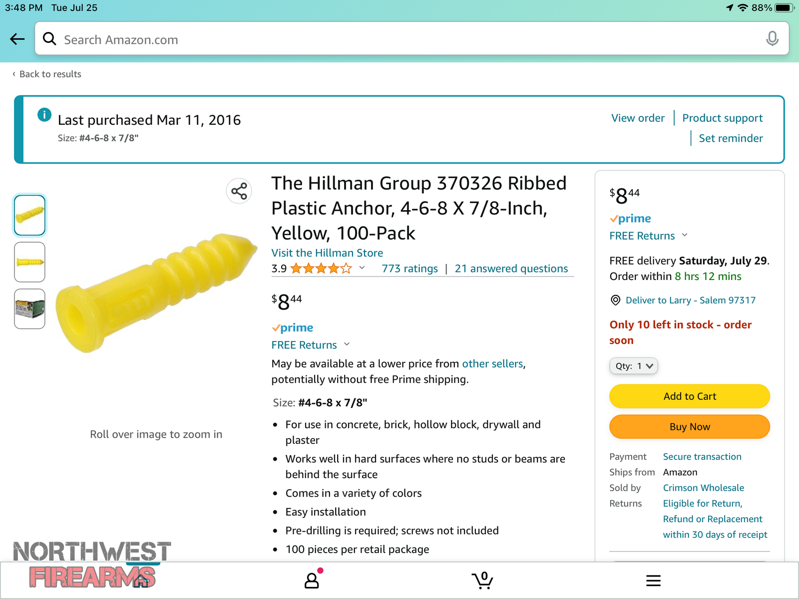

If you buy them on Amazon here are the ones you want. I bought a box of 100 in 2016, and I probably have 80 of them left. They go flying when you eject them and are pretty easy to lose. When I die whoever cleans out my apartment will find a bunch of 'em…

This has been in wide circulation for many years. I myself have recommended it on here numerous times. Yellow works for 22lr, white for 22 mag.
Home depot also has the yellow and white. Was about $3.89? I think for 100 last them I bought them there.
