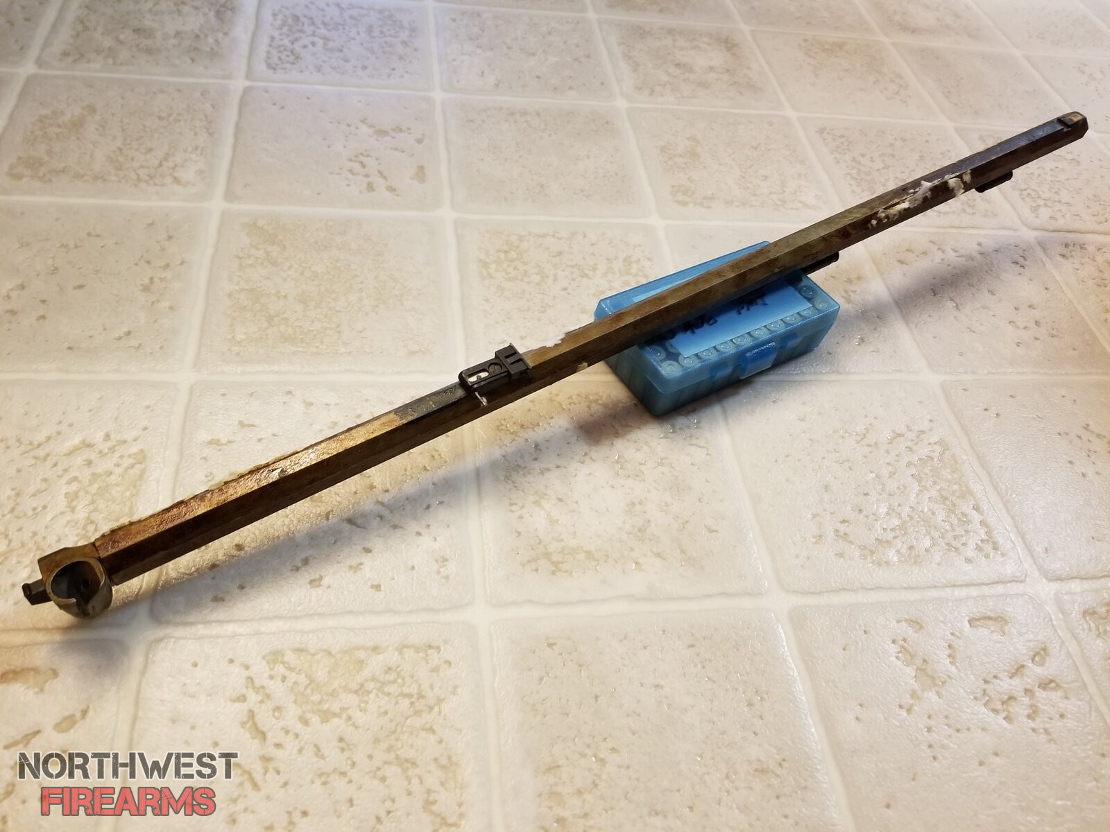

I ran across an NOS Dixie Gun Works barrel that was my dad's (.45 cal., 28-3/4" octagon, percussion, listed as "Made in Italy" and a P/N # 0330). I found nothing on the internet so far for this barrel and Dixie hasn't been too helpful telling me what rifle style this was intended for. I'm guessing Hawken at a minimum. The color seen on the barrel is not rust but is whatever protectant they used. It was then wrapped in some type of soft paper-like material that is stuck on the barrel in a few locations. I made no attempt to remove any of the grease or paper at this point. I also found a complete set of hardware and a separate (extra) hammer assembly listed as for a Hawken.
I'll be posting these soon along with (separately) bullet molds, lead melting pot, a few round balls in various diameters, shooting bag with Misc supplies. Just trying to put final details together now as to what style rifle the barrel is for. If you have any thoughts. please let me know.

"Hawken" ...is a often over used term.
A Hawken rifle could be a Christian Hawken late period flintlock Longrifle...very ornate and carved with a highly figured maple full stock.
Or...
A light caliber ( around .36 - .45 ) half stocked hunting rifle made by the Hawken Shop in St. Louis....for the local trade....
Or...
A large caliber ( .50 - .58 ) full or half stocked rifle for plains and mountain hunting....
Made by the Hawken shop in St. Louis....or by the owners after Sam and Jake...like William Watt , Tristan Campbell, J.P Gemmer....
Not all Plains rifles are "Hawken Rifles".....even if they are somewhat similar.
With the parts shown...
You look like you have the makings of a fine half stock percussion sporting rifle....not a "Hawken" Rifle.
.45 caliber is a little on the small side for most historic Plains Rifles...most , historically were in the .47 - .58 caliber range...
But .45 caliber was not unheard of for a Plains Rifle.
All that being stated..... A well balanced .45 caliber sporting rifle , makes a fine hunting rifle for deer and small game.
The boxed AP is a date code...in this case...1986
The lock and furniture may be marketed as for a "Hawken" rifle...but it ain't likely that any historical , as in original Hawken Rifle used something that looked like that.
Andy
