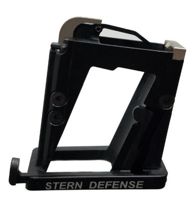

My recommendations are the following:
1. Dedicated Glock lower (9mm, then .45)
2. Stern Defense adaptor (Glock, then the M&P version if you are a die hard M&P guy like me)
3. Endomag conversion if you want to stick with a standard AR lower. The kit replaces the spring and follower in the Pmag. The conversion requires no permanent modification to the Pmag and can be swapped back and forth at will. Just pull the guts from the Pmag and swap in the Endo 9mm kit.complete Pmags with the kit installed are also available from Mean Arms.
