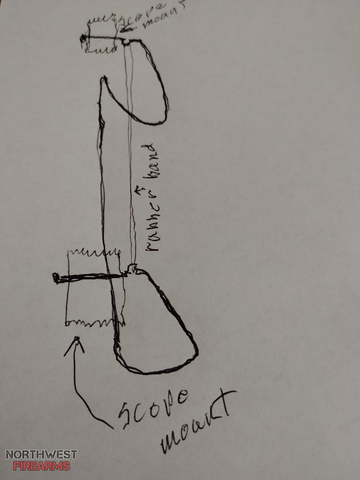

Modify your loop so that it bends down to below the ejection port. Drill a hole for each side of the loop in the scope mount. The little loops on the ends of the wire loop will catch on the far side of the scope mount and keep it from sliding out of the holes in the scope mount. The rubber band keeps tension on the loop so the ends won't slip out of the holes... but you can spread the ends apart and remove the catcher easily. No set screws or other retaining device other than the rubber band will be needed. I think I would try aluminum windows screen for the catch bag. Nylon screen might melt from powder gases.
Just a thought.
I tried to make a 3D drawing so it will probably take a bit of staring at the picture to understand the perspective.
I get it, but it is a solution to the worry of losing brass.

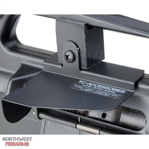

A deflector might be an easier solution. That way you won't need a net and or a bunch of stuff stuck on the side of the gun. Something that allows ejection, but better directs the brass straight down.
Like this but angled down. Won't catch it, but it won't go too far.
Yah, something like this angled, as you mention & just leave it be.

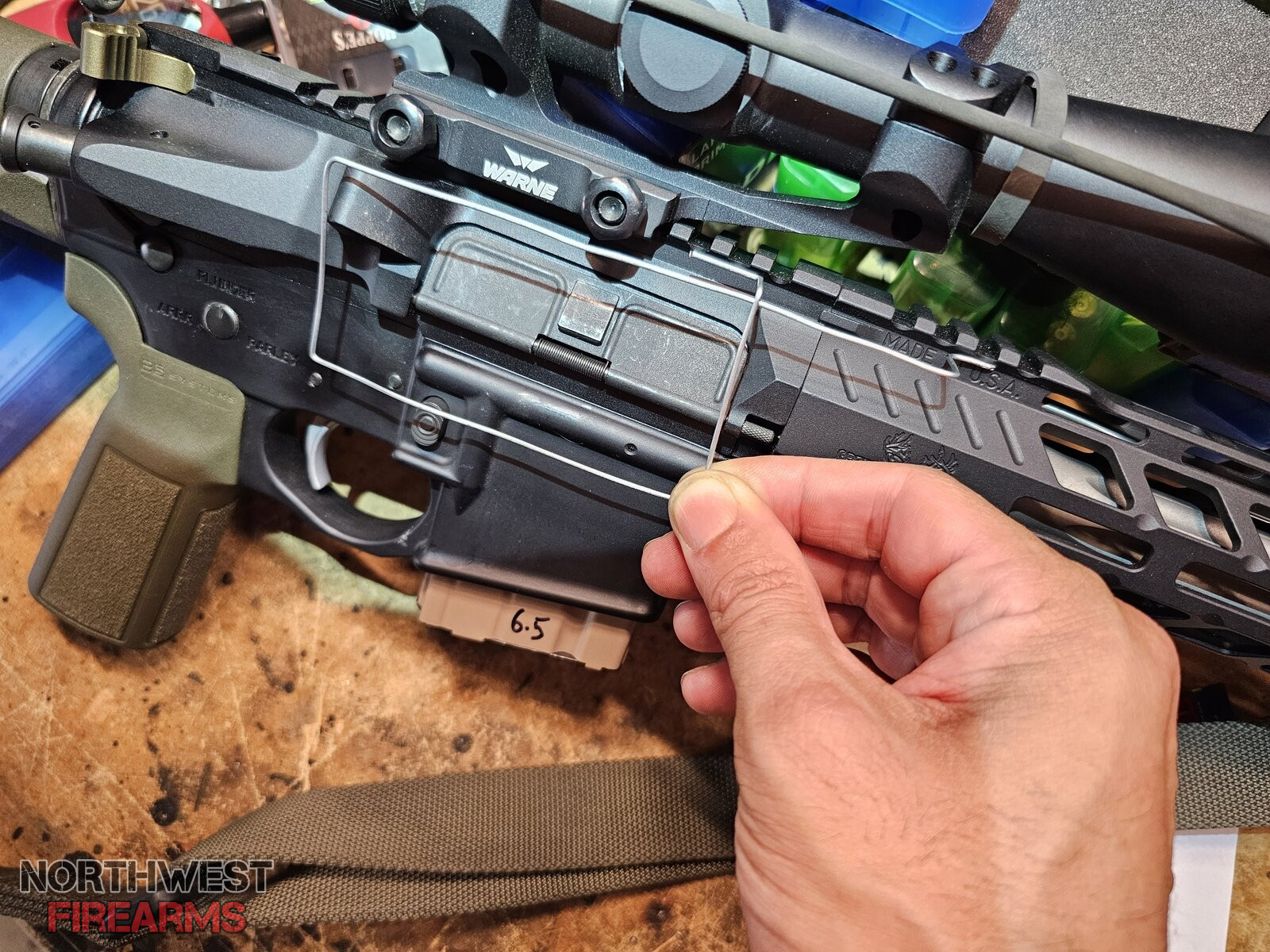

I dont have any coat hangers but played around with some soft bailing wire, I think with the wire holders Reno suggested this could work.
That said, after a visual, I'm not certain its worth it for 1 or 2 pieces of brass, especially cheap Starline brass because I can see now this would block access to the chamber Im not liking the idea of something like this that isnt removable without tools.

This is what i was thinking after my mock up wireframe above. Ill see if i can still find my old caldwells catcher but never liked that design.
Not certain this project is worth the hassle....

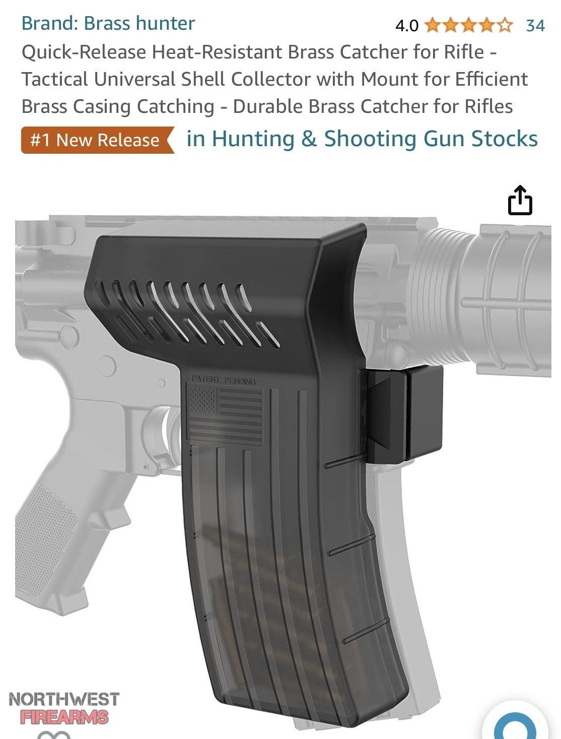

I noticed Amazon has a hard plastic one also that is low profile. The problem though is it's very long. 2 possible issues I see hunting with the hard plastic one would be noise of empties rattling? and would it get pushed off too easily when going through brush? But length by itself may be a show stopper I dunno.
On the plus side the low profile and hard plastic may reduce snags compared to
mesh maybe.
I suppose a person could cut off extra length at the red line then use urethane glue (like for windshields)/other? to glue on a new bottom.
To me thats still too bulky. My Brass Goat has the short mag hopper and would work but I think it protrudes too far out the side. Agree it would be snag free compared to the mesh cloth option.
