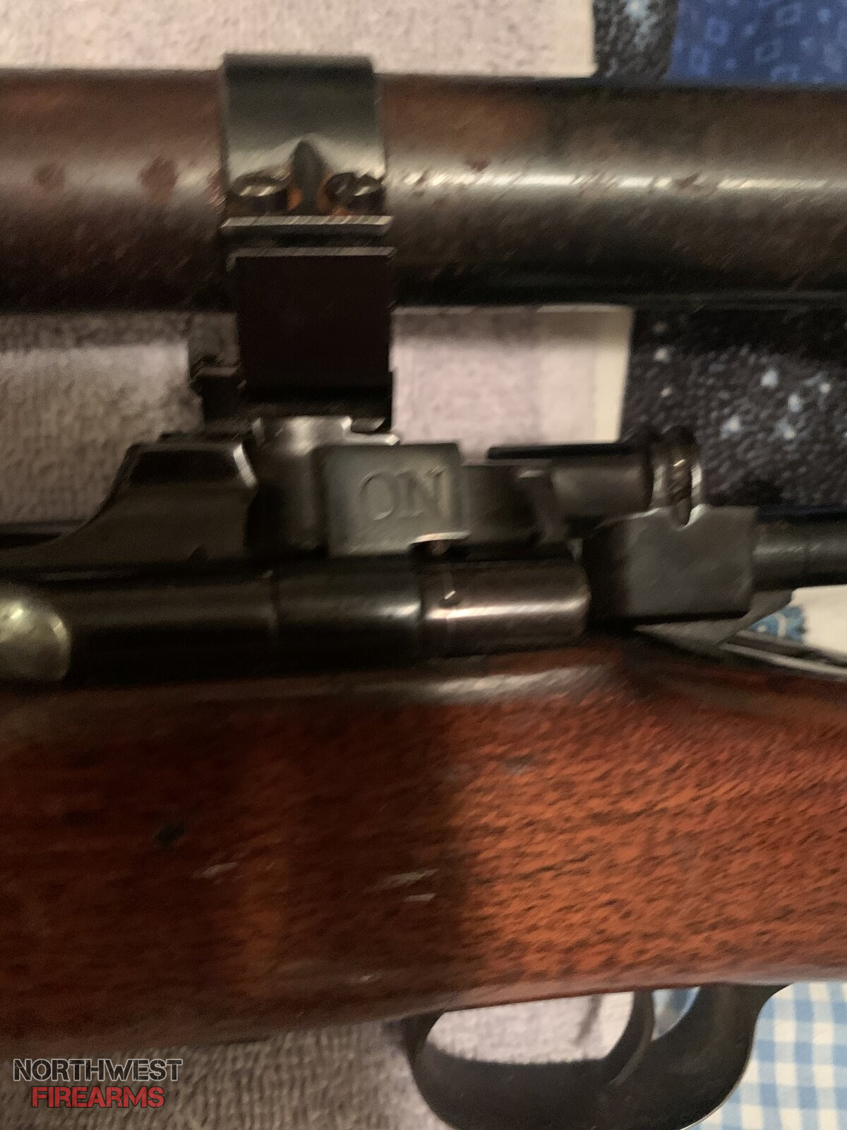

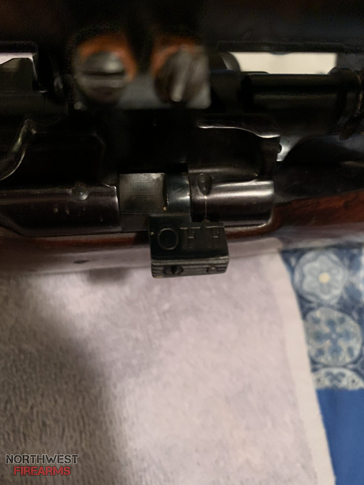

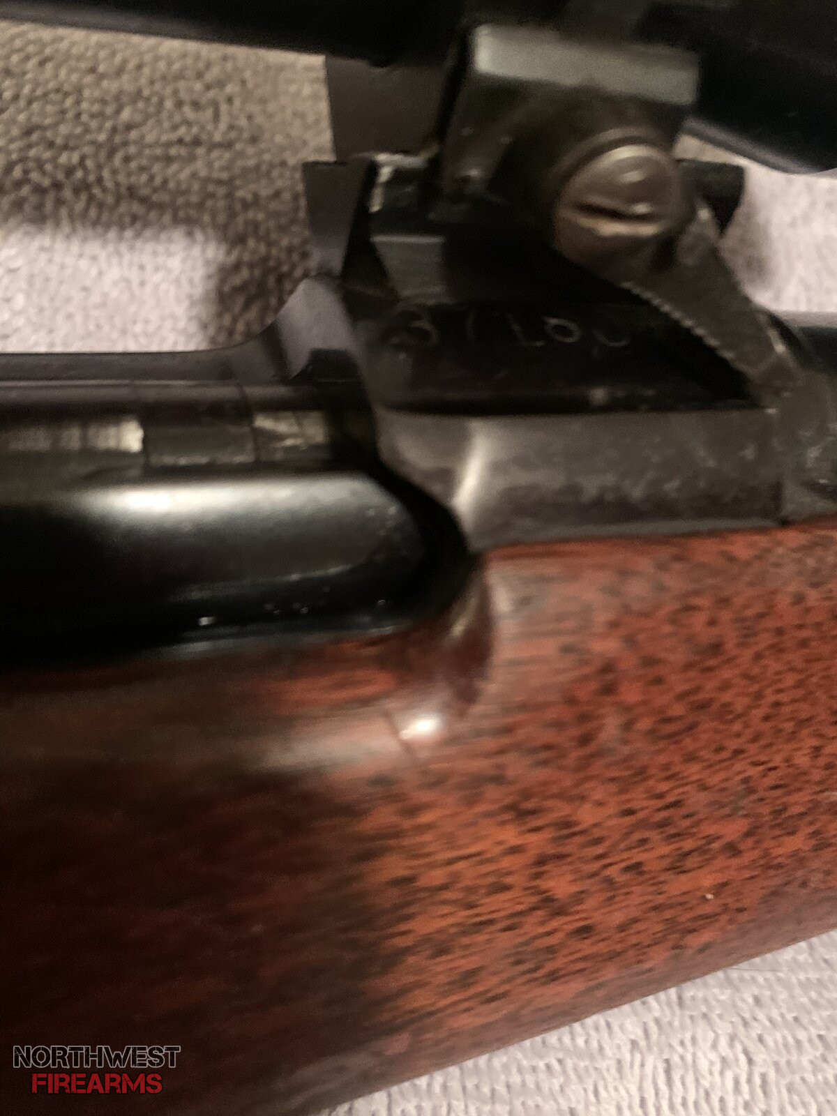

Grandpa wants me to post it for sale. I know it's a 30-06 but that's it. Curious if anyone on here knows. I think their pretty common cuz a buddy of mine just inherited one but also doesn't know make/mode. Looks like s/n is under scope ring. "on" and "off" for bolt removal. I believe you top load the ammo. Doesn't appear to have a manual safety.

Looks like a "Sporterized " 1903 1903A3 Springfield rifle.
The "On / Off"...is a magazine disconnector ...it will turn the 03 into a single shot rifle.
The safety may have been removed so as to put scope mounts on the rifle....
The safety was located just ahead of the cocking piece / knob.

Yup, Andy beat me to it, it's a Springfield Sporter 1903 A-3, only thing we don't know is which factory built it originally!
Many of these had the Mag Cutoff pinned to the ON position so it would load from the mag with a scope mounted, and some have had the bolt stop modified to lock out the safety as Andy pointed out, you can tell if you cannot move the safety lever or if you have to pull the bolt cocking knob back a little in order to apply the safety! Other then that, it looks to be a nice Sporter Springer 03, but alas, not worth a whole lot!

That is a Norman-Ford & Co. scope, they were made from late 1940's to about 1960. It might have some collector value in spite of the surface rust on the tube. I'm thinking that the reason the scope is mounted so far to the rear is to allow for movement of the safety. Be careful shooting that, you might wind up with a ring cut in your forehead from the rear edge of the scope bell. I'm told it hurts when it bounces off your forehead.

Please read the following and then check your serial number.

Since this is a 1903-a3 there should be no issue with heat treating. Without being able to read the banner on the forward bridge most 1903-a3s have the rear stock screw hole drilled all the way through the receiver. It supposedly made manufacturing easier than the

The rear Bolt Stop Bridge still retains the A-3 Dovetail for the Rear Sight, here it serves a s a rear scope mount, which is pretty cool actually!
