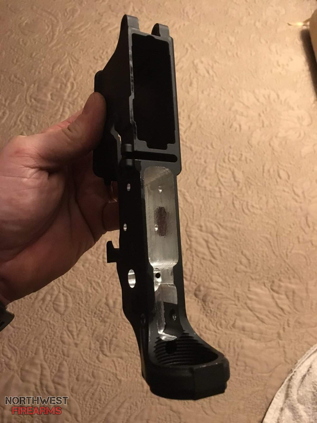

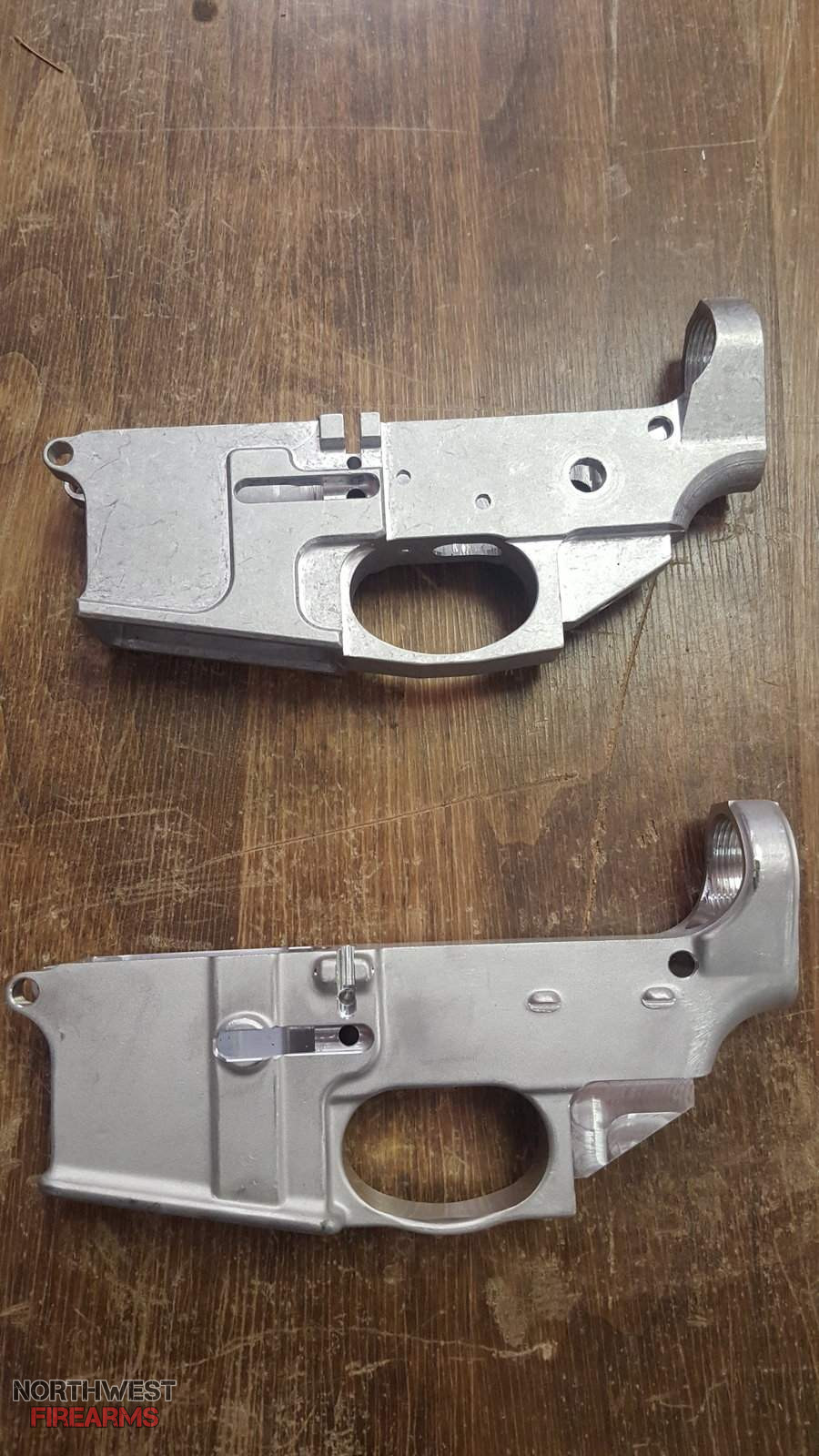

Here's a couple of 80% lowers with "pre-pockets" that I carved out with a 5D Tactical jig... as you can see the rear pocket area is milled out just fine, and having done several more lowers with and without the rear "pre-pockets", I have found that the initial fitment to the upper is actually a wee bit better w/o the rear "pre-pockets" and has less potential for side to side "wiggle" due to the dimensional tolerances when being forged.
One further note:
Do yourself a favor and get proper reamers and accompanying drill bits for the reamers, because just using a nominal sized drill bit for the safety selector and trigger pins will typically result in slightly "sloppy" fitment. It's not generally a problem (I use KNS dog bones and trigger pins) and it may actually be a "good thing" out in the field to keep stuff from potentially seizing, but if you're going to run an 80% Noreen through a jig I assume you're going to be looking for stellar "Swiss watch" results.
Hope that helps! :s0155:
