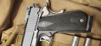

I've been collecting factory SIG 1911 barrels in different calibers over the last 4 years. Some of these have taken me nearly the entire time to find.
My goal was to have 1 gun in as many calibers as possible, each working without issue, accurately.
How it started:
SIG Sauer 1911 Nightmare 5" originally purchased in 40sw, with Wilson-Nowlin ramped barrel.
Using the 40sw slide as a starting point, I starting searching for a .357sig barrel as that should have been an easy conversion.
2 years later, I found one on ebay.
I next purchased a 38super barrel from CDNN on clearance, but didn't realize it needed a 9mm slide, so it sat in the parts box for a few years.
Next I was able to find a 10mm factory barrel, also on ebay.
Just this week I scored a new 9mm slide with classic contour, and a new factory 9mm barrel.
Current lineup:
Sig square contour slide: 10mm / 40sw / 357sig
Sig classic contour slide: 9mm / 38super
Wilson combat mags in 10mm will work for 38 super.
Wilson combat mags in 40sw work for 357sig.
Wilson combat mag in 9mm.
I use a 24lb Wilson combat flat wire spring with shok buffer for 10mm/40/357sig.
I purchased a 15lb flat wire spring for 9mm.
The remaining sights/springs/parts to finish the 9mm slide will be here in the next week or so.
Photos show the groups at 20 feet.

I dropped off the parts at a local 1911 Smith to fit some wilson combat parts, install the sights and external extractor.
In a couple weeks I should be able to pick it up and go test the 9mm and 38 super barrels.
If you can find me a Wilson-Nowlin ramped 45acp barrel, I'll buy a spare 45acp slide.
Not sure about the Sig you have but most 10mm's use the same slide for 45 acp. The 357 sig/40 S&W is generally the same slide and the 38 Super and 9mm is it's own. On thinking about it a little deeper the 10mm, 40 S&W and 357 Sig would use the same bolt face so one slide would work there.
Exactly- my 40 slide works for my 10mm/357sig/40sw and my 9mm slide works for 9mm/38super.
I would probably dedicate a 45acp slide if I went down that path.
Finished the 5 caliber 1911 project today.
Didn't get a chance to test the 9mm or 38super yet, but hopefully tomorrow.
The new Wilson combat bushings, barrel links, adjustable sight, and external extractor are all installed thanks to a very talented local gunsmith near me.
I did shoot it in 10mm today to function check and was extremely happy to see the accuracy.

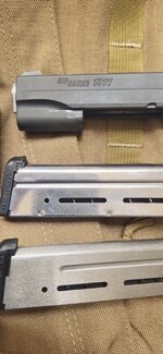

TLDR Summary of parts:
Slide#1
9mm SIG slide.
9mm SIG barrel with Wilson Combat link.
38super SIG barrel with Wilson Combat link.
15lb Wilson Combat main spring
Wilson Combat Bulletproof guiderod, bushing and plug with Shok buffer.
EGW external extractor, pin and spring.
Kimber adjustable sights.
Wilson Combat 9mm firing pin and spring.
SIG firing pin stop and plug.
Slide#2
40sw SIG slide.
40sw SIG barrel.
357sig SIG barrel.
10mm SIG barrel.
24lb Wilson Combat mainspring, Bulletproof guiderod, bushing and plug with Shok buffer.
Factory SIG slide internals.
Wilson Combat 500-9a 9mm Mag
Wilson Combat 10mm Mag
Wilson Combat 40sw Mag with rear spacer.
