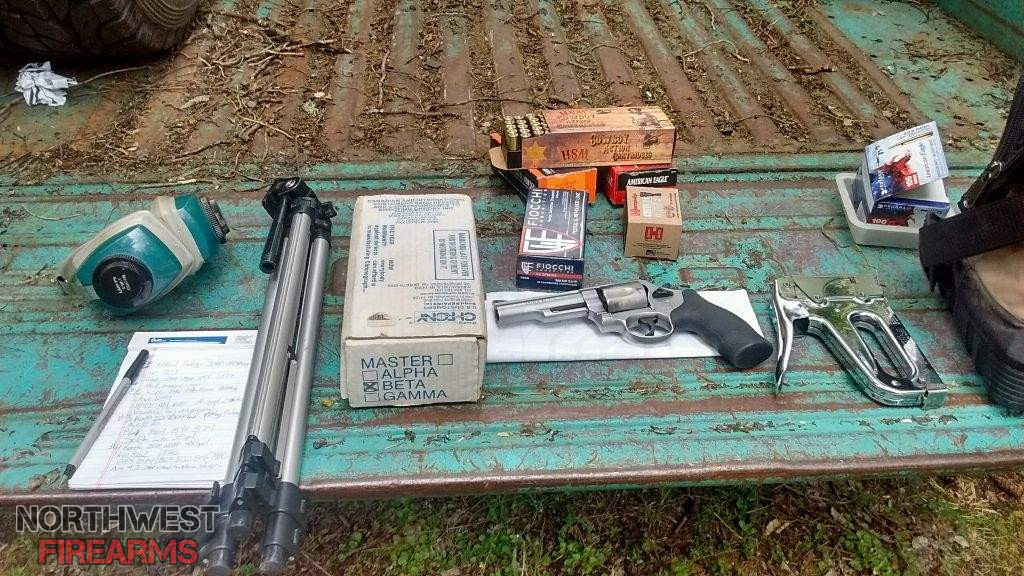

Before buying dies I rounded up a selection of ammo to shoot, test and generate some brass. Previously I'd shot a box of 300gr cast from a small reloader without chronoing any. I believe he told me they were 22gr of H110 and ran 1300fps out of a 7.5" Ruger. They were stout. More than I want and the reason for this thread.
What I came up with;
Ammo / Advertised fps / Tested fps (ave)
1) Federal 240gr JHP 44 Mag / 1230 / 1275
2) HSM 240gr JHP Sierra Pro Hunter 44 Mag / XX / 1099
3) HSM 200gr RNFP (lead) 44 Mag Cowboy Action load / 975 / 870
4) Fiocchi 200gr SJHP 44 Sp / 900 / 862
5) Hornady Critical Defense 165gr FTX 44 Sp / 900 / 1023

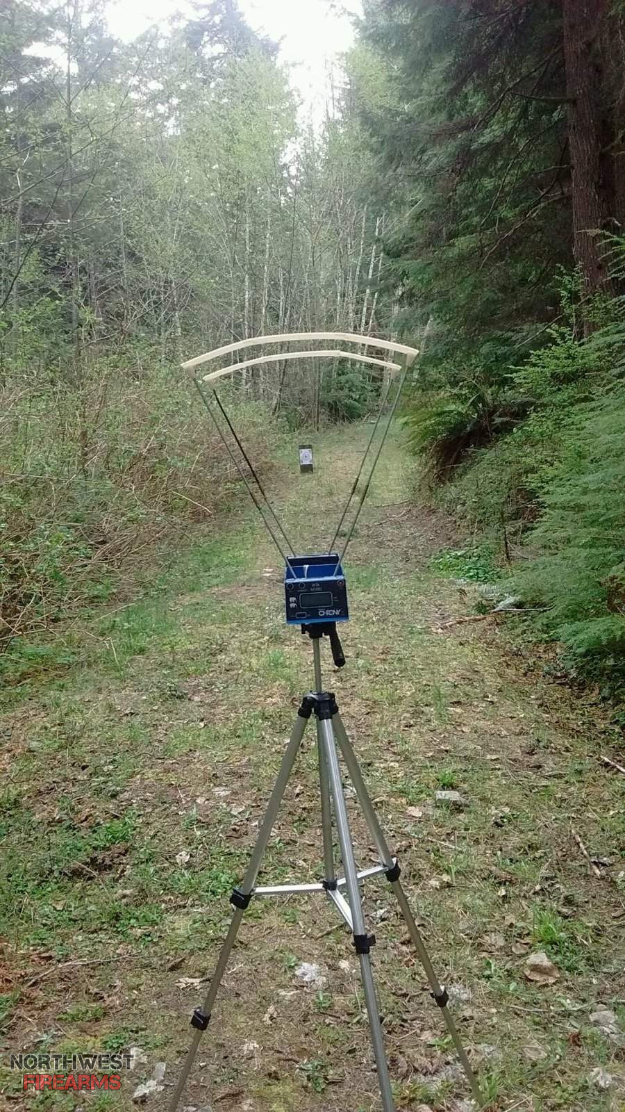

I use a Shooting Chrony and set it up to be about 12' from the muzzle. HSM does not show velocities for the Pro Hunter ammo on their website. I find it interesting that ammo listed for hunting tests nearly 200fps slower than normal magnum ammo of the same bullet weight. All other advertised velocities were taken from the manufacturer's site or from the label.

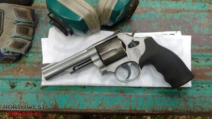

I wanted to set the chrono up Friday, but it was wet and foggy when I was ready to shoot, so I decided to pop off a few rounds of each just to see what I'd spent all of my money on, then head home. I shot five rounds of each, then shot another 10 of the Pro Hunter because it seemed like it's the "level" I'm after, no matter what the chrono was going to say. It's stout, without recoiling so sharply as to tear the skin in the web of my hand, like a half a box of the Federal will, and I can shoot it reasonably well double action. I actually guessed it to be about 1100fps, basing my opinion on what the other's advertised velocities are and how they recoiled.
Better weather yesterday allowed me to set up and shoot! I started with the Federal and worked my way down. The Cowboy load and the 2 44 Specials are soft enough shooting that I can let others that aren't used to heavy recoil shoot this gun and enjoy it, but I doubt that I'll be loading up many rounds in this velocity range. I did burn thru the Cowboy loads shooting up a couple of 16oz cans. I see why many shooters like a 44 cal bullet in the 8-900fps range, it's easy to shoot, but I want a bit more than that.
One round of the Fiocchi required a second primer strike, but was very accurate in this gun.
Just because I now have them, I filled the cylinder with the Critical Defense for the trip home. I think I will save them for "city duty".
To the point of the thread, Magnum cases ARE what I need. I'd need to stretch the Special pretty far to get where I want.
With a Sierra 240gr JHP and some Unique, I think I can duplicate the HSM Pro Hunter load easily. That oughtta do it.
I did find that taking the edge off of the recoil really helped me shoot this gun accurately, and that always makes shooting more fun. Now I don't regret buying this gun instead of another 686+.
