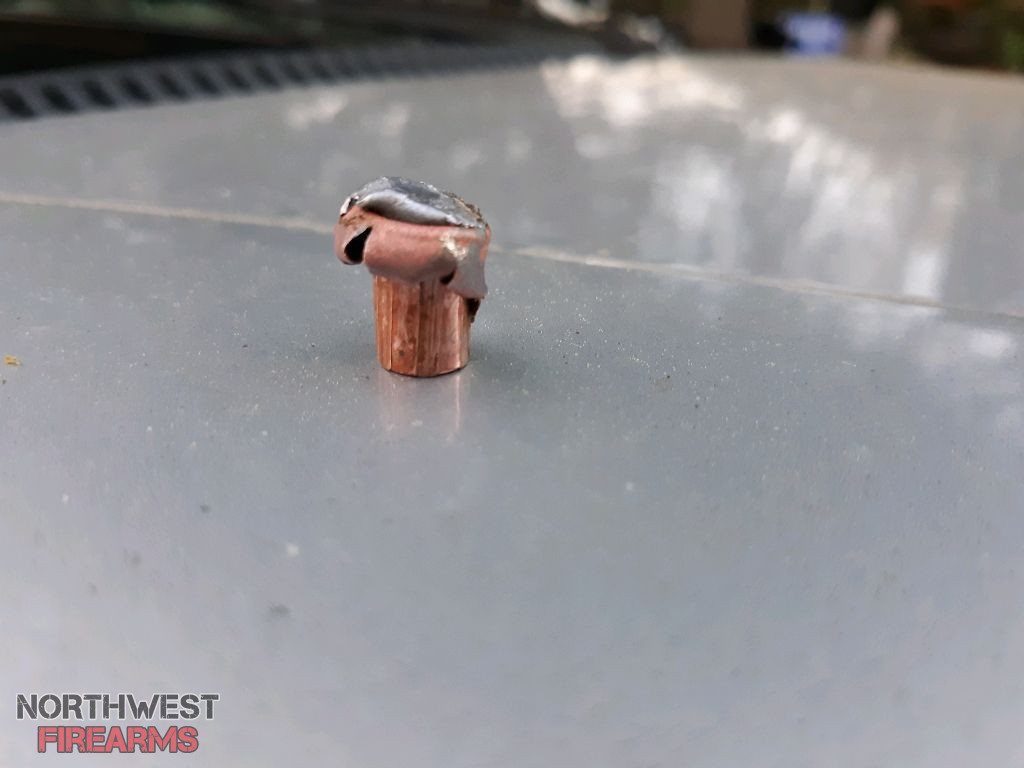

Here's a 170gr Coke-Lokt after it went through a shoulder blade and 23" of deer.
...AND LANDED ON THE HOOD OF YOUR TRUCK!
