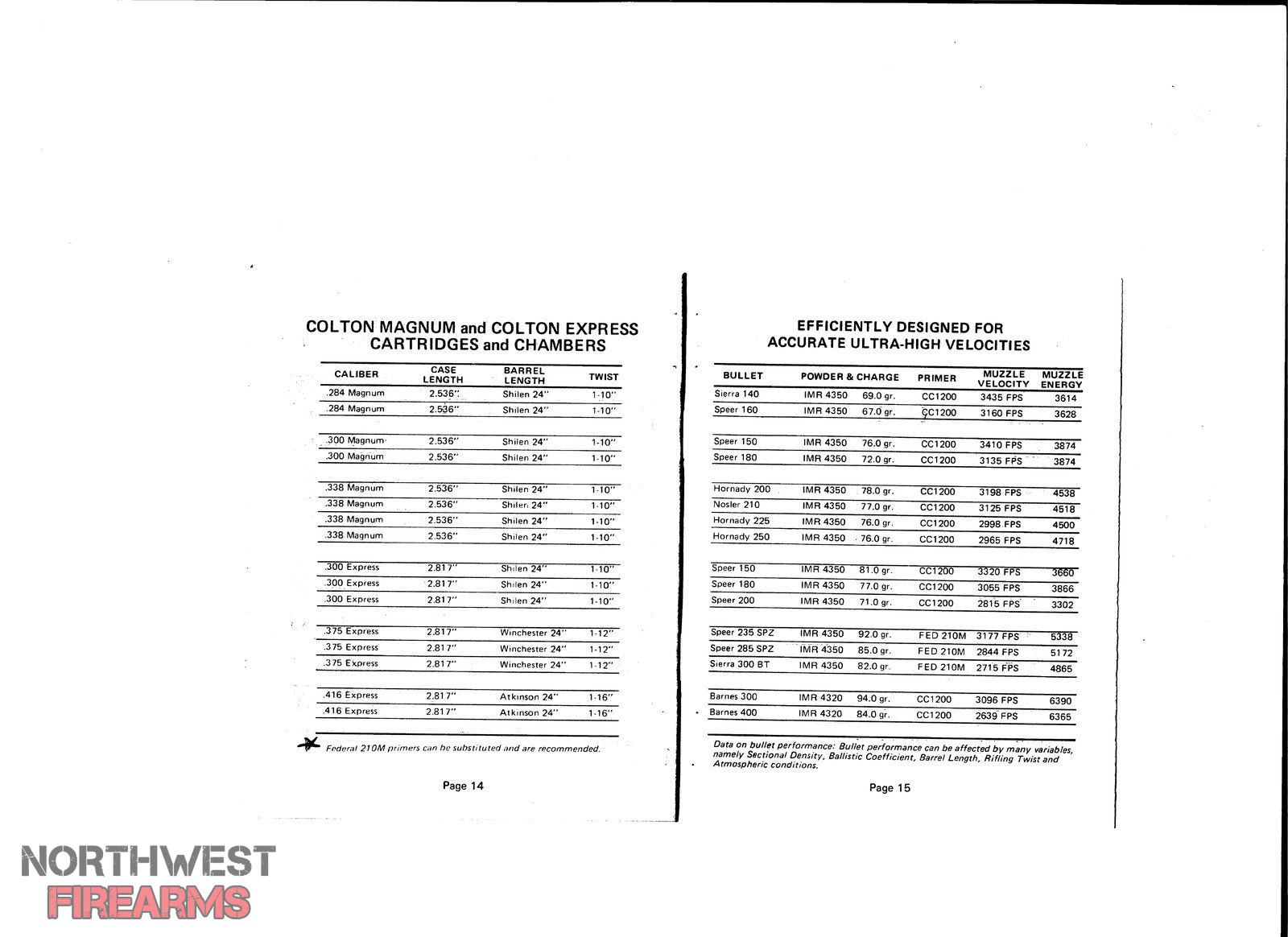

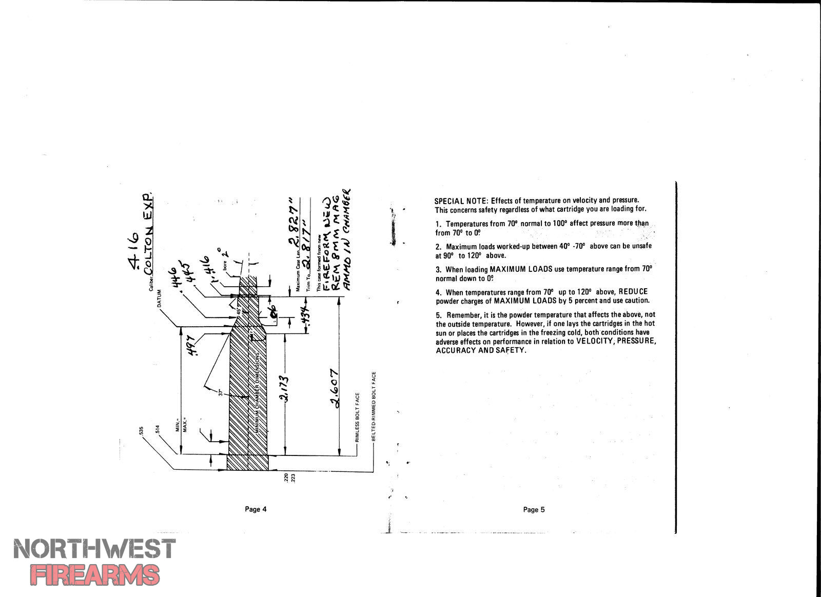

Well fellas, I hit the veritable jackpot since my post on the .257 Colton. I found the reloading dies for this and 2 other Colton rifles I have. Inside the dies for the .416 Colton Express, I found a 4" square booklet with a lot of the information I needed. Granted it would be helpful to have this booklet for all 3 rifles since this shows case measurements too. But, I can get what I need from this. Just in case any of you have or run across a Colton gun shop prepped rifle, this may help you as well. I'm not sure how many pages I can attach at a time but I guess I'll be finding out. I guess these will have to be clicked on to open them up.
GS
"MAG-NA-PORT recommended."

I'm not sure but I believe Colton was his last name. His shop ran at least into the 80's given the .416 Colton Express that this booklet was for is hand-signed and dated 1984 along with hand-written notes on the fire-forming process. I also have the RCBS booklet that the Colton booklet references for reloading.
