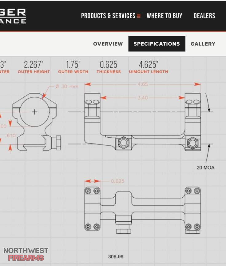

I have been going over unimounts for the last several weeks for my .308 Tikka, and decided on a Badger Ordinanace kit. Looking at the photos in the OP, it seems to me that although the mount looks "cool", there doesn't seem to be a lot of mounting contact to the rails, and the forward arm and scope ring seem like they would be subject to flexing/deformation as well.
The below drawings are of the kit that I chose, and illustrate what appears (to me anyway) a more robust design... just a thought.
