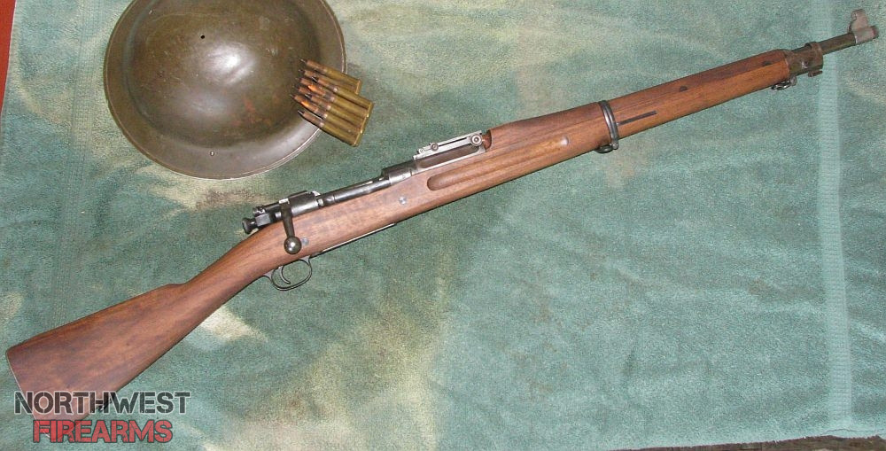

I have a M1903 made in Feb of 1918 The serial number is 779*** it falls in the weird era of after the faulty heat treating rifles were made after they started using Pyrometers to verify heat treating temps but before the Double heat treating profile came into use at serial number 800,000. I bought the rifle as a Sporterized hunting rifle. But nothing had been cut except the stock and parts removed so I sourced the missing parts and then Modified a Boyds stock to the original spec's including the finger grooves. It came out pretty good.
The guy I bought it from and his dad had used the rifle for deer and elk since getting it before WWII He gave me a couple boxes of what they had been shooting in it. Remington Cor lokt 180gr He said they had shot dozens of boxes of it over the years. I have no doubt its safe to shoot.
