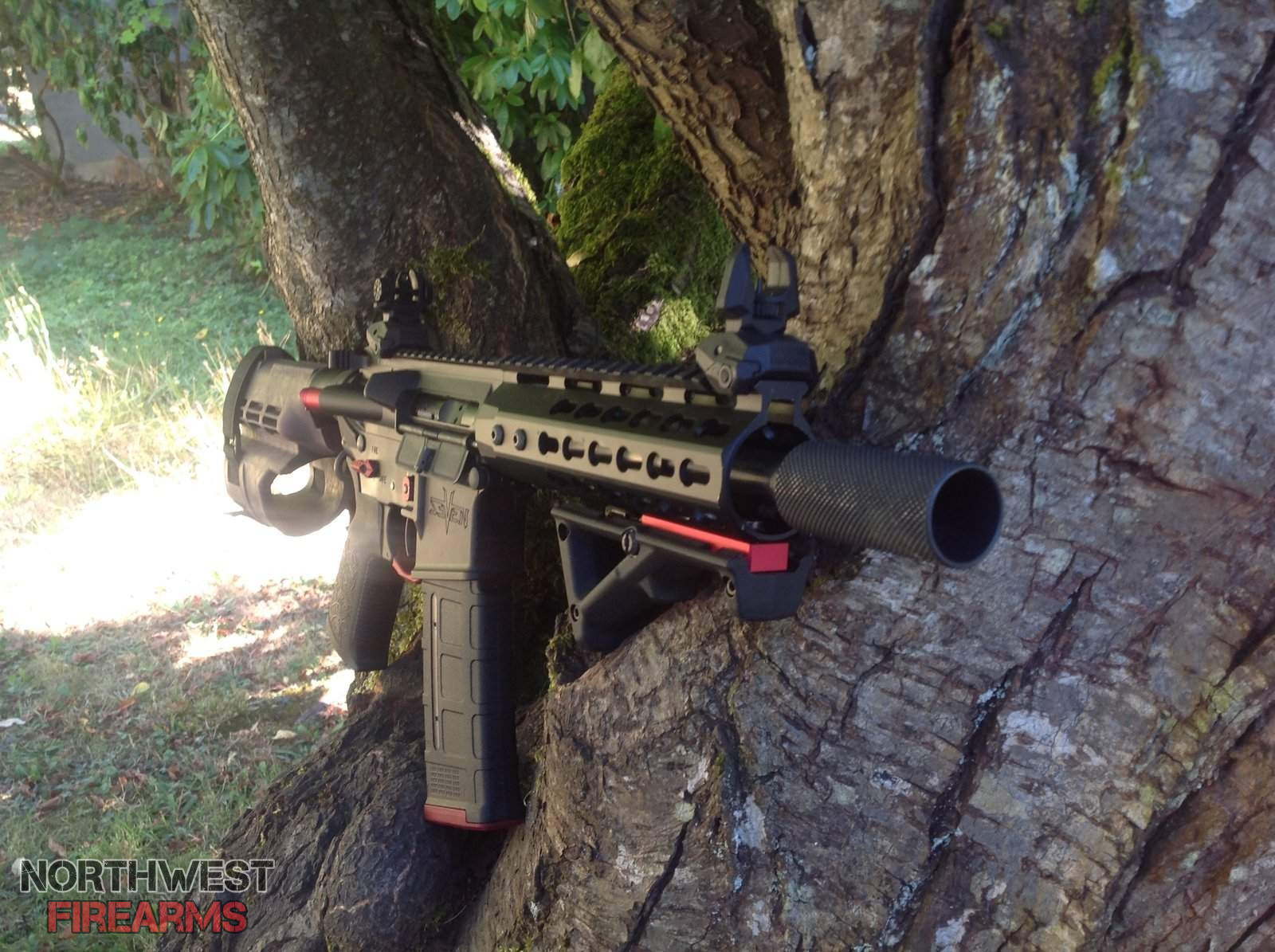

They make it so easy... "Literally all you need is a barrel" they said. So I scraped together enough parts to put together a pretty decent little AR15 pistol in 300BO that I lovingly dubbed "The Black Widow"...
She has VSeven forged recievers, an 8.3" Balistics Advantage Hansen barrel melonite coated with 5R rifeling guaranteeing sub MOA accuracy, a Noveske BCG, a Sig SB15 arm brace on a KAK super sig buffer tube, and she's covered in red colored billet aluminum "enhanced" parts from Strike, and Seekins, giving her unique aesthetics, and superb performance... she has a magpul afg, and a spikes pistol grip adorned with spiders to help pull the black widow theme together...and she's still attracting new and upgraded parts and accessories as time goes on. I know her gaudy red accessories are not for everyone, but she makes me happy.

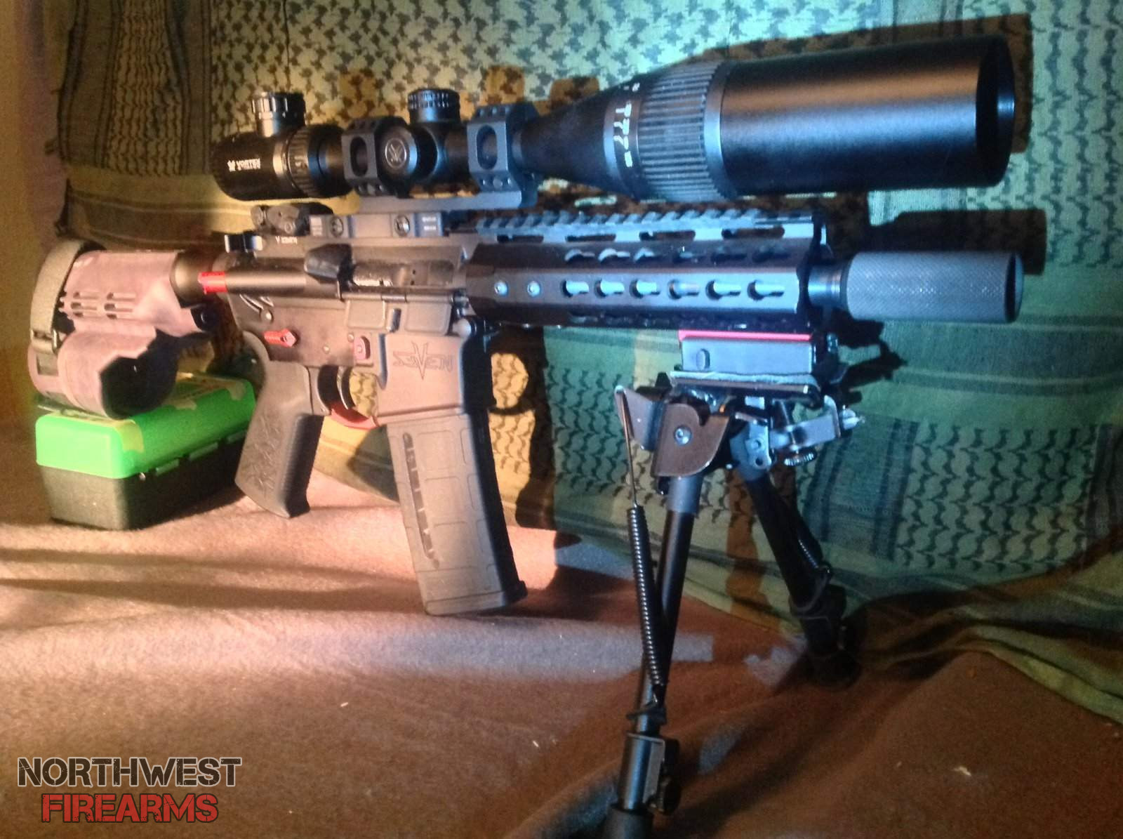

Since I was going for accuracy, I robbed my poor spr of its scope, mount and bipod leaving her all but nekked... just looks wrong like this. IMG_3226.JPG
but the black widow looks silly too all dressed up like a big girl...

Since I was going for accuracy, I robbed my poor spr of its scope, mount and bipod leaving her all but nekked... just looks wrong like this.View attachment 394049
