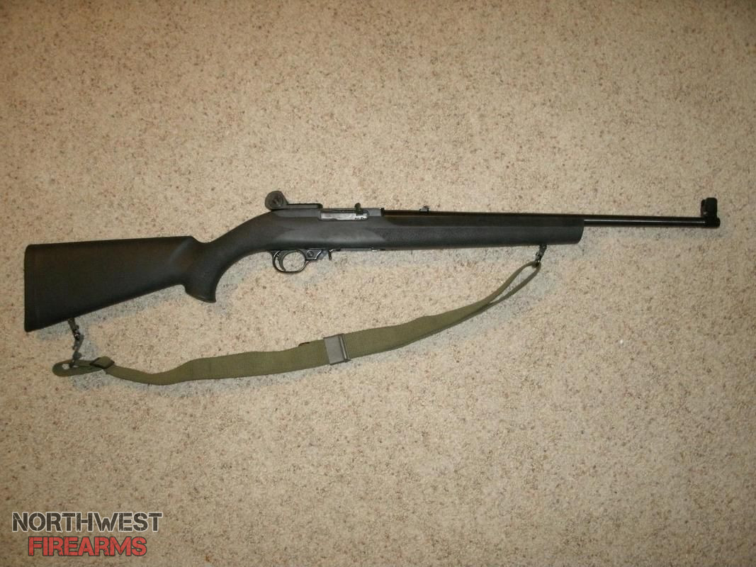

I've never participated in an Appleseed event though I've built my own Liberty Training Rifle. I started with a plain Jane Ruger 10/22 Carbine. Then, I replaced the hammer/trigger parts with a kit from VQ. I had a Green Mountain barrel and Houge Overmould stock so, I used those parts. For a sling, I used an old GI web sling. As for the sights......I used the Tech T100 sights. Though kids now a days seem to prefer a red dot. And since I'm older now, perhaps I'll be switching to a red dot too?
I thought I had a picture of my build somewhere but, can't find it just this moment. Maybe, I'll post it a little later.

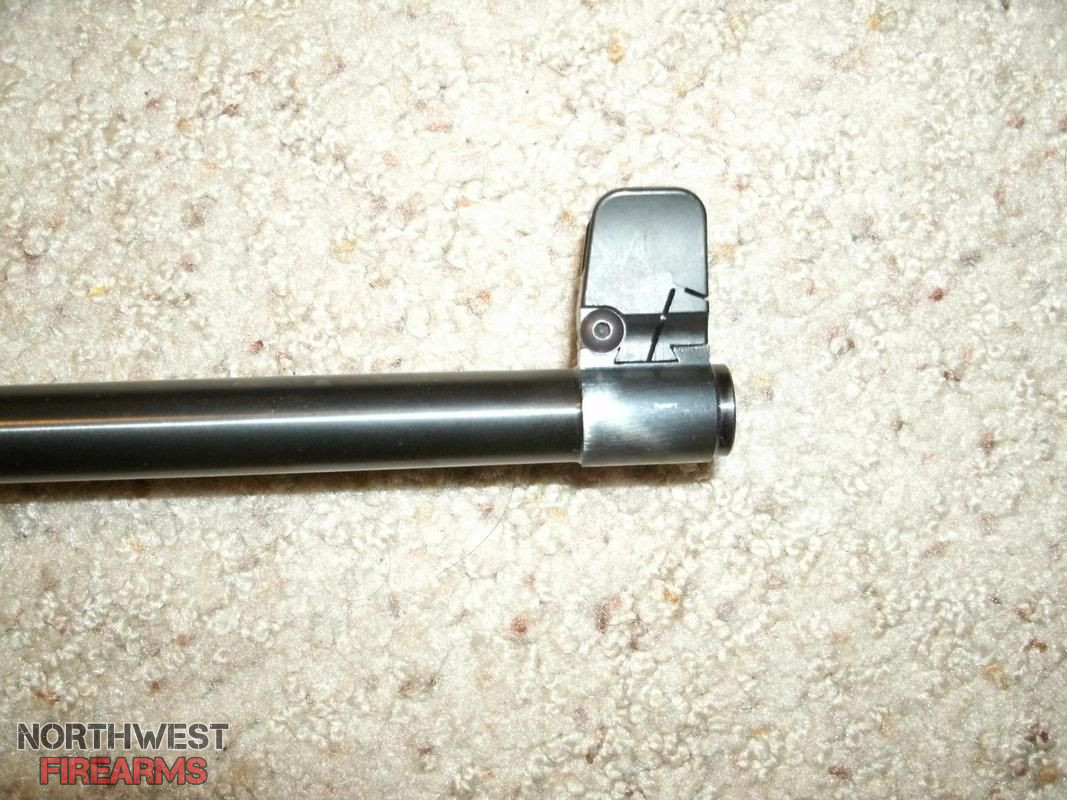

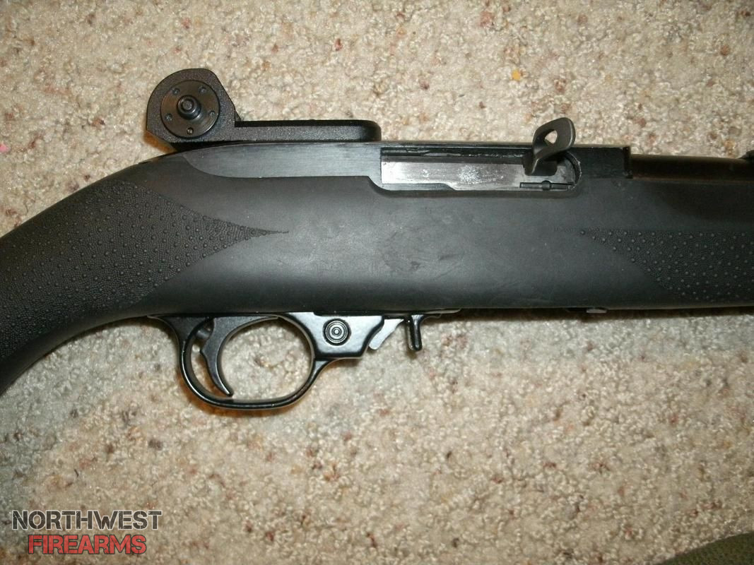

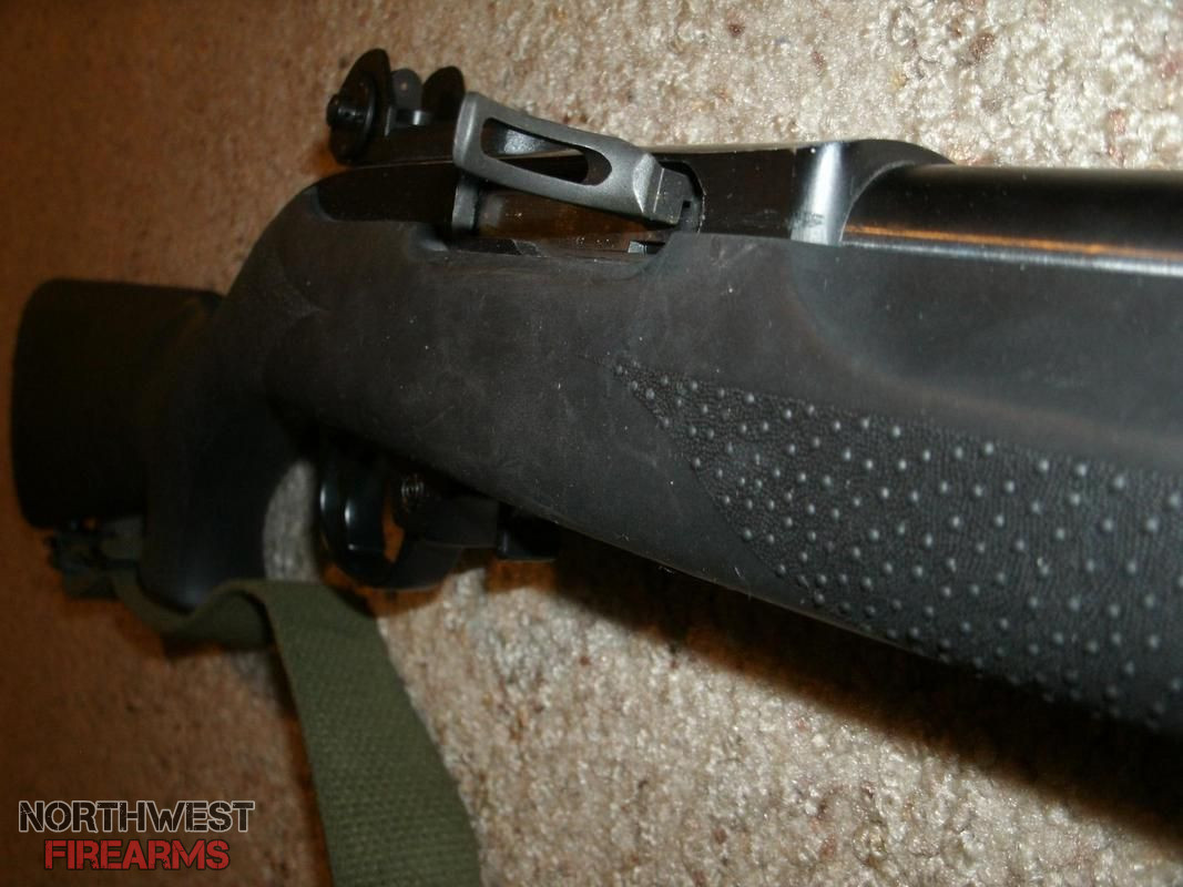

OK...... I took new pictures of the Liberty Training Rifle. Seems that I removed the heavy barrel sometime ago. I guess it was about the same time that I removed the scope rail. Oh well.
IIRC...that op handle came from Ruger.
Aloha, Mark
