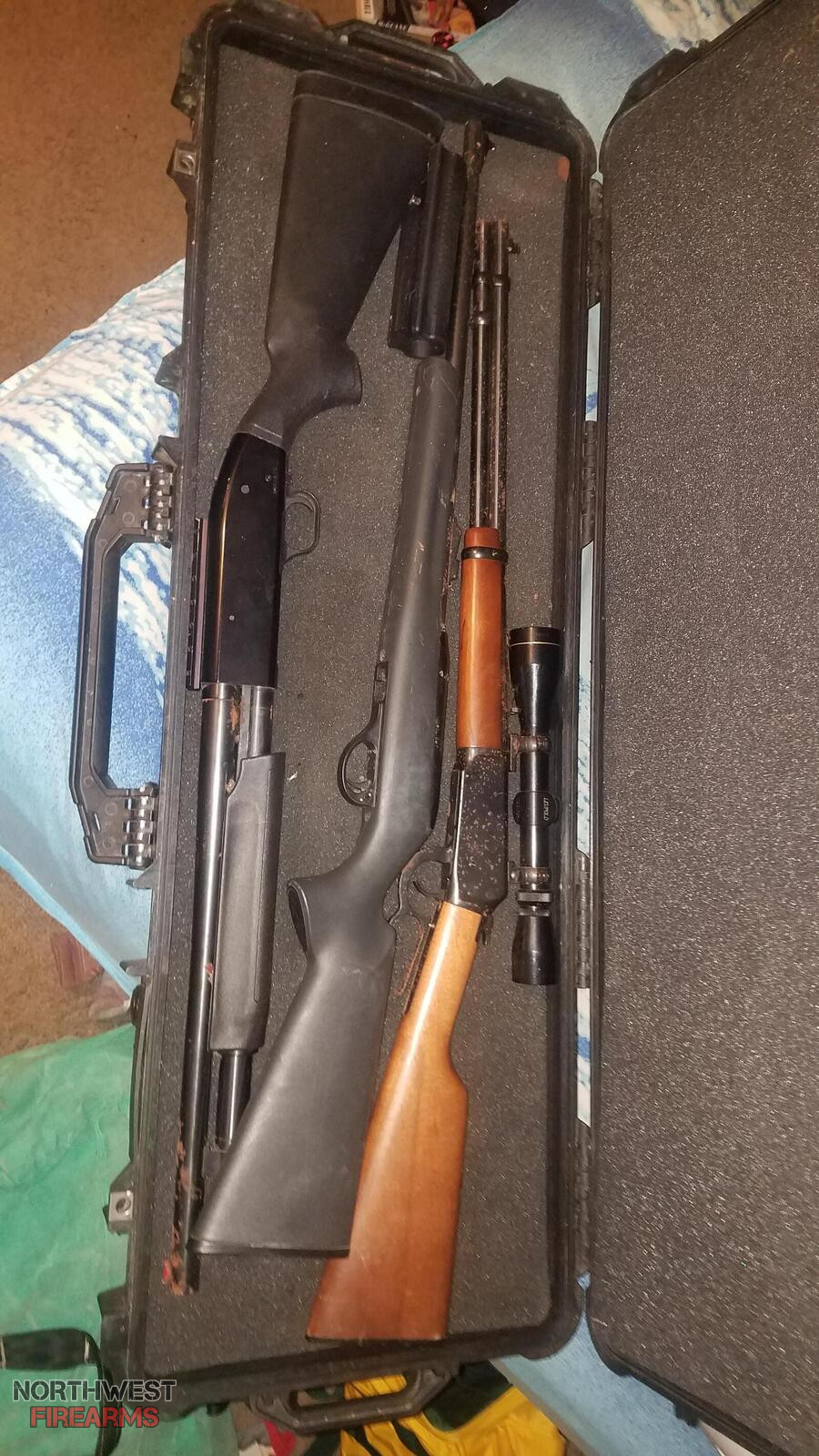

The guns I brought home today, I finally got to ID thanks to some light cleaning and good lighting - and a little Internet sleuthing. I now have a Winchester 94 Ranger - not sure if this was made in the mid to late 90's, or right up till Winchester shuttered her doors in 06. I'm guessing late 90's. The other guns I wound up with tonight are a Mossberg 500 and a Remington 597.

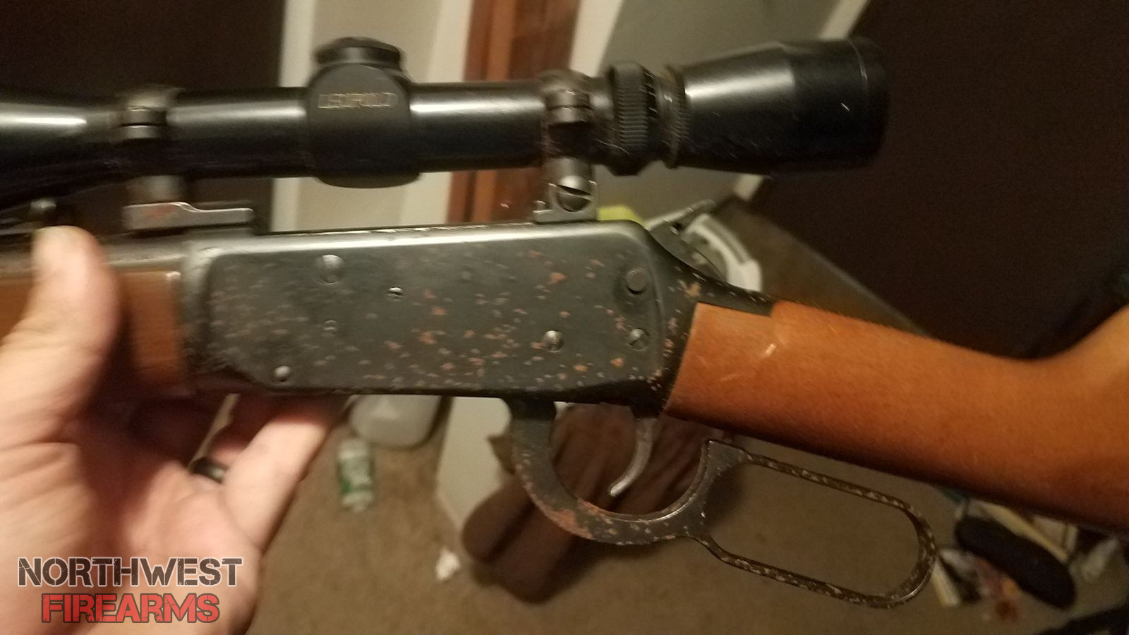

The gun came with a Leupold 3-9 x 40 scope attached - this is a neat Model 94 for me - the first Angle Ejecting Winchester I've gotten my hands on. My grand dad whom raised me had a pre-64 model 94 that he had mounted a scope on via a sideplate mount, and the scope was off-center to accomodate for the top ejection of spent rounds. That also allowed the use of the iron sights, if you wanted.
This gun requires removing the scope and bases to use the iron sight.

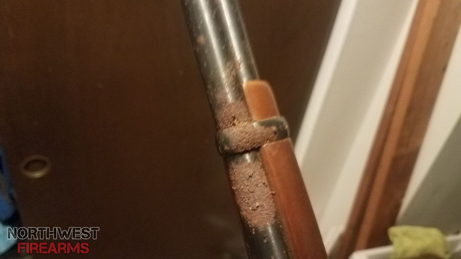

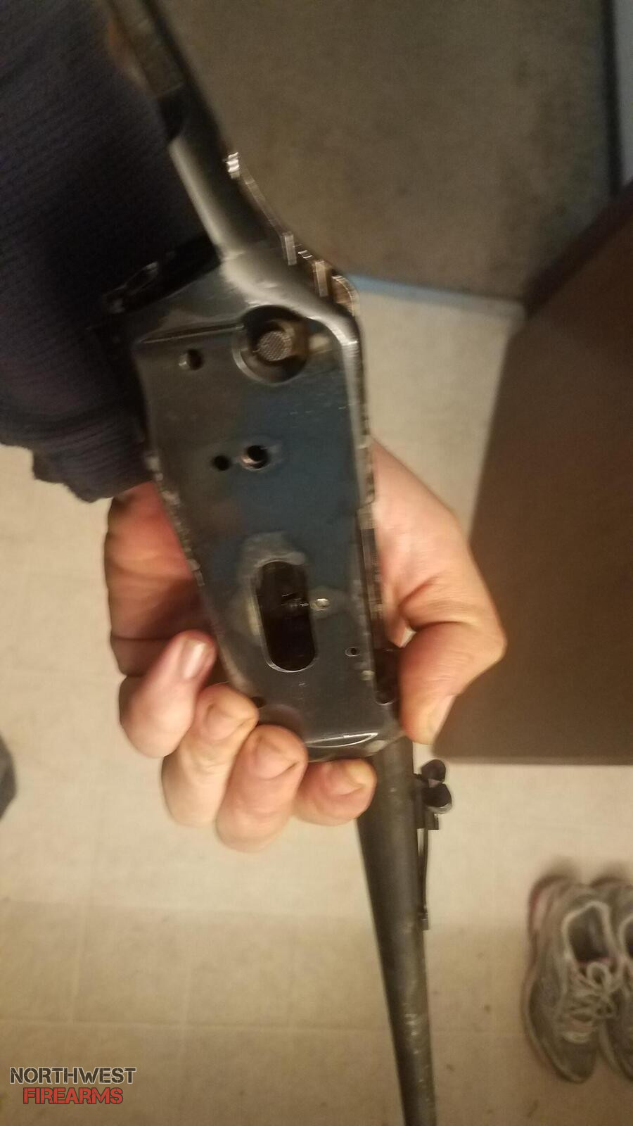

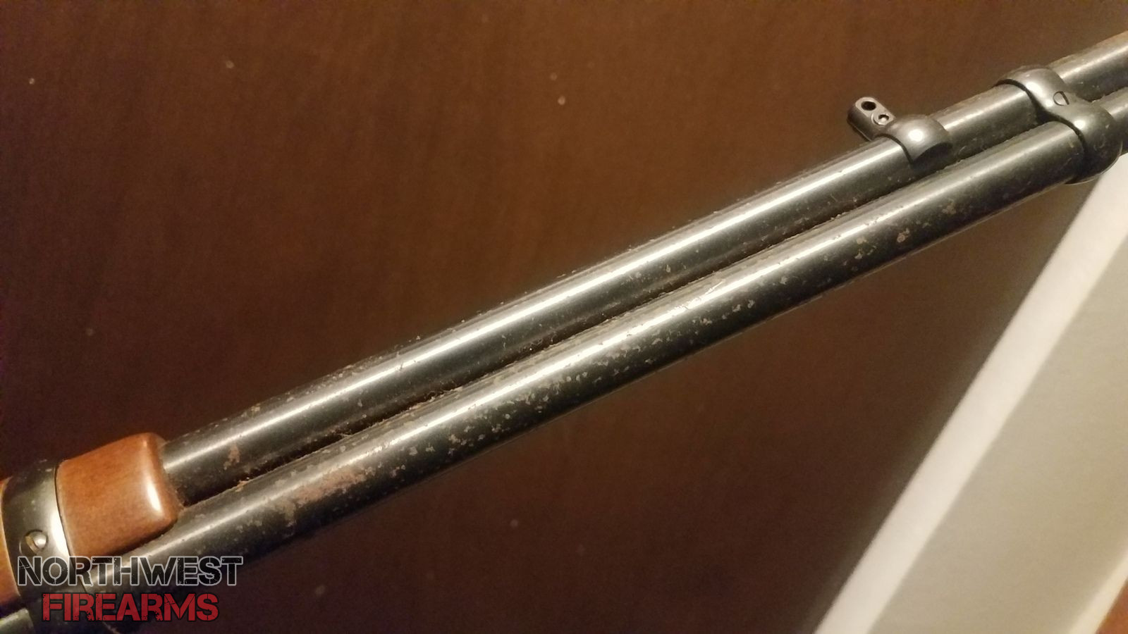

All the guns are in rough cosmetic condition - lots of surface rust, bad surface rust. They've not been cleaned or maintained in easily 10 years - ever since my brother in law died. After I ran my MIL home this evening, I got started right away cleaning up the rust so I could disassemble the guns and inspect the bores, bolts, and lock works. Pretty scary with the Winchester, as there was a couple really bad rust spots right at the barrel band. With some care I was able to get the wood off the gun and commence to scrubbing it. First thing I did was hit it with this weird purple degreaser / cleaner we had under the sink. This gun was kept in a stuffy room with little airflow, so in addition to the rust problem, there was a bit of a funk - mildew I think - hence my scrubby dub dub. After rinsing that cleaner off, which also loosened off a good bit of the flaky rust, I used white vinegar misted on with a spray bottle and a copper mesh scour pad after giving the vinegar a chance to do its thing. The bores also got hit with vinegar and then bore brushed. Repeated the mist & scrub, mist & scrub routine for a couple hours. Ran patches down the bore and got some really nasty gunk out. Checking the bore with a flash light (I don't have a bore scope) there didn't appear to be any major pitting, the bore itself was actually good looking after hitting with the patches, so I ran a couple oil soaked patches through it.

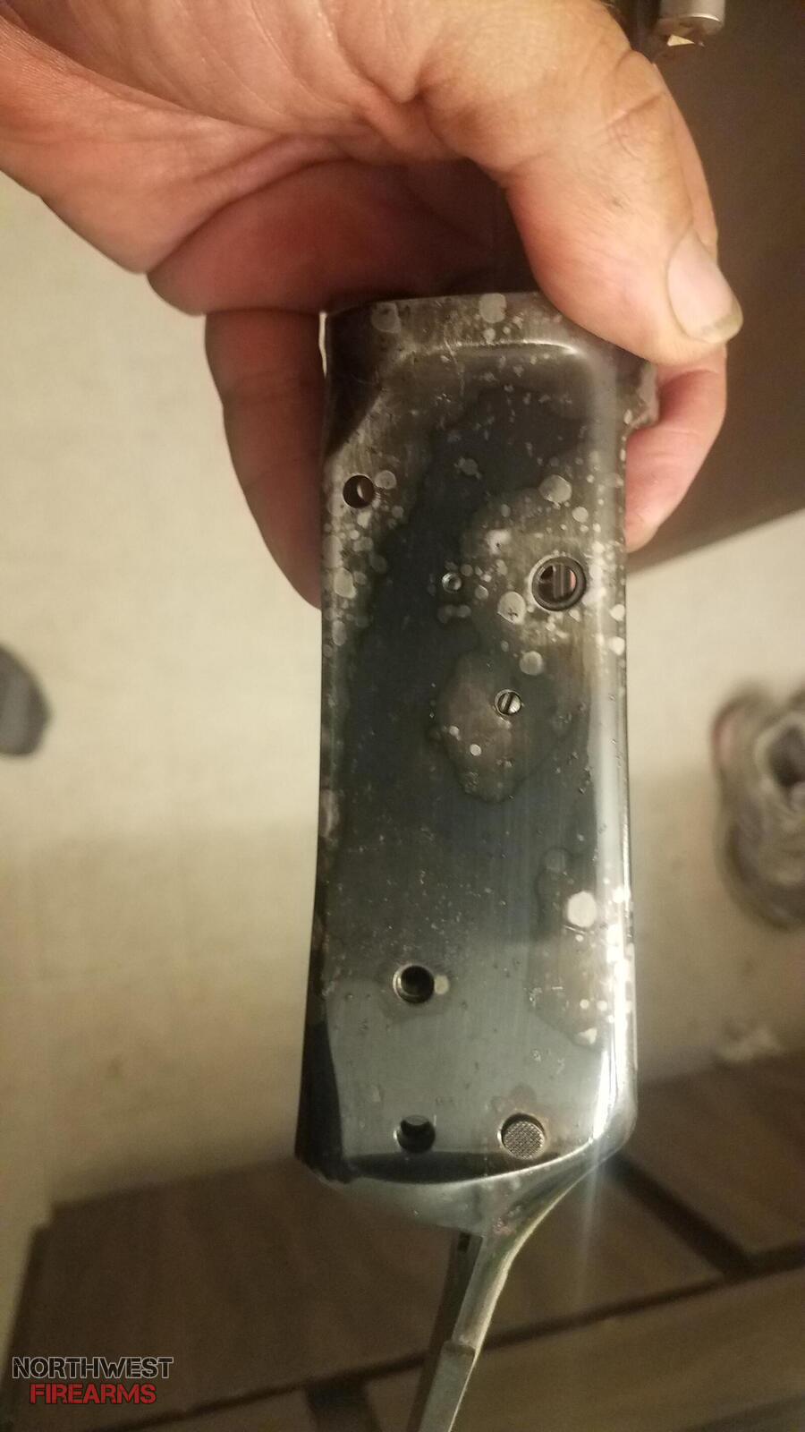

After getting off all of the rust I think I'm going to get off without mechanical aid, I rinsed all the parts off in hot water and gave them a coat of oil. The end result was surprisingly better than I expected, as I expected more pitting than what there is. There is not much finish left, but that was no surprise.
