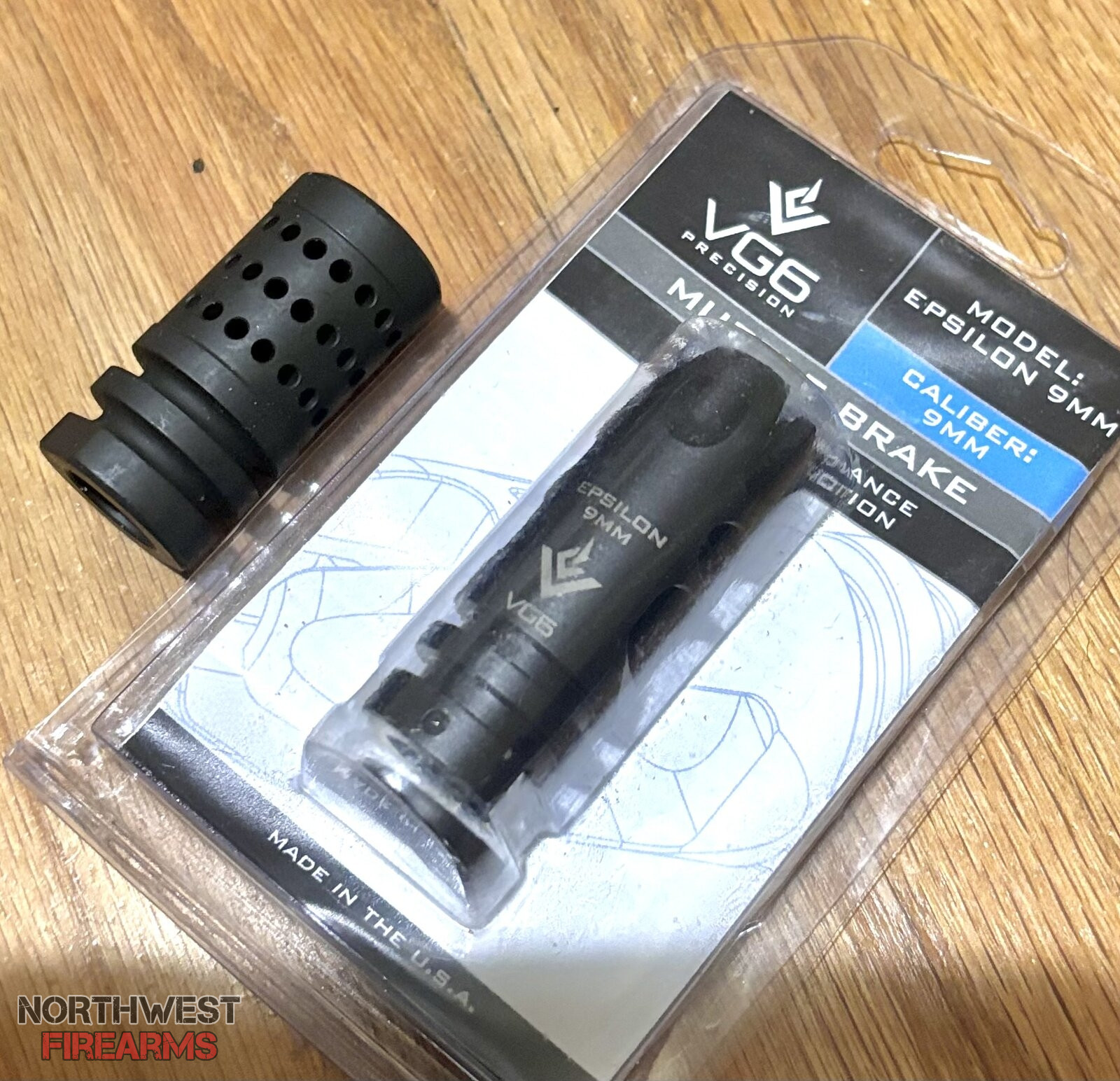

Found these 9mm compensators laying around and wondering if I can use them on my .357 sig Glock barrel. Some places list .357 as 002" larger bullet diameter while others list then both as .355". Anybody know? Thx!
I believe 357 sig uses .355 boolits. I would be more concerned about the threads though, that brake looks like it's meant for a PCC l have never seen a brake like that hanging off the barrel of a glock.

If you measure the thru hole on this break you will find ALOT more clearance than you seemingly expect.

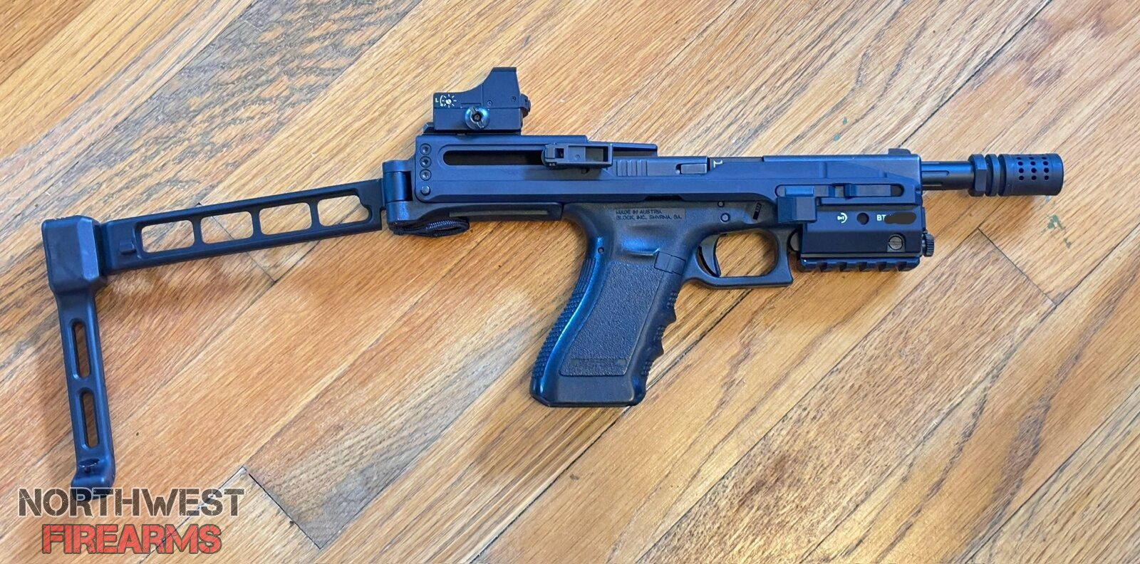

Not sure I understand this concern. Threads are outside of the slide. In this case even further from the slide due to 6" .357 sig barrel on a Glock .22.
As long as it's 1/2x28 threads and the barrel shoulder sits flush or proud of the comp, there will be no issue at all. The issue would be if the barrel shoulder has to fit inside the comp at which point the only thing that'll stop you is the ID/OD delta which could be fixed with a mill or lathe. I say go for it.
