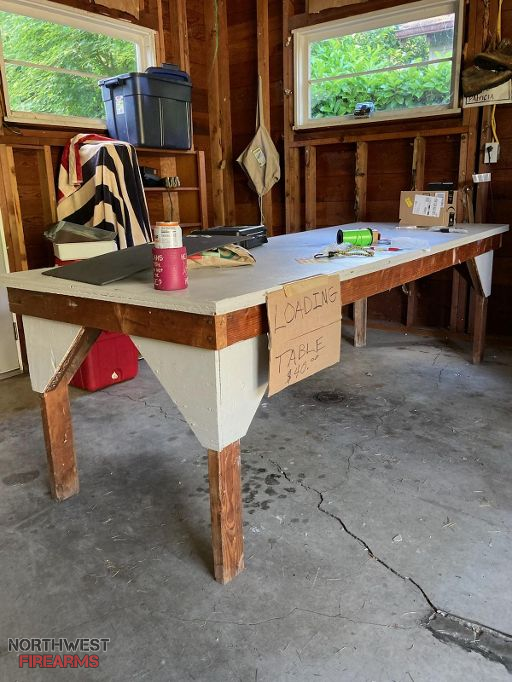

This table is 8" long, about 36"' wide and I'd say 30" high and 1 14" thick. Extremely solid, home made. I'm helping a friend with a moving sale this weekend and she's had the table in her garage for years. I would take this table in a heart beat! I have no where to put it though. :(

She's a beaut! And heavy! I would say there is room for 8"-10" shelves, or cubbies to sit at the back of the table and leave plenty of room for other equipment.

What is the top made of?

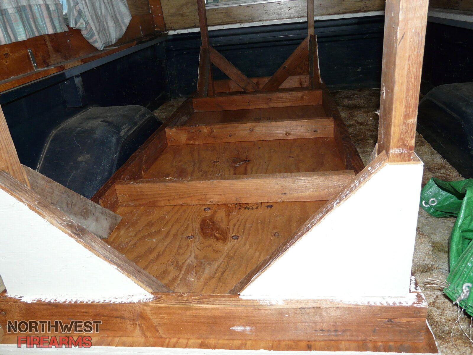

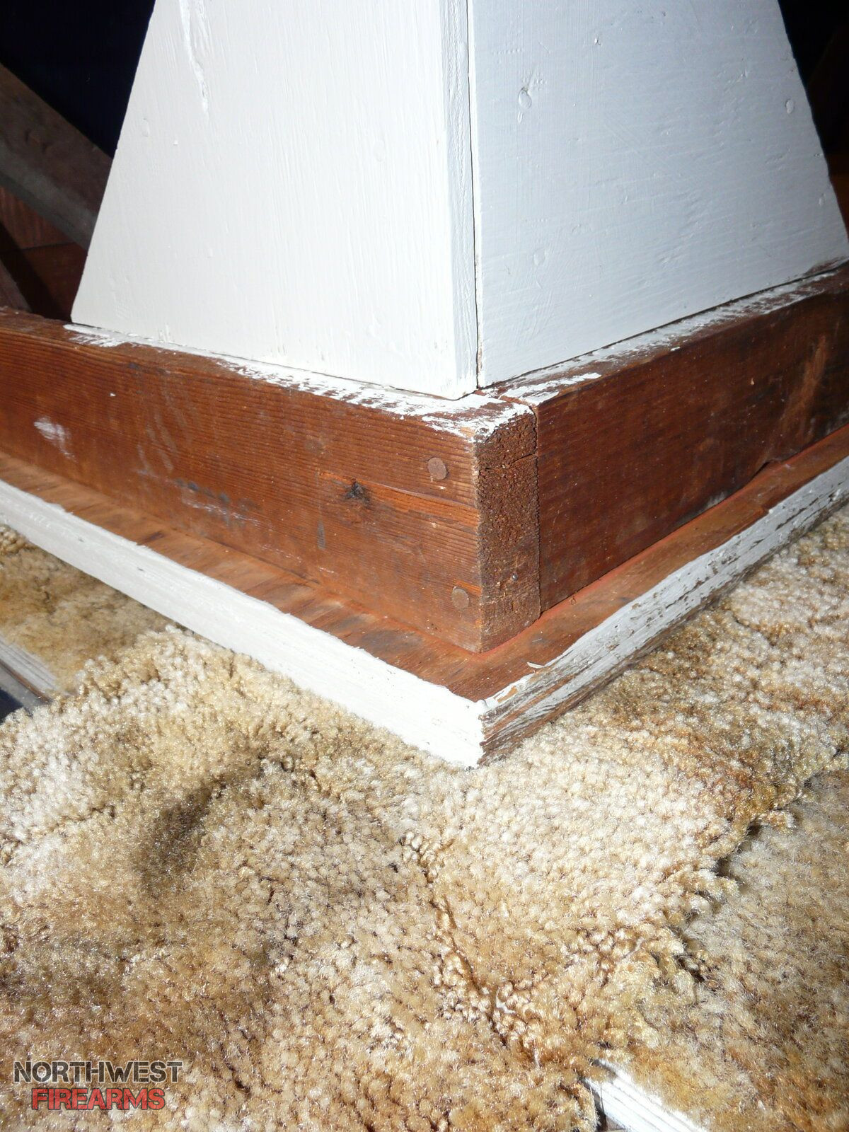

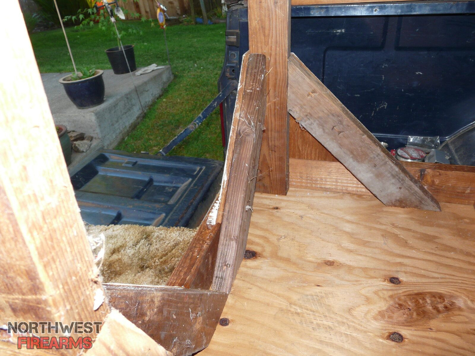

Table is 8' long, by 3' wide.
On closer inspection.....The top is two sheets of plywood. One piece 3/4" the other 1/2". The top must have been finished as it's smooth and has a good layer of paint on it. With no deep scratches or gouges. Everything else is 2" x4", with the leg braces of plywood. All nailed. I'd say someone that really knew their stuff put this together. (If it as me you'd see where I missed with the hammer, bent nails and straightened them out, or just beat them in anyway.) :D My boy (about 200#) and I sat up on this table and and tried to shake back and fourth, it didn't flex at all. If I were keeping this for a bench I'd probably go around and re-enforce with some screws.
Sorry I can't get better pics of this but I'm not able to get this out of the back of my truck, AND get it back in by myself.

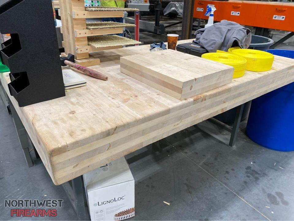

Getting ready to build my next loading bench. Found these tops 24"W X 96"L X 4.1" Thick.
Three 1.5" ruff-cut boards laminated together. I will be cutting a piece off the end 30", this will be ripped into 4 equal pieces for the legs (4 - 4X4) and the rest is the top. They sell for $125
Should last the rest of my life, however long that will be? Weighs over 100lbs.

Oh yeah, they make them 6.6" thick by 96" long for $150, to heavy for me
I call it my bench-top from hell.

Found it by sheer accident, on my wife's local Facebook Market Place. (they are good for something?)
Probably the best find in my loading career.
